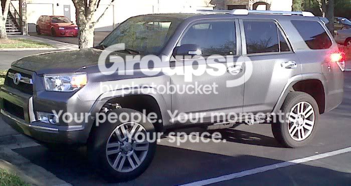

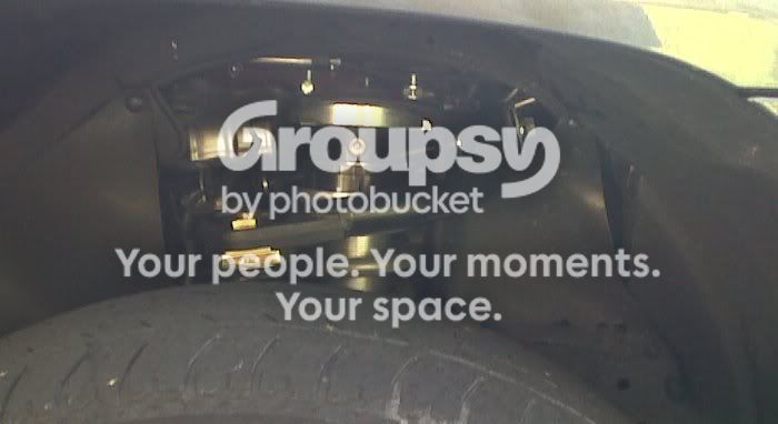

Took a couple of cell phone pics; have to figure out how to embed/attach them
Ok, a couple of poor quality cell pics:
Profile
PostLift.jpg~original
Top of CO & UCA
FrontCO.jpg~original
what the ....... No Pics!
what a tease, nice choice on the lift. Hope you fire out some pics and give a nice couple updates on thoughts of supposed lift ;)
Ha, had to go back and edit this as you threw up pics as i was sipping my beer and writing. thats a good start, thx
Loving the stance, even with the little oem mini donuts
Tires & wheels are the next on the list - trying to stay relatively even on the amount of debt so it will be in stages.

I would slide that camber adjuster all the way out. As Andries pointed out to me when the suspension is at full extension, as when wheeling, the uniball boot will rub the coil and eventually stuff will get in. I am going to adjust mine back out once I get my bumper and need to adjust the coils. Then I'll get everything re-aligned again.
