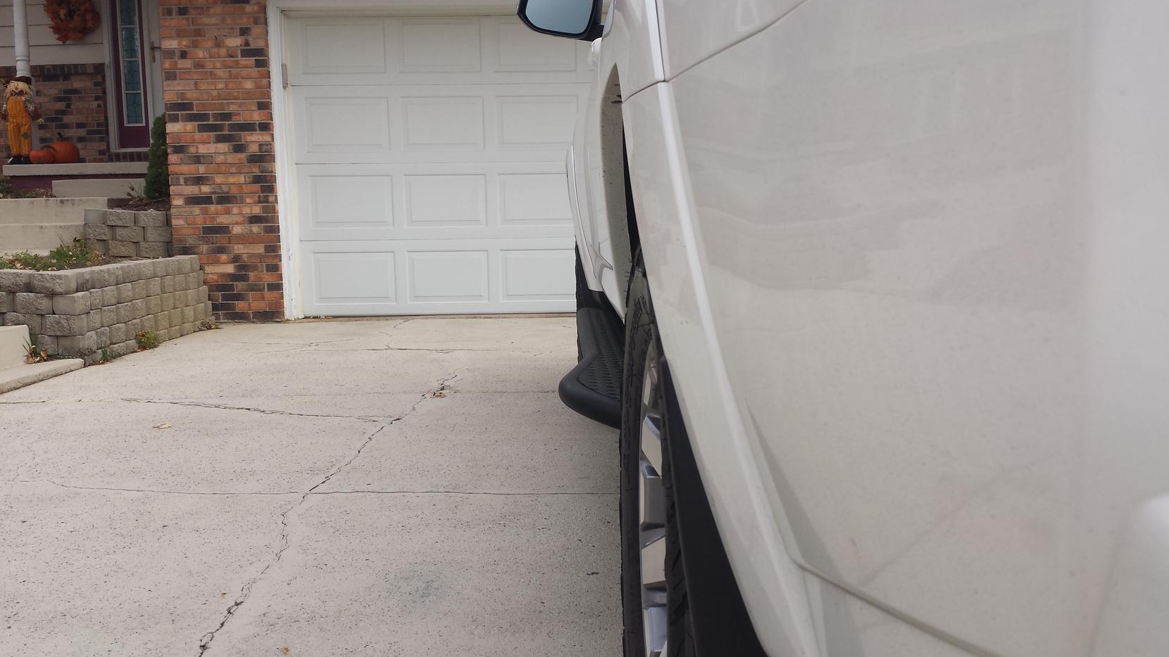

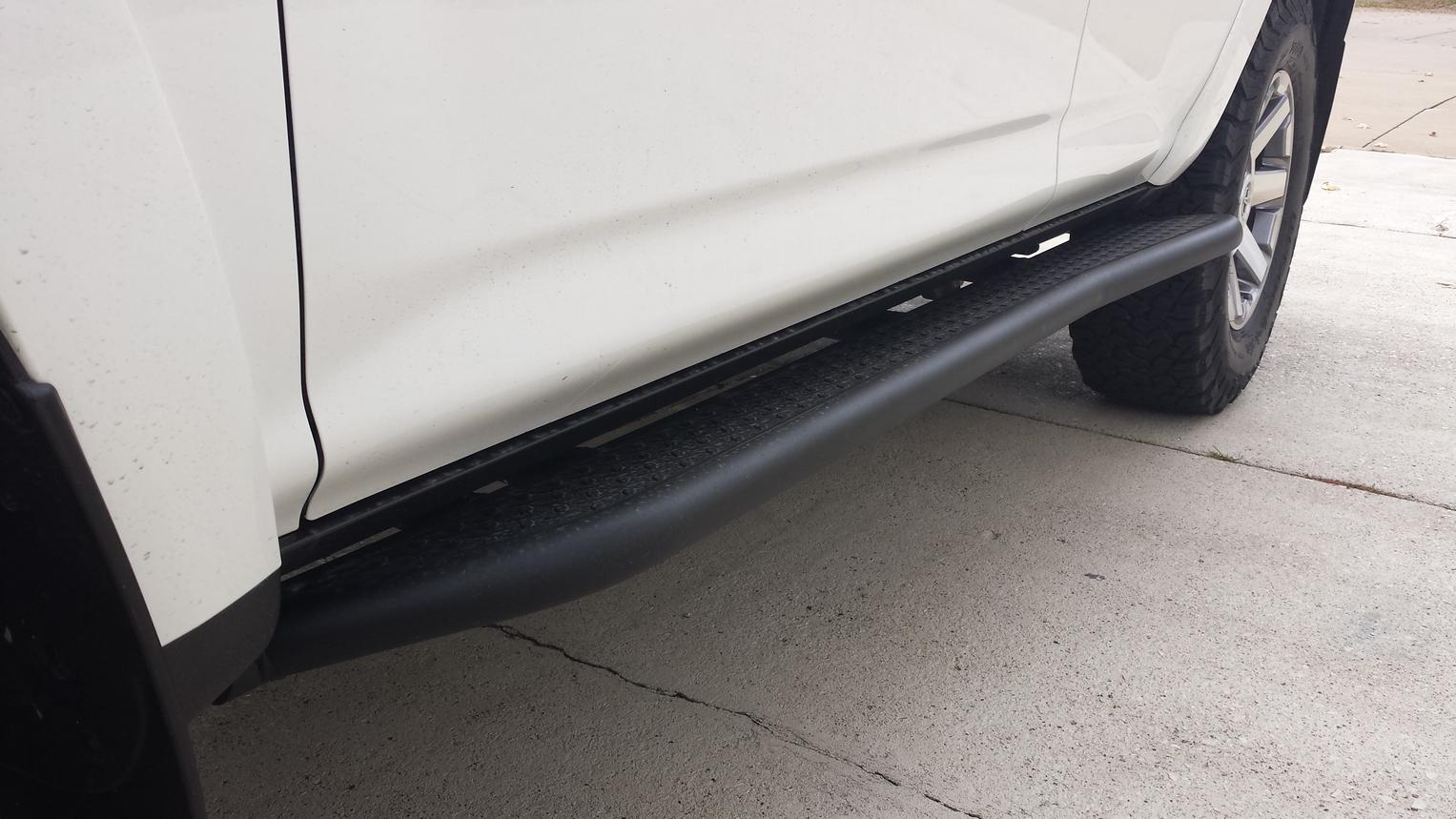

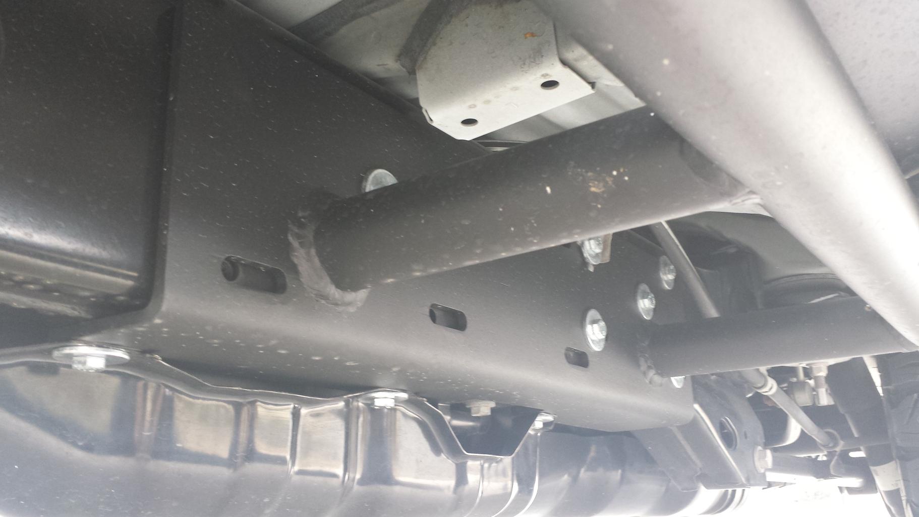

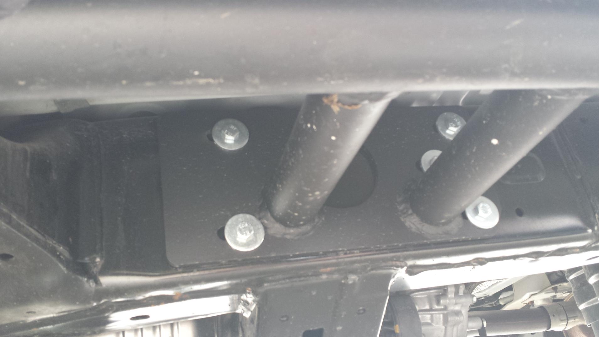

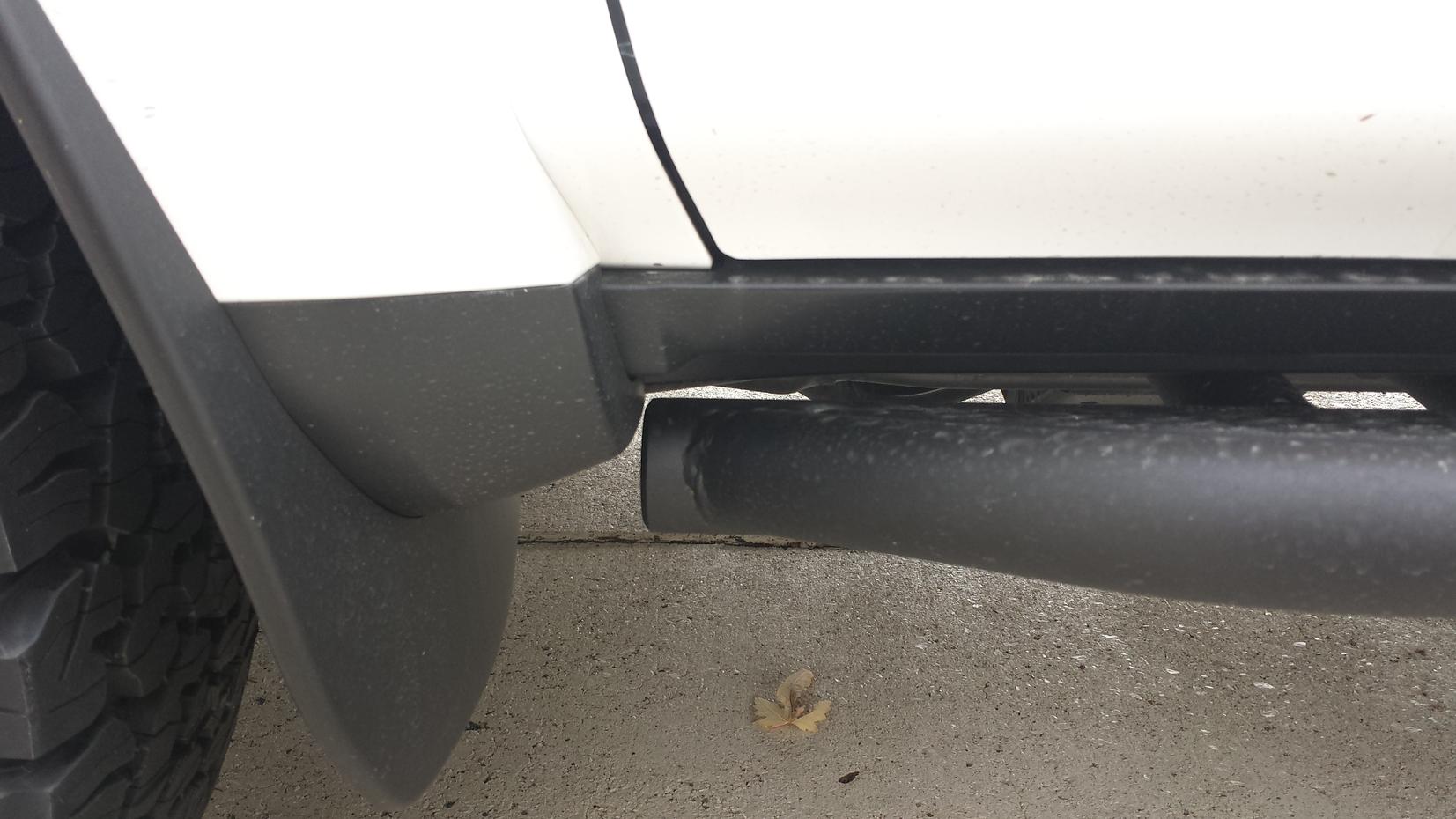

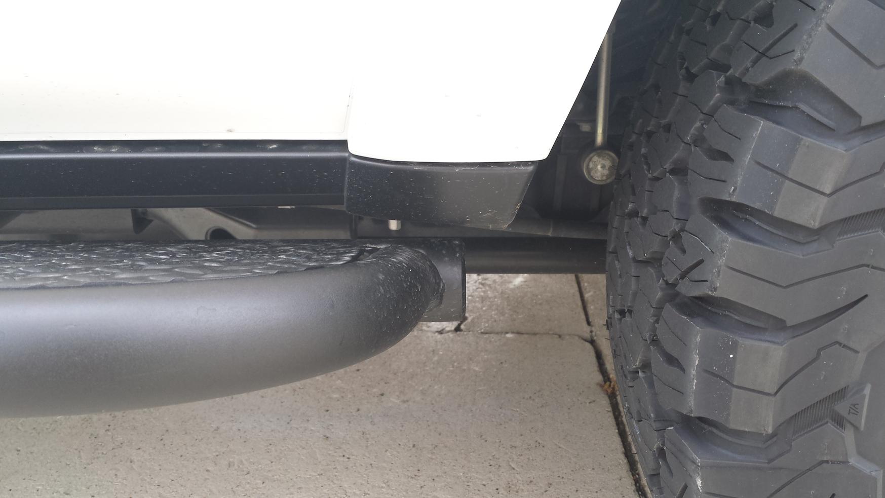

Sorry i saw this post last week and was going to reply sooner but better late than never. So here are some pics of my budbuilt beefy bumpout fulltread powdercoated sliders on my 14 TEP. I think these are all of the pics you were asking for plus some of how they mounted to the frame.

Great timing. My Budbuilts were delivered today. They are the same as yours but they aren't beefy. Thanks for the pictures. I'll be referring to them this weekend when I install the sliders.
