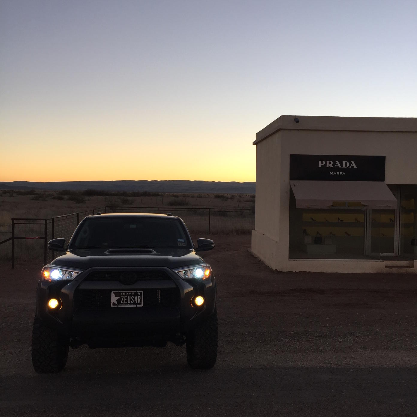

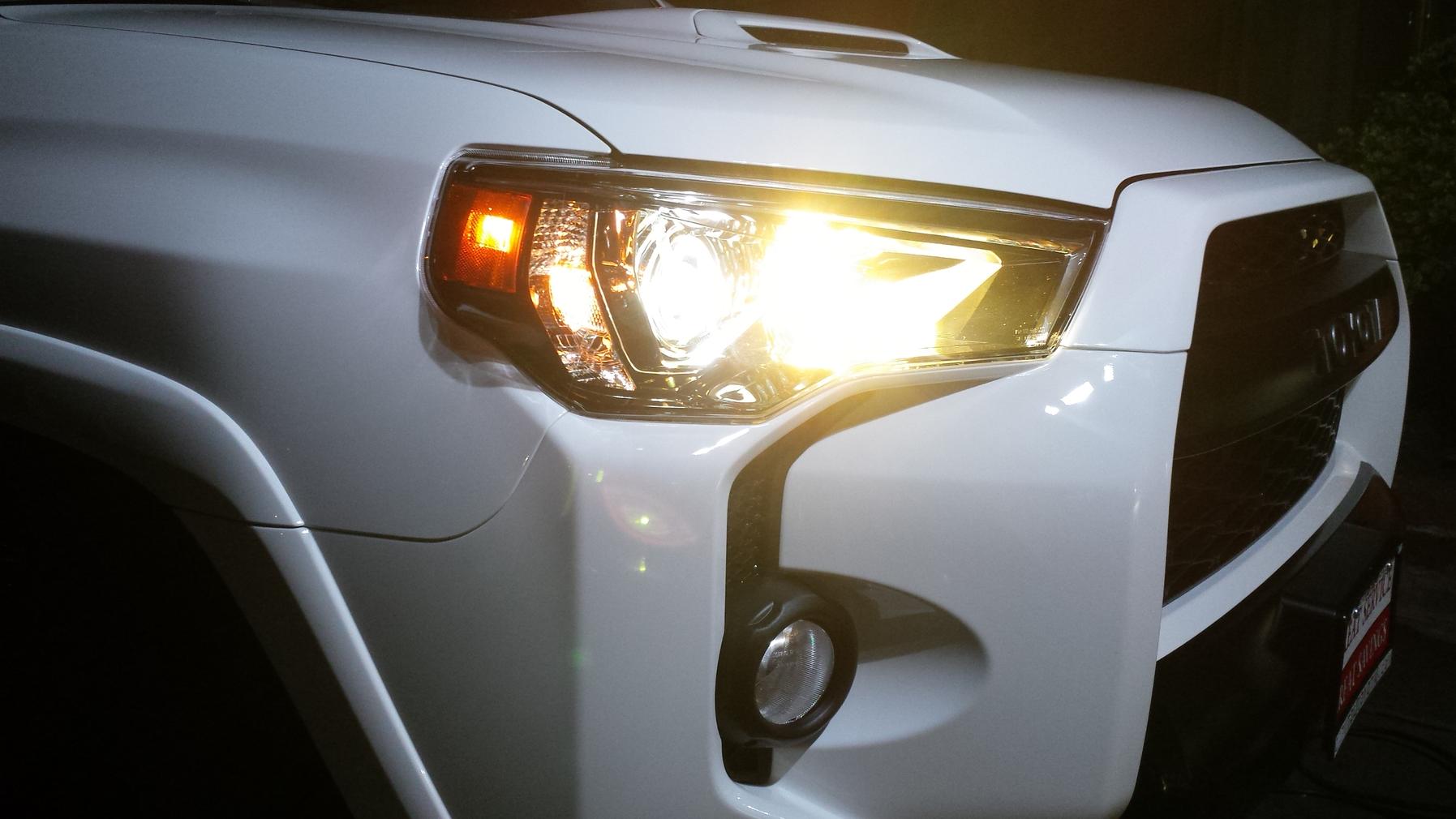

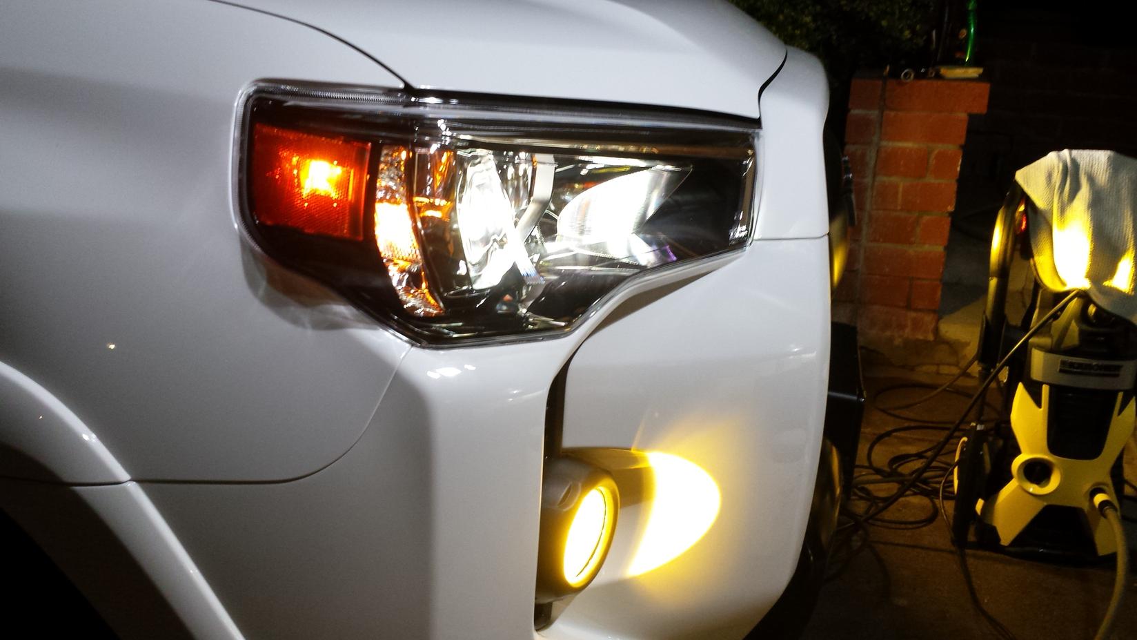

I don't have any output or cutoff pics currently but here's the Xenon Depot lows (4700k Philips bulbs)/DDM fogs (3000k bulbs)/Putco DRLs/high beams (75w).

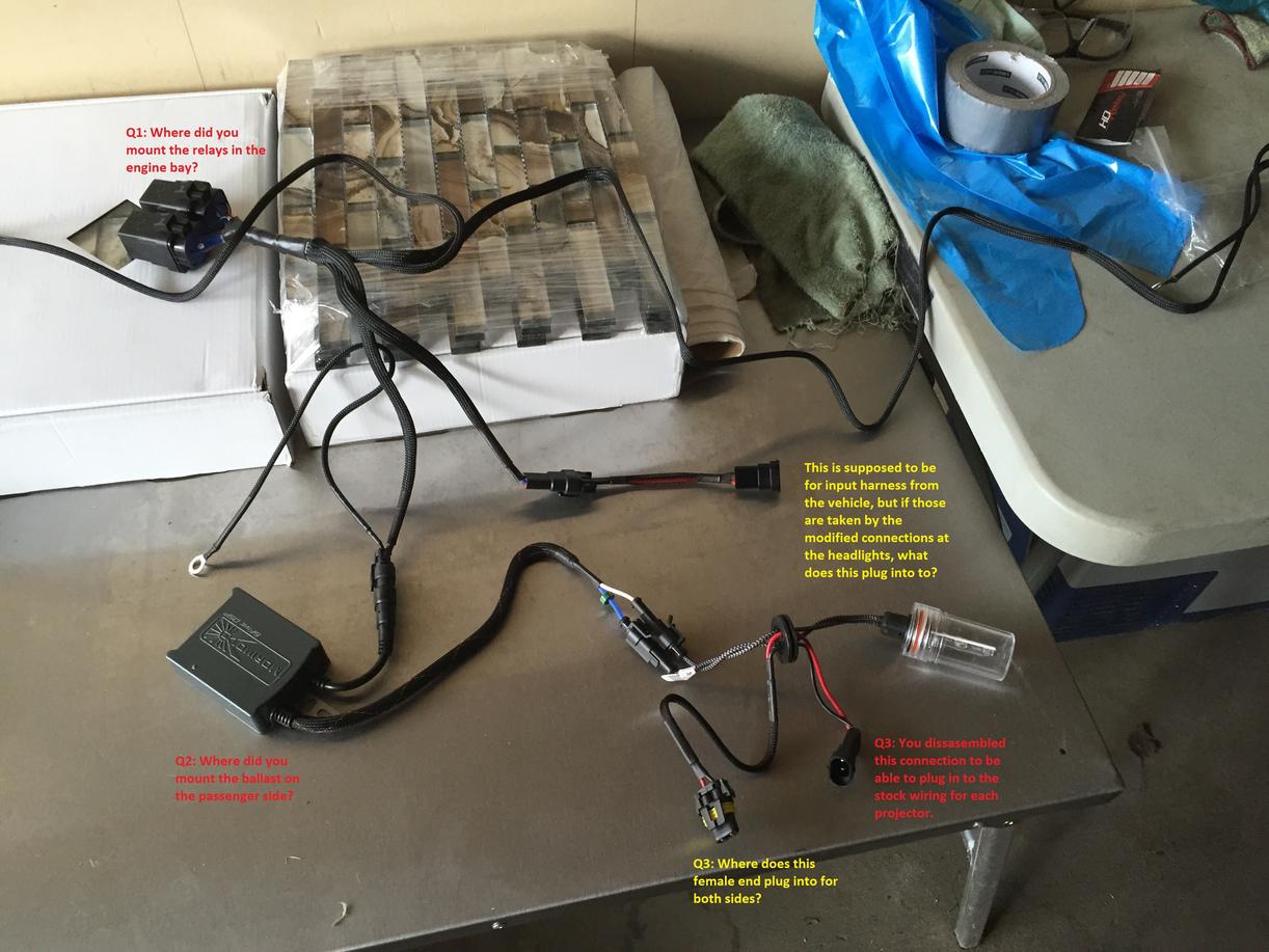

Ok people keep installing these, Im however not very smart and im stuck with my Morimoto install a little bit:
Can someone tell me where each end of the kit goes? Thank you:sadwave:

I have the TRS kit. Its great!
You will need to aim the headlights a little but you can get a VERY nice cutoff. I have never been flashed.
My only issue is if I leave the lights on Auto, sometimes (1 out of 25 times) the passenger side ballast won't fire so the headlight won't turn on. It seems to be something with the signal coming from the car telling the headlight to turn on. I say that because if I turn the headlights on from the stalk or I turn the car back on after shutting it off with the headlights on everything is fine.
I installed the 4300k bulbs with the relay harness. On the 2014 Limited the stock system wouldn't fire the ballasts without it. There is a nice long nut/bolt by the backs of the headlights. I mounted the ballasts to that on each light. I can't remember if I used the nut that was on the bolt or added another.
