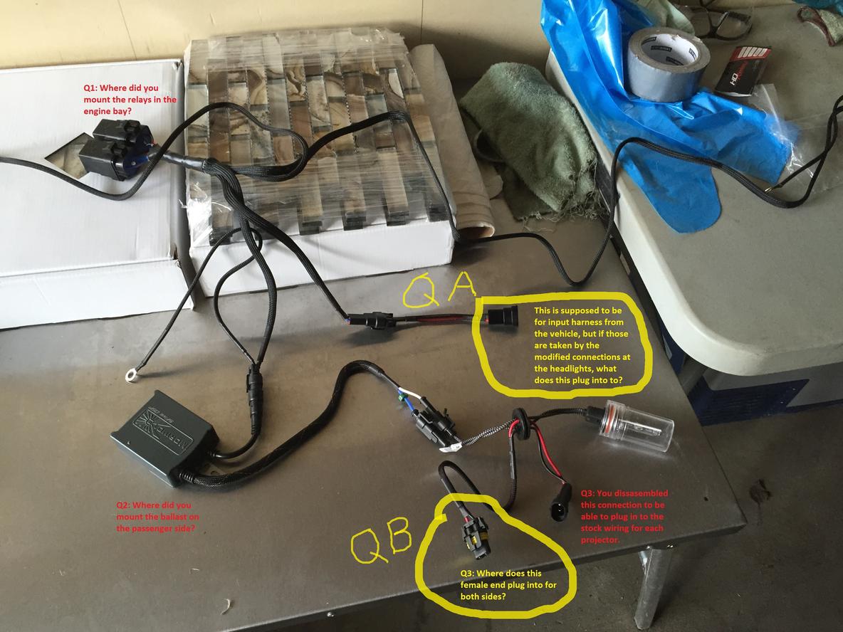

Ok people keep installing these, Im however not very smart and im stuck with my Morimoto install a little bit:
Can someone tell me where each end of the kit goes? Thank you:sadwave:

Q1 - Relay harness on mine was mounted in front of AIP on the cross bar that is covered by the plastic panel. "Wires are hidden underneath too
Q2 - Ballast were mounted to the sides of the engine bay closest to the headlight assembly " Left of AIP and Side of the Battery area"
Q3 - That plug will connect to your existing H11 in the headlight assembly to power the relay. It doesn't lock all the way when i did mine but a few zip ties did the trick to lock it up.
If you need pics, let me know!

Thank you for your help!!! I will get back to it in a ciuple of days. Can you please looks at Q.A and Q.B and clarify which one goes where? :bluejump::bluejump:

QB is a pass through for the stock h11 connector to the harness QA. Since the location of my harness was close, i removed the 9006 extension on QA and went straight to QB.
The 2nd bulb will have a connection similar to the other one. That will not be used and can be disassembled and pulled out for spare parts as only one stock connection is needed to power the relay switch.
