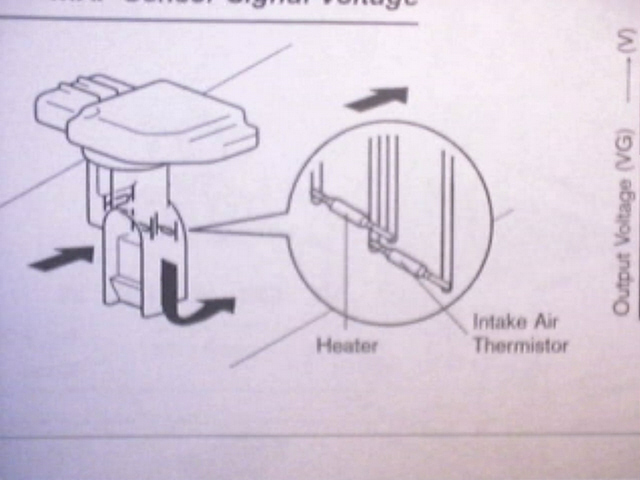

I guess I had it backwards then. But, if I just clean the dirty bulb, the code will go away. And, I associate a thermistor with temperature...
Sorry this picture is so crappy, but it's a million years old and a screengrab I believe. But, as you can see, it illustrates the Intake Air Thermistor in our MAF. That's probably the source of my confusion.
It's all good. Besides, with a steady hand a lots of care you can do some things that are not supposed to be done.
For example, you'll search all over the forums that our idle speed cannot be adjusted and it controlled by only the ECU. Well, I adjusted my idle and all it takes is a little time and patience. Though once the factory paint mark is gone I was on my own if I could ever get it back to the way it was.
Point is, you're doing maintenance on your rig and learning along the way. Nothing wrong with that at all. The MAF is only about $50 if it gets totally screwed up anyway.
