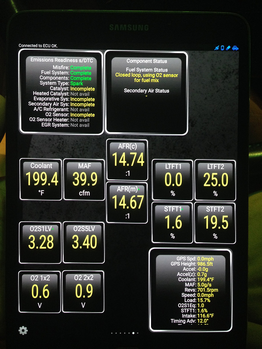

Still haven't had a chance to smoke test the car. I did however hook up a friends obd2 scanner with the torque pro app. Noticed the short term fuel trim was very high on bank 2 once the car started running rough. So something is still amiss... i'm now leaning toward intake gasket or exhaust leak? Any ideas? or anything else that i could be looking for in that app that would help me narrow it down?

last night I hooked up an OBD2 scanner with an android app called Torque Pro... i'm not super familiar with how to use it but at least verified that the car is dumping fuel on the bank 2 from detecting something happening... i will attach some photos below...

While car was warming up but didn't feel the "miss" yet...
After car was warmed up and the "miss was present"
