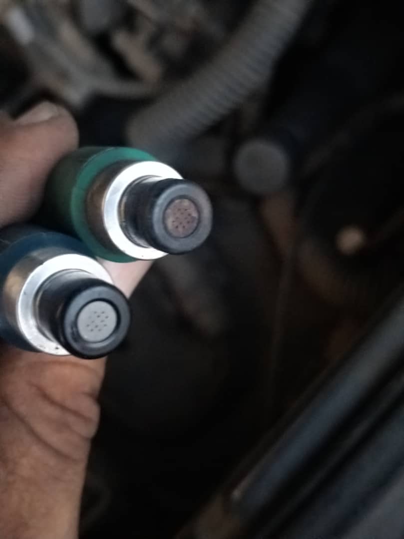

so i went on a 340 mile round trip over the weekend, and midway through the trip, the car struggled to accelerate past 45mph, a scan show an additional p0171, in addition to the existing p0174 and intermittent p0430. I had previously chnanged the downstream bank 2 O2 sensor, and CEL remained
I had already bought 6 remanned injectors from ebay, installed them yesterday, and all my lean codes & error codes are gone. my fuel trims are now normal, less than 2%, and am super stoked.
replacing the injectors, took me about 4hrs, cos of some stubborn fasteners, and i had to go out to buy 8mm allen key.
subsequent swaps shud take an hour or 90mins tops.

Awesome news earthrealm! If you don't mind to report back, let me know how your rig is still doing. I don't drive mine much anymore due to having a work provided vehicle, but i had the problem again yesterday when driving it for the first time in a while. Driving along and it felt like the truck didn't want to accelerate and was running really rough. Plugged up the scanner and loaded up torque pro and it was dumping fuel again. Its got to be something like an intermittently sticking injector... just was leery of the ebay denso ones...
