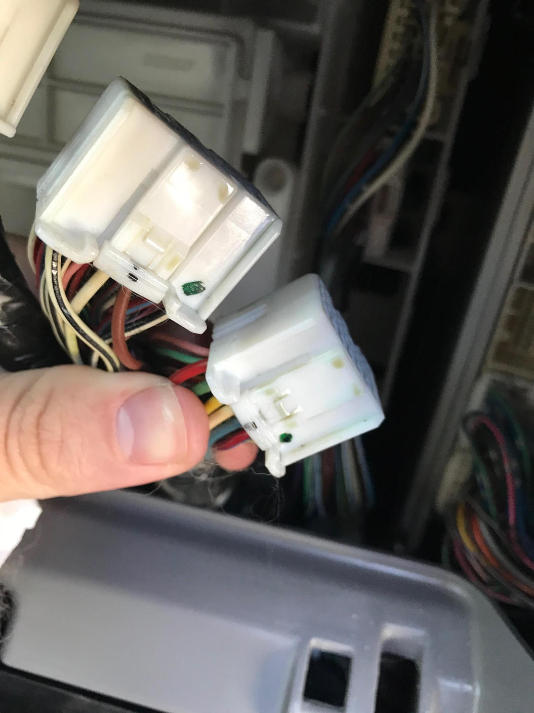

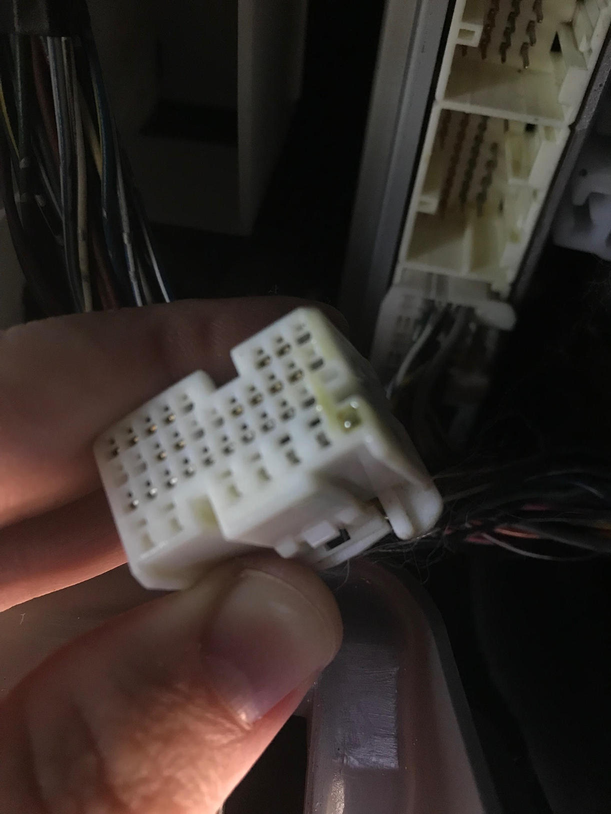

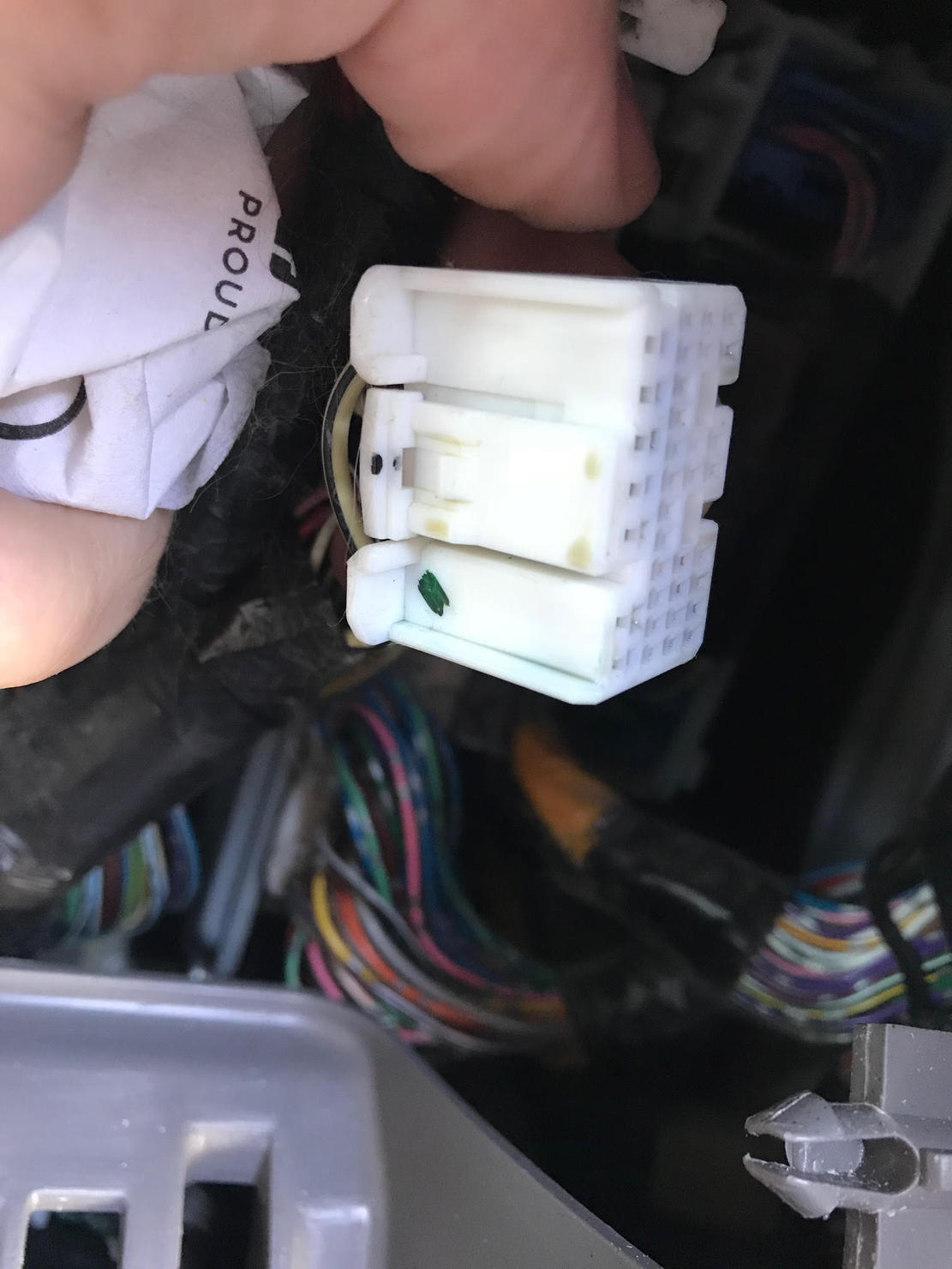

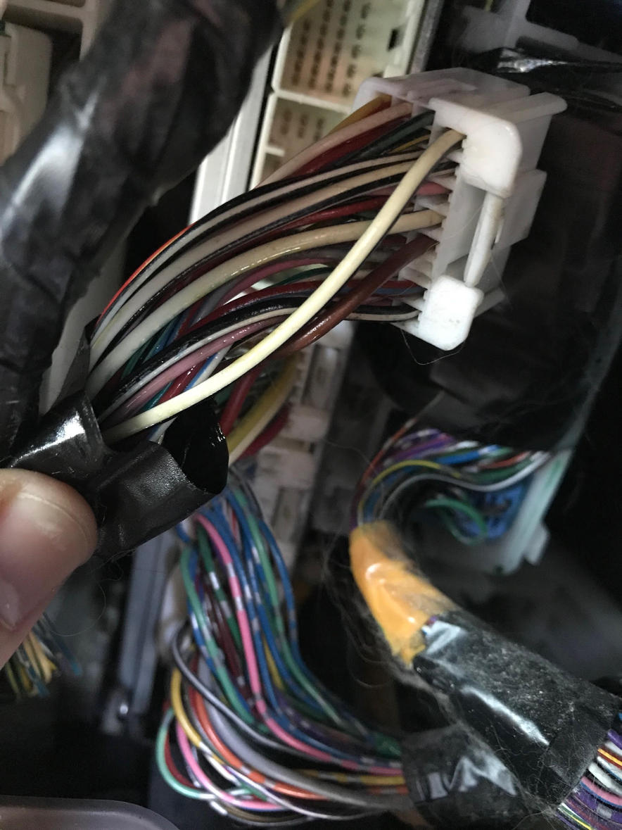

Check out this thread http://www.toyota-4runner.org/4th-gen-t4rs/173760-oil-wicking-up-my-o2-sensor-wire-harness.html
That appears to be my issue, as my harness at the ecm has oil in the connector.
Very interesting find dta1984! Just for curiosity sake, I just went out and dropped my glove compartment and pulled those same connectors. Mine are also covered in a light slightly brown oil. Some of my cables on the second connector down from the top also seem to have the oil on them as well..
Please keep me posted on your findings. Mine are not as covered as yours are (attaching photos below), but this may be the root of all the issues causing it to run lean/rich and burning up my o2/air fuel sensors and replacing them just masking the underlying issue here...

Come to think of it, The last time that i replaced my passenger A/F sensor, the connector did have an oily substance in it as well. I assumed it was dielectric grease that may have become hot and melted into more of a liquid, so i didn't put it back into the connection this time. I will have to pull that connector and see if it has this fluid in it again.
Will do! You've definitely got a little oil in your connectors as well. I'd be curious how your downstream 02 connectors look. I remember one of mine was definitely covered in oil. For some reason didn't think nothing of it at the time....thought maybe it wasn't seated well.
Right as I was typing that haha. Interesting...
