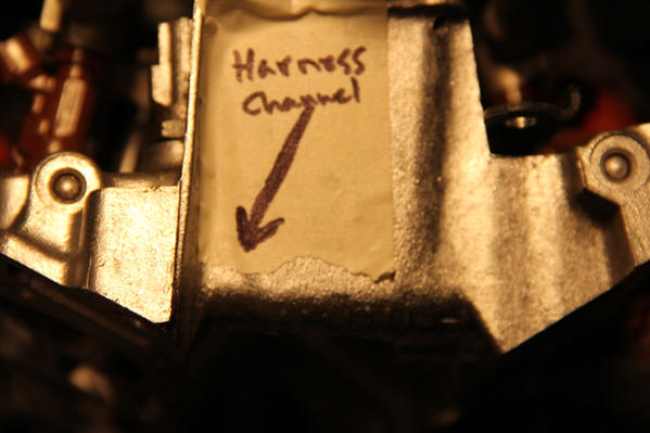

Take a ton of pics for reference, tape up ALL possible holes, and like [MENTION=127012]4Runnermex[/MENTION] said there's a very small channel for the sub harness to run through under the manifold. DON'T pinch your harness after it's all together. Felpro gaskets go on dry. Sensors and harness go in dry. Don't use dielecrtic grease. Sensor torque 29ft lbs.

Also, included a photo of the shallow wiring harness channel.
