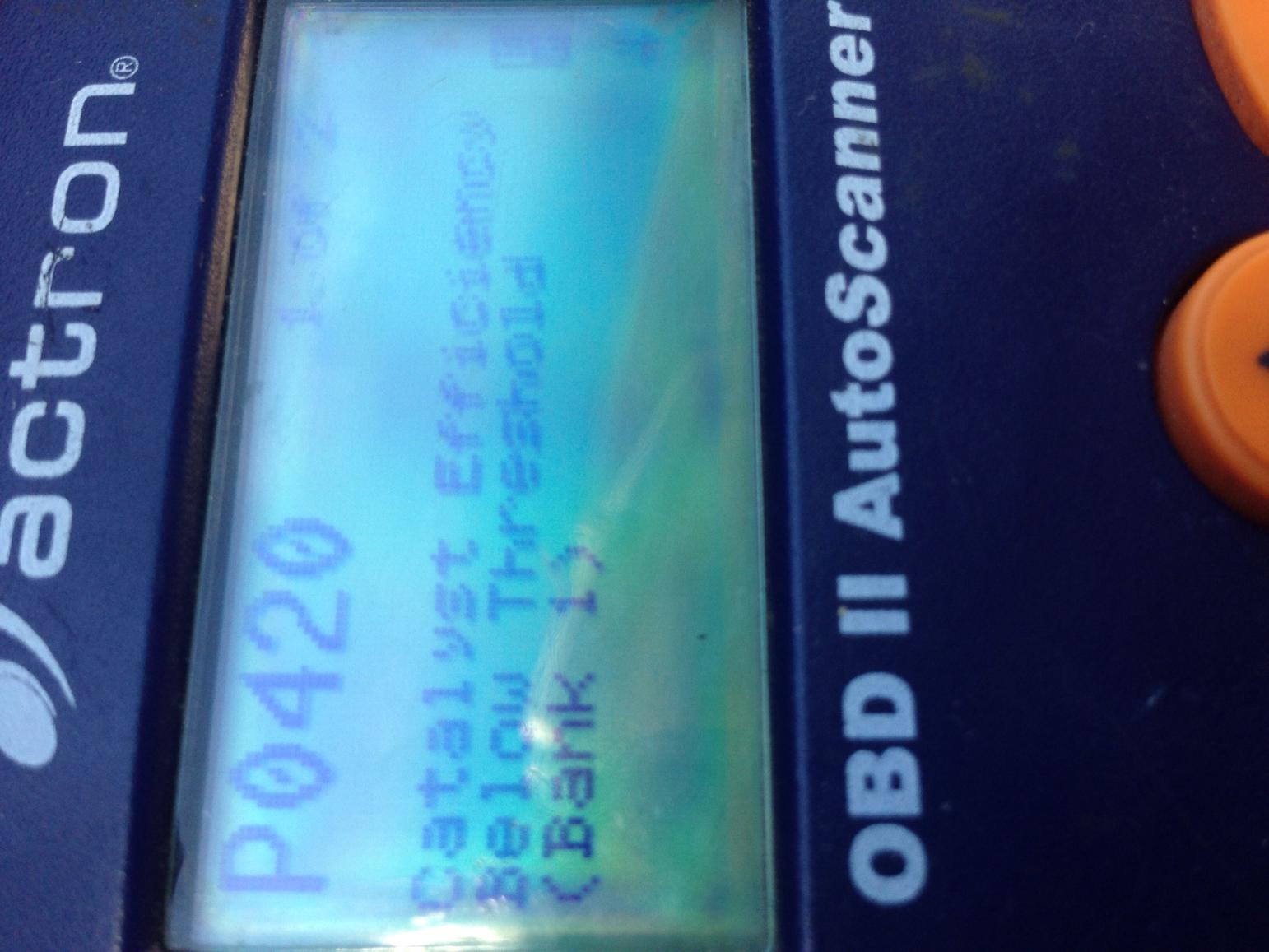

I drove to Lonepine to get it checked. I just got a P0420. From what I understand, it's an O2 sensor dealing with the catalytic converter. "Catalyst Efficiency below threshold (bank 1)"
Considering I took it four wheeling for the first time ever, and put it in the worst dust I've ever seen in my life, I'm hoping this is somehow a culprit. Also, using gas that had been in considerable heat, and the gas can potentially had some impurities. I may have also got a little bit of dust in the tank when I was refueling out there. I checked the fuel cap, it's on but there's some dust in that compartment.
The guy at Napa (the one who let me borrow the reader) told me to just clear the code, drive it around and see if it comes back on. I'm about to do all of that after I post this.

clear it, (this can also be dont by pulling the EFI fuse under the hood for 1 min) drive it, see if it comes back (may, may not.) if it does replace the sensor. you wont have any problems right now except lower fuel millage, then the motor might start running rough.

Anyway, I had the same code on my 3.4 and somehow a new (used) MAF fixed it. I was cleaning my old one regularly to get the engine light off but it kept coming back -- usually when going up steep hills and really making the engine work.
I found a used MAF off a 08~ Toyota, popped it in and no check engine light in 1000+ miles even up steep hills.
As far as driving it with that code, its not a problem at all.
i had the same thing a few weeks ago....ran some sea foam in the gass and did a sea foam smoke out and cleared the code....running fine for me cleared the code no problems....its just a dirty cat converter...

I cleared the code and drove it 50 miles... half of that uphill. I floored it several times, took it up to 95... It sounded great. The engine was running smooth, even after stressing the hell out of it. No warning light. Right before, I thoroughly wiped up the gas cap area with a damp cloth. I cleaned the cap, the rubber around it, the metal post that the door clicks into.
I have no real evidence to support this... But I just have this feeling that it had something to do with the stress I put it under a few days ago. I was going uphill on 4x4 roads from about 2,000 ft to 7,500ft altitude into the mountains... Maybe the exhaust got a little dirty from those added stresses? Sounds like the MAF could have been dirty?
Either way, I feel confident to continue on the trip.

So i'm guessing your VSC lights went on also? Per the beloved FSM for 96-02s p0420's are caused by one or more of these: 1) Gas leakage on exhaust system, 2)  A/F sensor (bank 1 sensor 1), 3)  Heated oxygen sensor (bank 1 sensor 2) or finally the  Three-way catalytic converter. Check 'em in that order as they get more expensive as you work your way down. Luck! :banana:
i have had this code for approx 1 year (only owned the runner for that amount of time). i changed both O2 sensors, ratted out muffler and exhaust gasket with no luck. i can clear the code and 2 to 3 weeks later it comes back. its one of the those codes that doesnt mean awhole lot if your runner is still running decent. its more of an annoyance. if you do in fact want to replace O2 sensors only go with denso. find them on here: Oxygen / AFR Sensors - Underdog Racing Development first. i would have an exhaust shop check for leaks in the system also or even before replacing parts. good luck to you. many 4runners will have this code and who knows the original owner could have had it pop up a time or two.
Just clear the code and keep driving.
This. There is no affect on performance or MPG from a stand-alone P0420. It is an over-sensitive indicator that you MIGHT be polluting the atmosphere more than the optimally functioning vehicle. Nothing to affect a trip.
