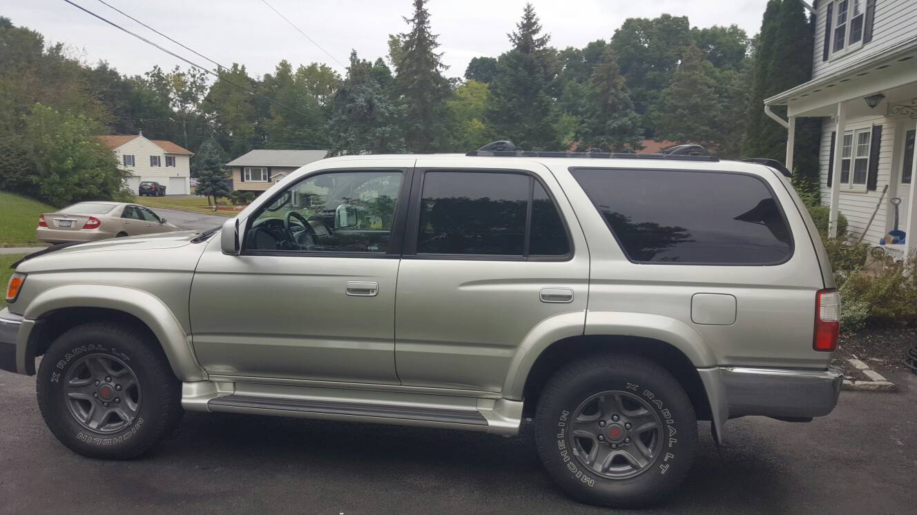

Thanks in advance. Also painted my wheels with some duplicolor graphite and red toyota symbols.

On your 4Runner, do you have 1 or 2 catalytic converters?
