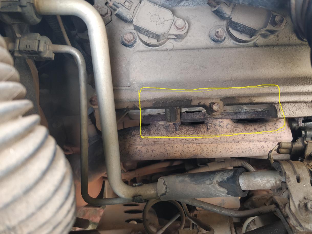

so the mechanic said the leak is from the exhaust manifold, that the gasket there is bad, and needs to be replaced/
you have any idea of a leak occuring there, how difficult is the ops, and anything special i should be aware of?
am certain the bolts would be rusted, and probablly break during removal..is this an issue?..is there stuff i need to buy before starting the ops.
Yeah those bolts look nasty... Well the best you can hope for is if they do break they leave you enough meat to use a stud remove to get them out of the head.
If I recall the V6 isn't as bad as the V8 for replacing the manifold gasket (you may want to check the manifold for cracks/holes while it's off. It's just going to come down to the rusty/seized bolts. You can try getting the engine nice and hot and soaking the bolts in PB Blaser or Rust Penetrant and letting it cool off while soaked before doing the job?
