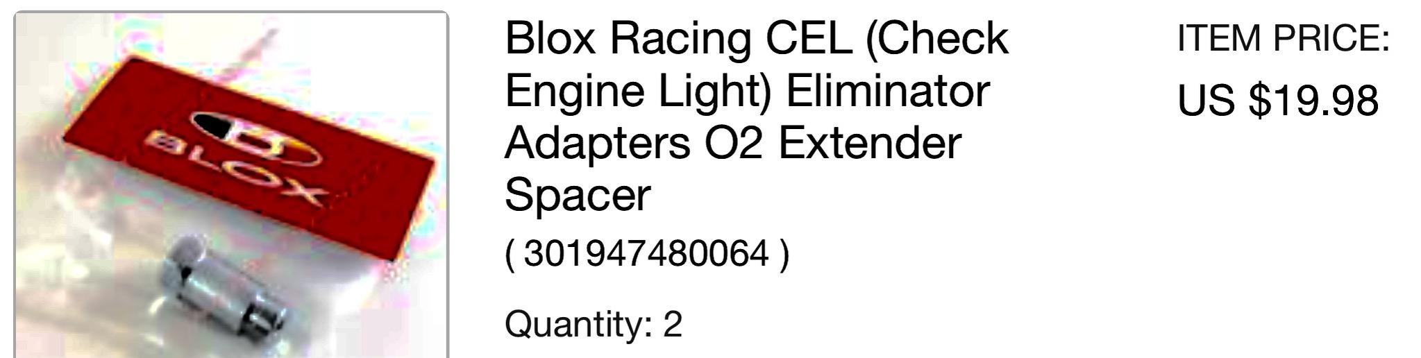

Here's what I purchased for those interested ...hope this helps someone.
Alias name and member account not needed
This was for 2 of them so $10 bucks each on eBay and the seller was sabersport I recieved them in 2 days. Good luck
Also ..No modification required with these just pop them right on.
