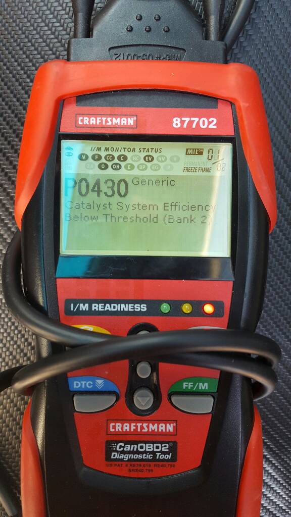

P0430
natevans65
Is bank 2 driver or passenger and does this reading mean upper or lower sensor, assuming lower?
Sent from my SM-G920V using Tapatalk
It means that one or both Catalysts on Bank 2 failed the catalyst efficiency test. Whether or not that means one or both catalysts need to be replaced and/or the sensors is the tricky part.
How many miles are we talking here? If it's like 100k I'd be a bit on the fence about the catalyst being bad, if it's closer to 200k I'd be more likely to condemn the cat.
the 430 code means that the passenger side cat is not working properly.the cat reacts to the PCM as it controls the fuel to air ratio. if the cat does not respond properly, the downstream O2 sensor will mimic the upstream O2 sensor output voltage ,then the code will throw.
to check if the sensor is bad swap downstream sensors if code does not change then its the cat.
then start engine cold. crawl under vehicle put a hand on each converter they should both heat up the same . the one that is colder is the bad cat.
high miles on engine 150k PLUS , NOT all that uncommon. using a scan tool check the fuel trims before cat replacing . could be a problem with the engine not properly burning fuel or excessive oil use or even coolant burning ..vacuum leaks will cause / trick out the PCM to dump too much fuel into the engine.
227K on the original CATS, I did go out and disconnect the battery for an hour last night, ran the truck for about 1 hour on an errand this morning and it did not come back. Keeping fingers crossed it does not come back. The good news is that I have 1 full year until I have to go to the Virginia inspection station again!

Sounds like a borderline cat to me... It takes a bit of driving for the catalyst test to run, but it may or may not pass the next time and fail the time after that. At 227k I'd say that it's probably the catalyst on it's way out and it will probably start failing more frequently as time goes on.

In my experience I think the very strict operating conditions and typically lean biased operating conditions of most modern cars eventually just burns the cats out. 200~300k is probably not a bad lifespan for them these days to be honest.
Spacers might work? But realistically it'll probably just cause more issues down the line as the vehicle won't be controlling fuel trim accurately at that point.
OK...going to start with the 02 sensors as they are pretty inexpensive (at least on RockAuto- $40 each). So am reading this correctly that this is on the passenger side (bank 2) or is bank 2 driver side? I will replace the down stream first and then if that works-great. If not...will go with the upstream next. The CATS themselves are around $250 so that is the most expensive cost that I can see on this mini project. Already did PVC 6 months ago, plugs this past Christmas, Air filter is clean (K&N-CAI) and is clean. I have the special spray to hit up the MAF sensor if its dirty. So with 227K I understand i am at the point and time where things start to go and I am OK with that, I plan to keep old faithful running for a while. So....is bank 2 Driver or Passenger side? Thank you!
my post #3 : start engine cold. crawl under vehicle put a hand on each converter they should both heat up the same . the one that is colder is the bad cat.
also swap downstream O2 sensors if the same code returns it is the pass side converter.
before replacing a converter make sure the fuel trims are less than 15. normal is less than 10.. zero is perfect. I doubt zero..
It's been off for about a week now, no check engine or VSC lights. When I did crawl under there I shuddered at all the rust, I do have a magnaflow cat back system so that section is in good shape. Forward of that is pretty rusted up as that section forward is OEM with now 228k on it. Guess that is part of owning an older truck.
Sent from my SM-T530NU using Tapatalk

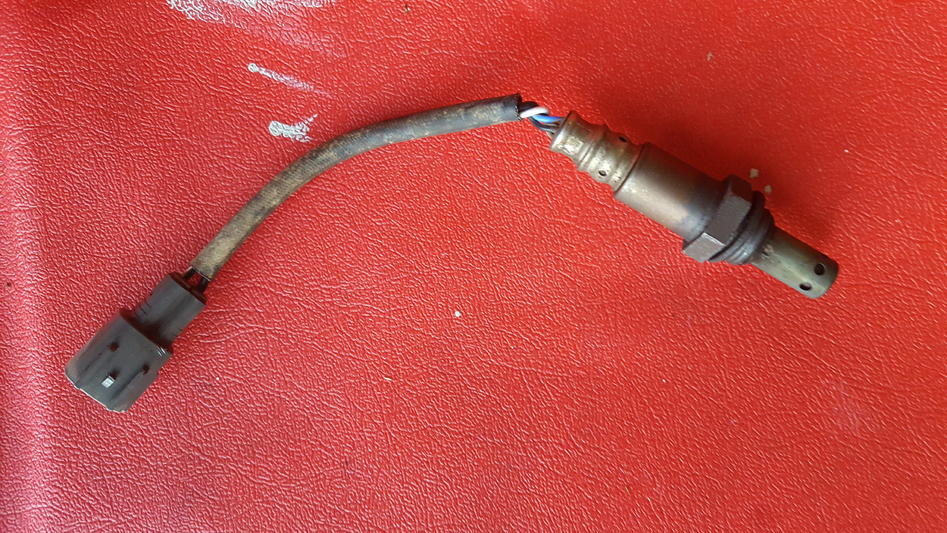

Well I finally got around to changing the bank 2 downstream sensor, now I have no pesky lights on the dash!
