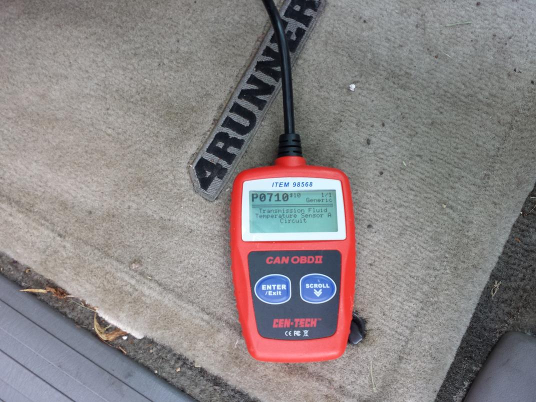

Hello!
I am wondering if anyone else has seen this code on an '04 Limited with the V8?
I got this code after parking my truck for a week while I was on a business trip. 15 minutes after driving away from the airport it came on. Of course it turned on the VSC and TSC lights. So when I got home I pulled the code I got this code on my scan tool. I clear the code and the light, but the VSC and TSC come back on as soon as I put the truck into gear.
So I search, and search for anything in regards to this "Transmission Fluid Temp Sensor Bank A" and I cannot find anything on it for my model year truck. I go to my local Toyota dealership and with my VIN are not able to find a sensor on the transmission at all for temp sensing. The parts guy calls his contact at Toyota and they say that it is the temp sensor on the engine up by the thermostat. I have the part on order but am not completely convinced that this is going to be the fix.
Basically I am hoping someone out there has had the same issue to provide some input.
Thanks!
Mitch

Thanks for this Matt! This is information is about the same as what my internet searching pulled up too.
I guess my question is... is there a temp sensor on or in the transmission? Or is it truly on the engine where my parts guy told me it is at. If I am to ohm shoot wires I need to find the sensor and trace it completely back to the ECU. Thanks again for the additional information on the other codes! I did not realize that different codes are for different conditions.
Mitch
