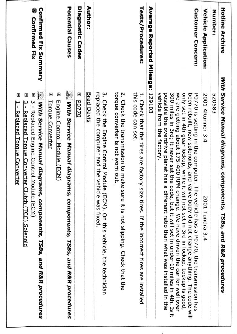

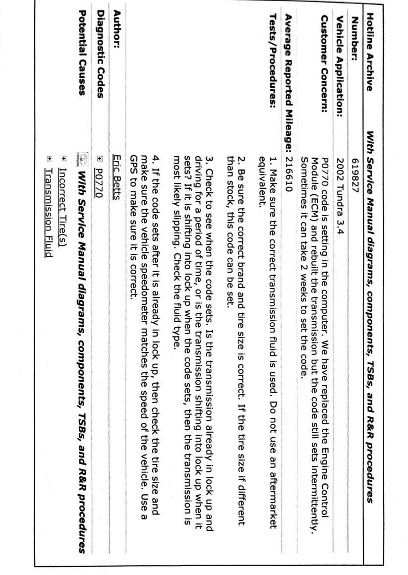

Two documents
These are two of the supporting documents. I don’t know what to think anymore.

Interesting read, even though its for a Tundra I'd imagine it may still apply.
What is weird is you would think every single person who has larger than stock tires on their 01/02 would be getting this code. And if that was the case, you think it would be a well known and documented thing but this is first time I've heard/read that.
