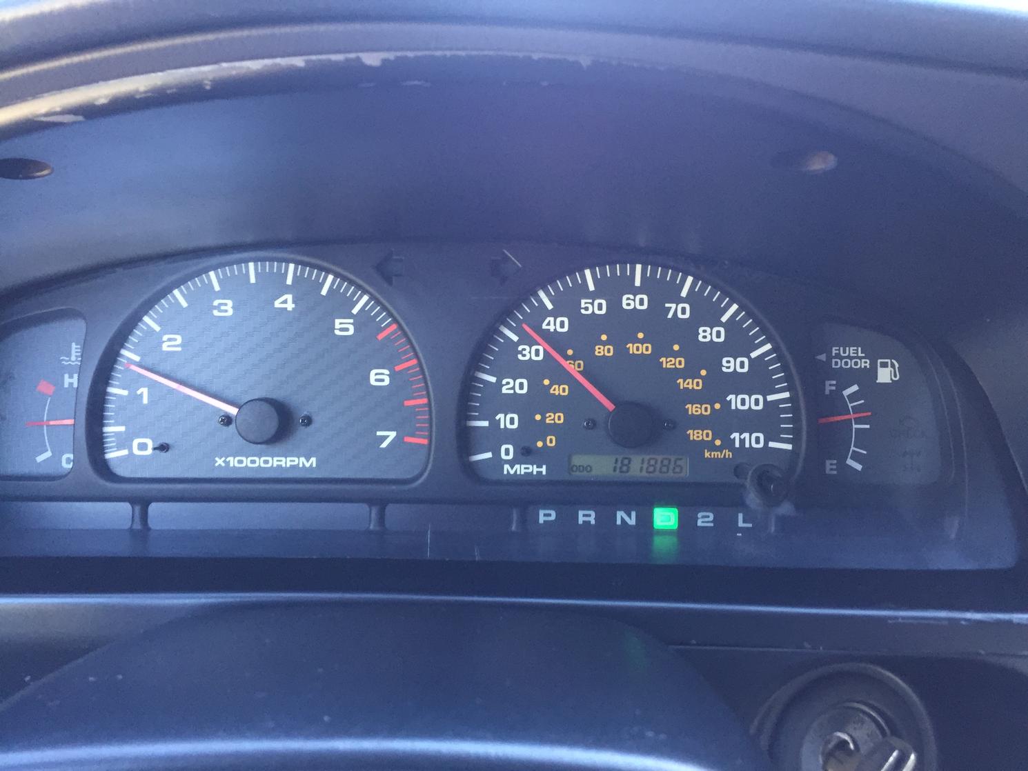

Just had the same issue a couple weeks ago. I thought the new pcbs were more expensive from Toyota (based on what I was told)......I ended up buying a used cluster from a 2000 4Runner off Craigslist for $60. Problem fixed and I lost about 85k off the odometer......

The solution was already posted. I also had the same issue. It will likely show issues with lights on the gear position indicator showing the wrong things (multiple lights on at the same time, or similar). Same thing happened to me. New flex PCB fixed it right up.
