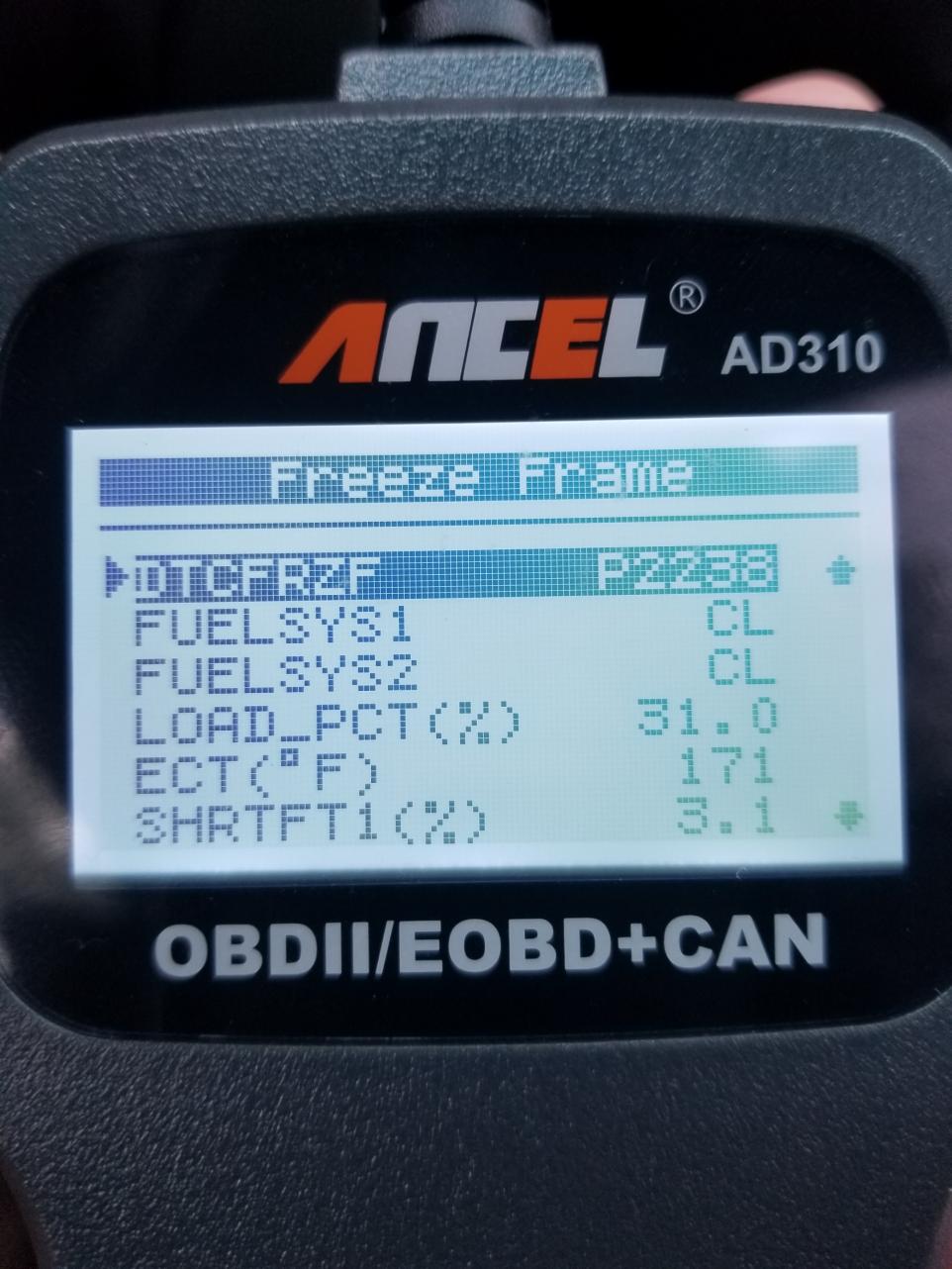

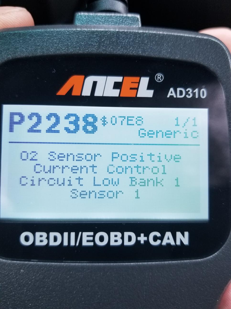

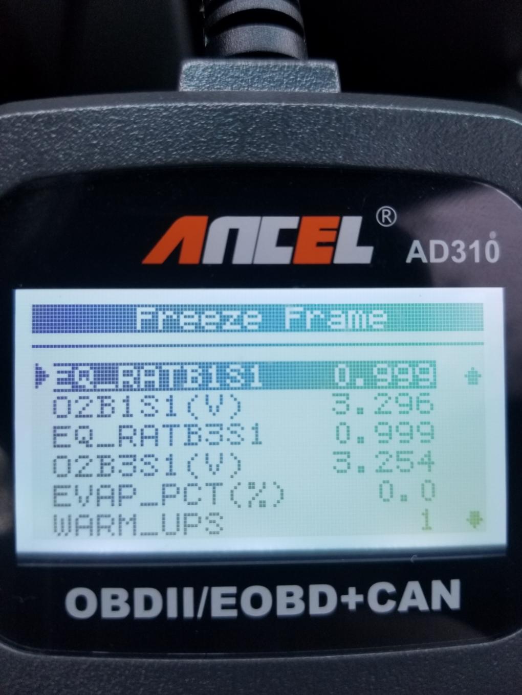

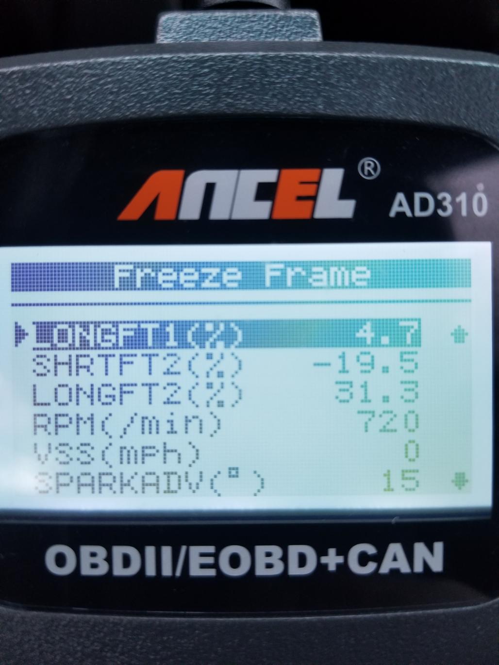

Hello all. I am an original owner 2008 SR5 V6 with 129k miles on it.
Some time ago I got P2238 and after extensive research and using my OBDII reader I came to conclusion (i am not sure of it) it's faulty upstream AF sensor on bank 1 (passenger side).
Before ordering and replacing the sensor I looked at freeze and live frames from OBDII reader and wanted to ask people to confirm that it's in fact or at least a large chance to be the upstream sensor on bank 1 as it displayed next to the code on my OBDII tool.
I will post some pictures with data from reader..
Also I can't find any thread with pictures to how get it out. From bottom or side or top of the truck and what tools to use. It would help tremendously since it does looks like big pita to get to sensor and it's connector

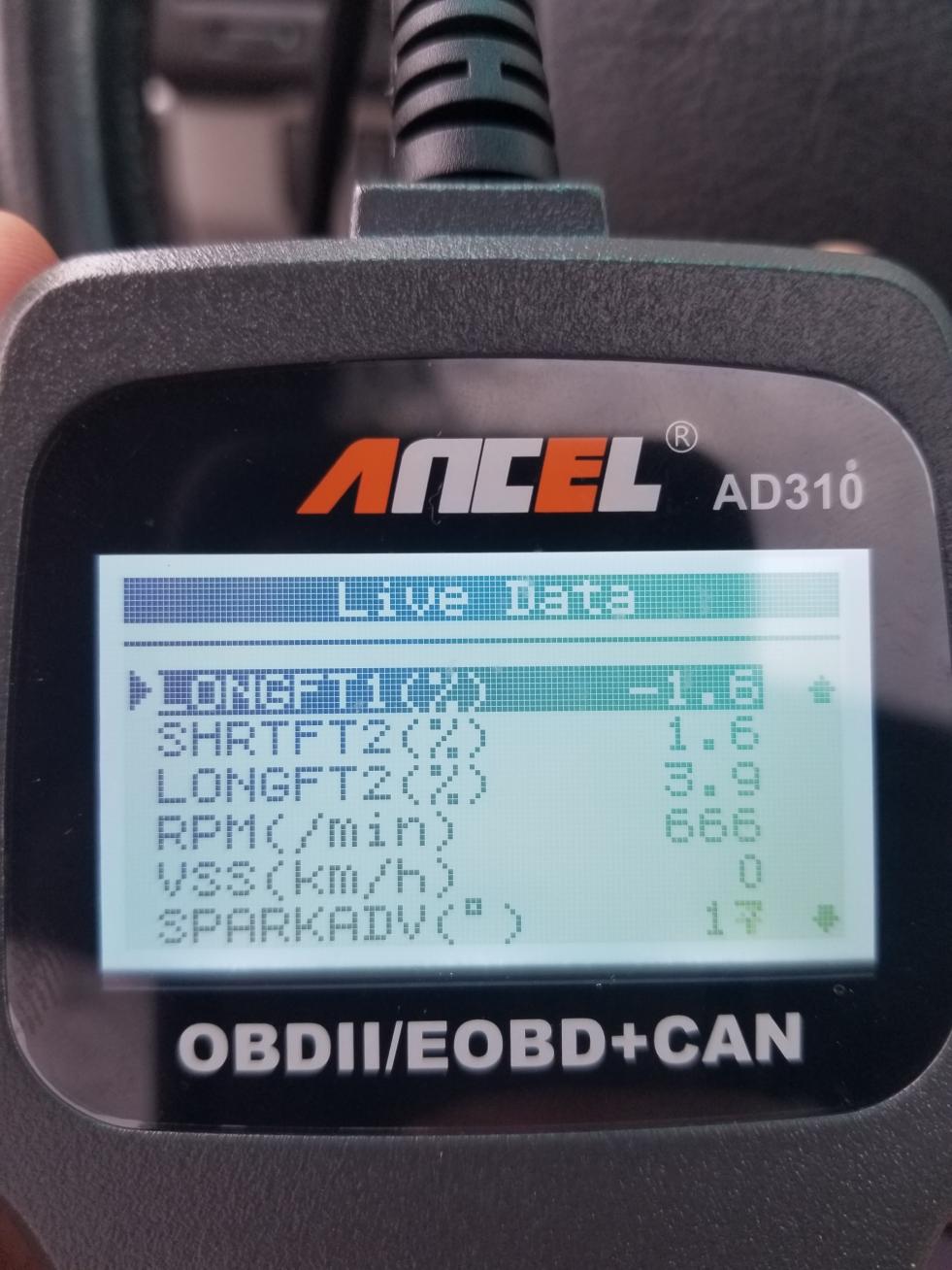

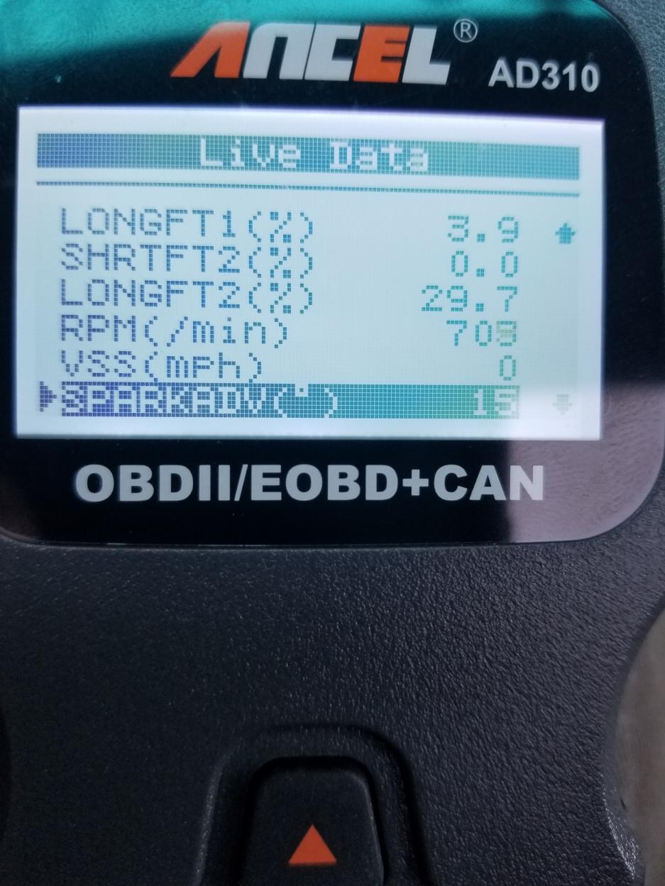

Here some pictures live and freeze frames.

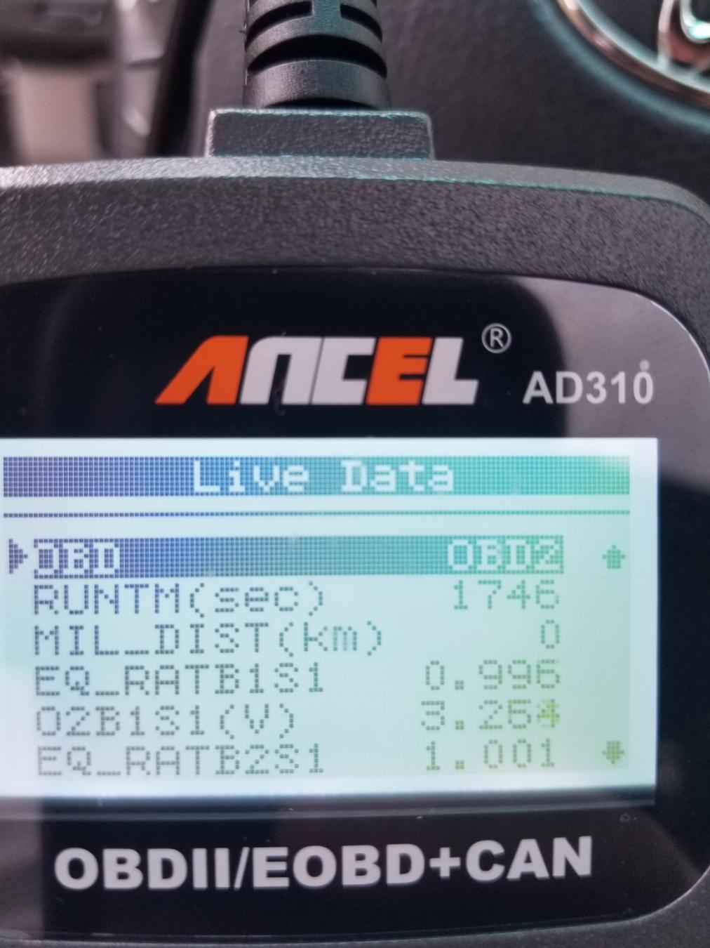

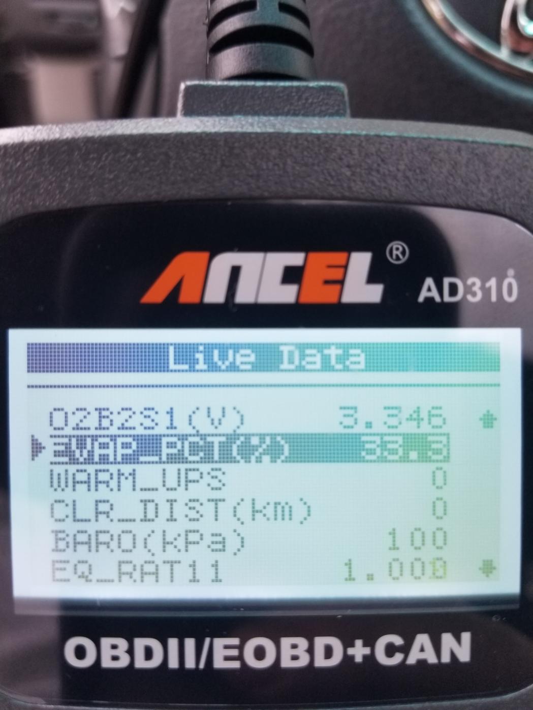

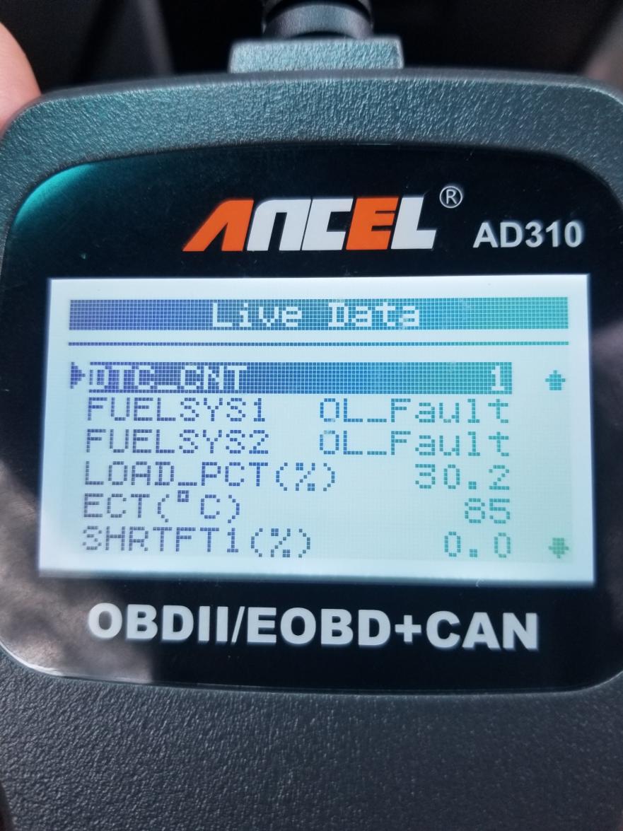

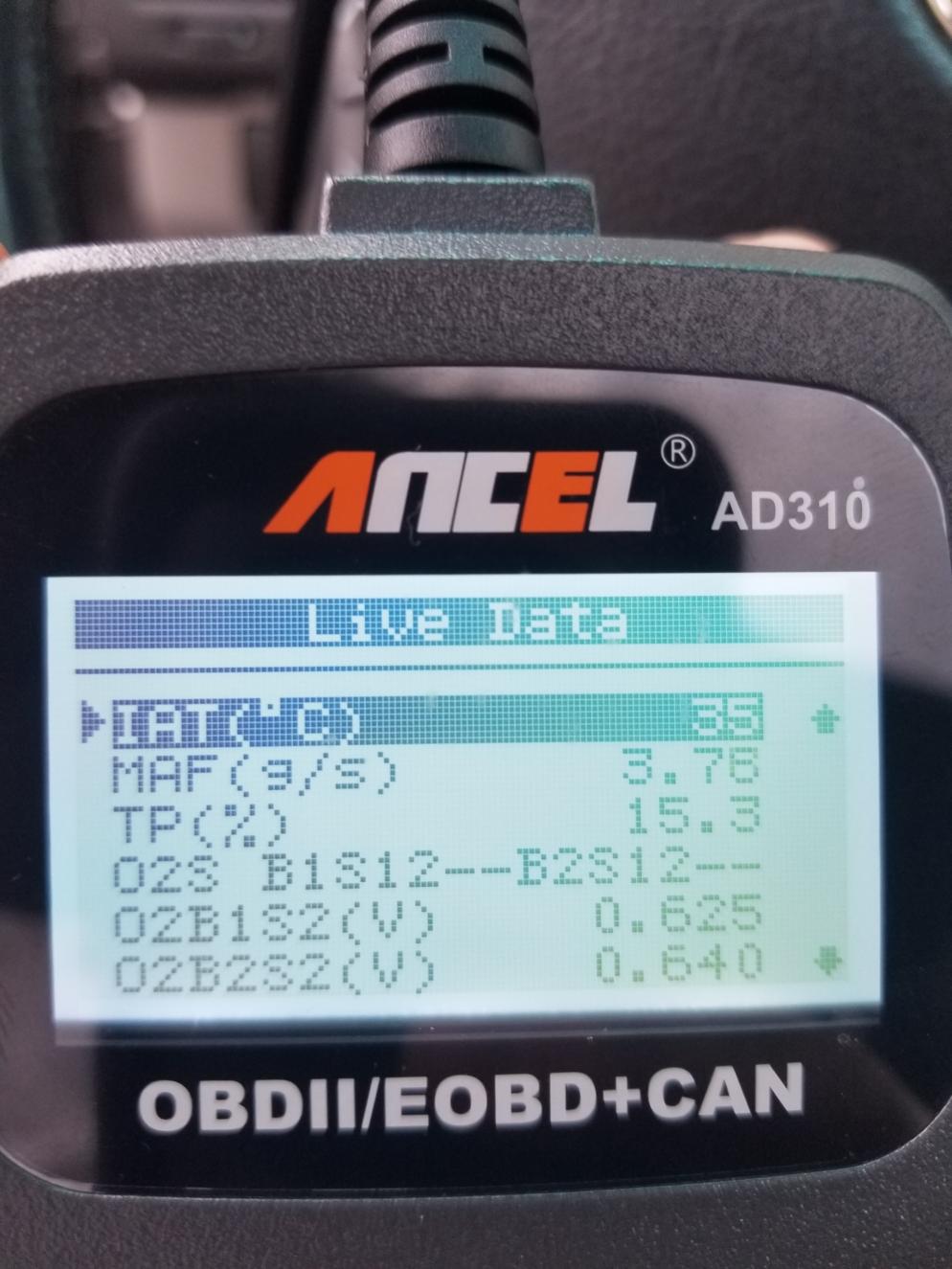

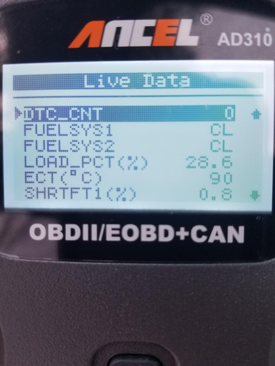

Right of the bat, what got my attention:
From Live data
FUELSYS1 OL_Fault not close circuit? AF sensor not recognized?
FUELSYS2 OL_Fault
SHRTFT1 and FT2 is 0 no fuel correction done for short trim fuel? ??
LONGFT1 3.9
LONGFT2 29.7 why so much difference between banks?
MAF sensor numbers seems fine

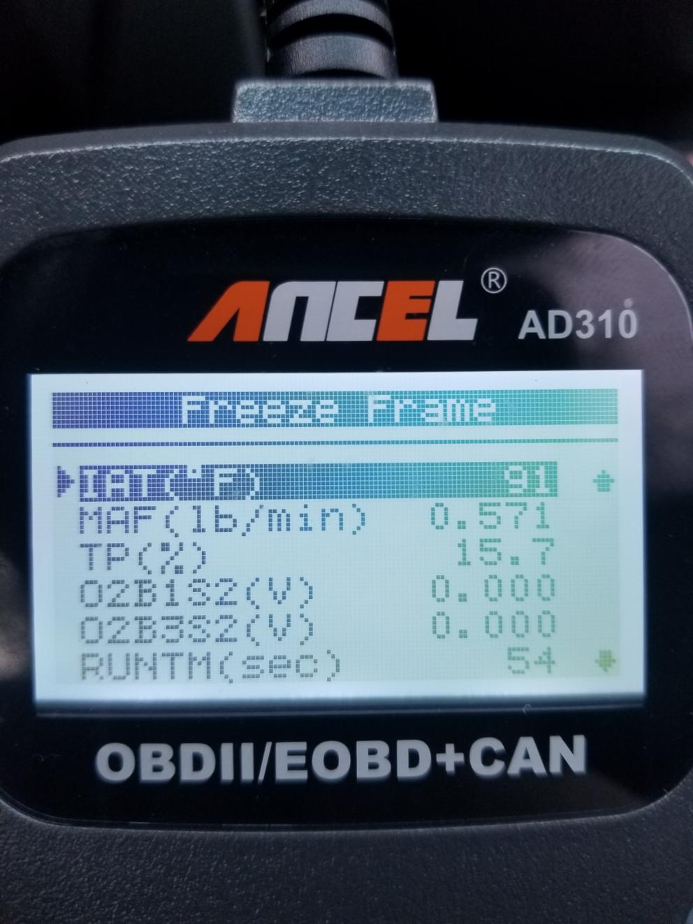

From Freeze Frame:
02B1S1 (3.296 V) almost 3.3 that is correct number.. when I increase the throttle during live run, the number go a bit down, not up as it should if the car running lean, yes?
and Short and Long fuel trim in freeze frame is completely different values comparing to Live Data
I hope someone who knows can put me on the right direction.
Thank you in advance.
Alex

Best guess for these LTFT readings (fuel trims)
This thread might help you. It mentions that Long term fuel trim > 10% is a problem. Your pictures show LongFT2 (%) of 29.2 and 31.3. Since your long term FT1 is in a good range, you could swap the driver side upstream A/F sensor to the passenger side and vice versa. Then see if the LongFT1 changes to ~30% and the LongFT2 changes to <5%. That would confirm if the A/F sensor needs to be replaced.

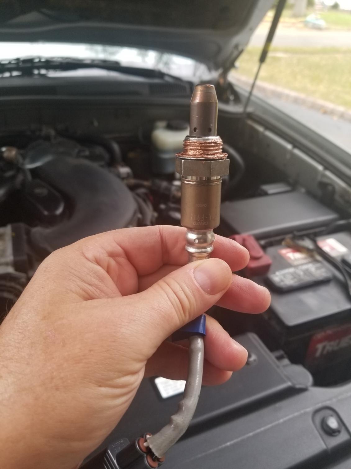

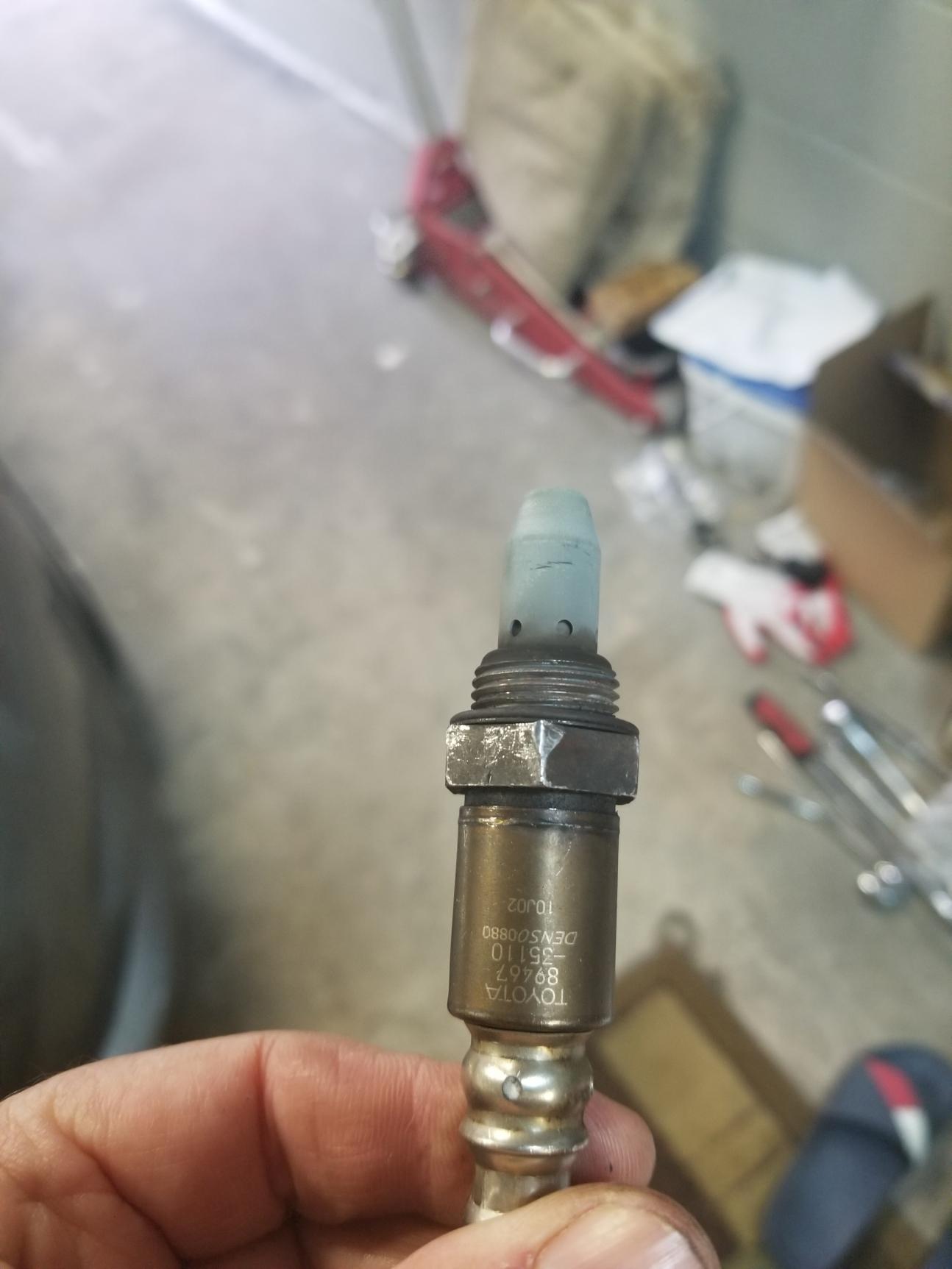

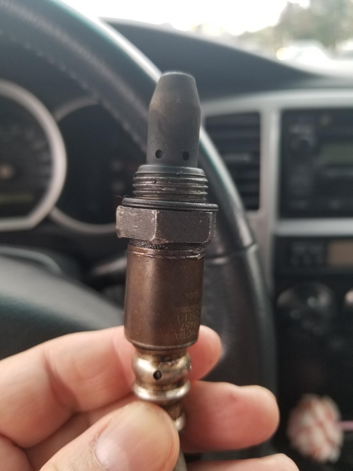

Alright, here is an update:
I learn so much more about my rig issue between the first post of this thread and today.
My finding may help someone in the future..
Here we go:
Tried different MAF from my friend truck, no changes. Wasn't the issue in this case.
Replaced passenger side upstream AF sensor (on my own) with new Denso from RockAuto, cleared P2238 about a week ago, so far code did not came back.
Next I replaced driver side upstream AF sensor also with new Denso (fyi, bank 1 and bank 2 AF sensors are the same part number).. Also, i spent few hours and wasn't able to removed that rusty b#$ach so I went to local Midas shop and let them do it for $70 in front of me, to make sure they put copper grease that comes with the sensor on its threads. Cleared P0174 and so far it did not come back for last 3 days. The fuel trim improved and I think it's where it should be now.
So I am happy with this part, but I do still have this unusual noise from time to time when I accelerate and release the gas pedal. Its hard to describe, kind of pronouncing howling on specific speed, most heard between 30 and 40 mph.. I though may be transmission, but when put and roll on neutral sound does not change at all. I will check the fluid level though to make sure its good..
What I am worry about it's a driver side catalytic converter. I have a bit of feeling this sound coming from there after I saw my old AF sensor that I removed, it's all black,dirty and smell gas. May be for the time I drove with P0174 (about a month before I got the fix) it damaged driver side cat.. I hope I am wrong..Big job..
My next step is to test this cat with my OBDII reader (check the voltage in INLET and OUTLET and check the temp in the front and end of this cat with infrared thermometer. I saw great YouTube video on how to do that).
I'll let you know guys
Alex

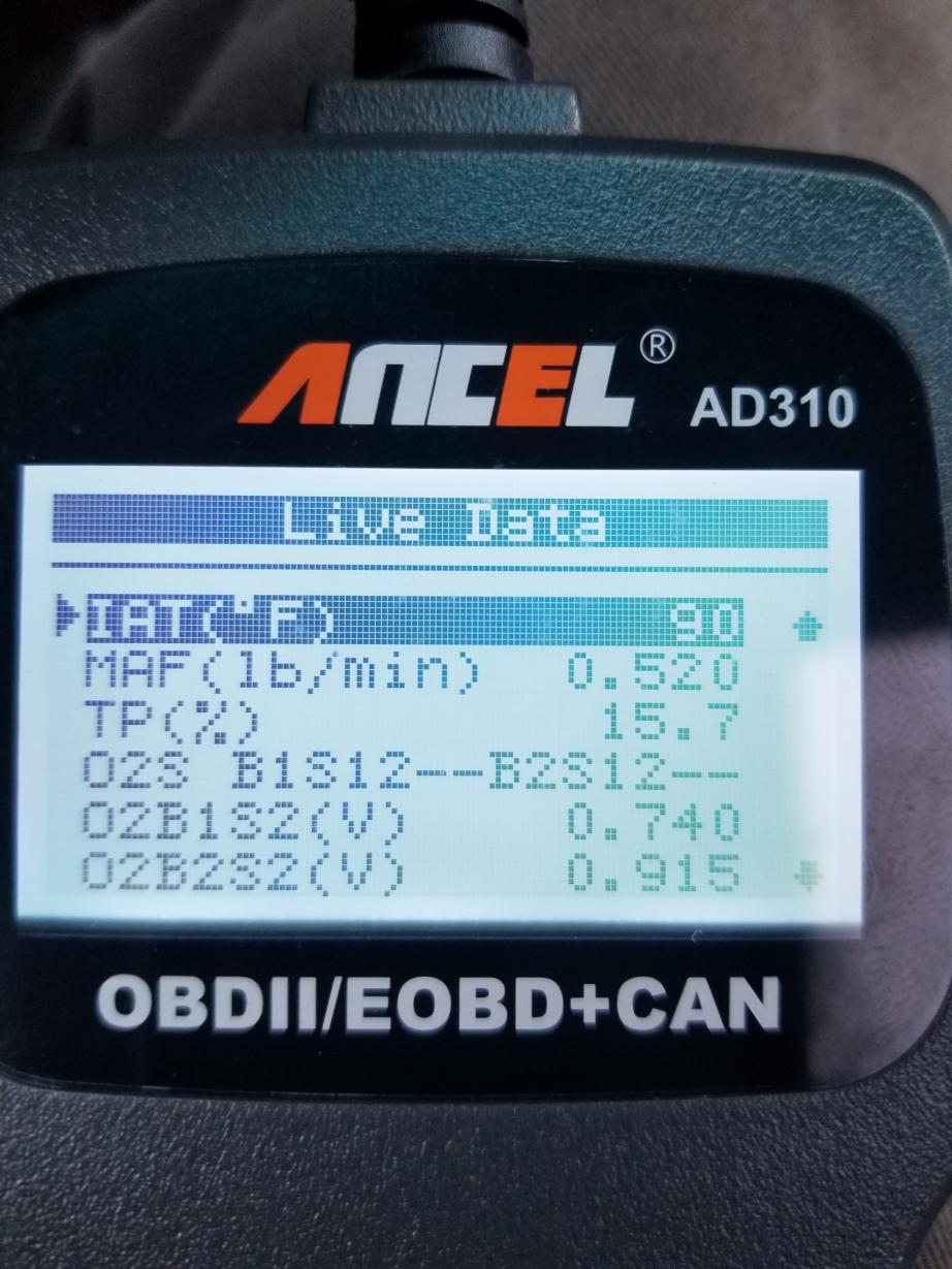

p.s. Here is my new OBDII data after replacing these upstream sensors..
