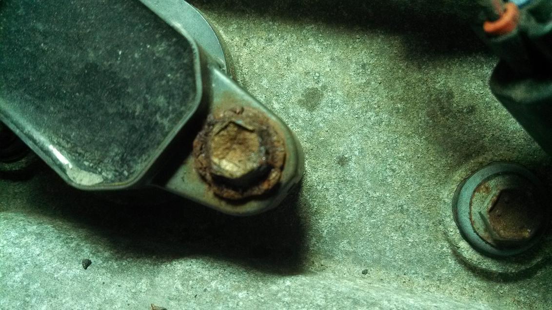

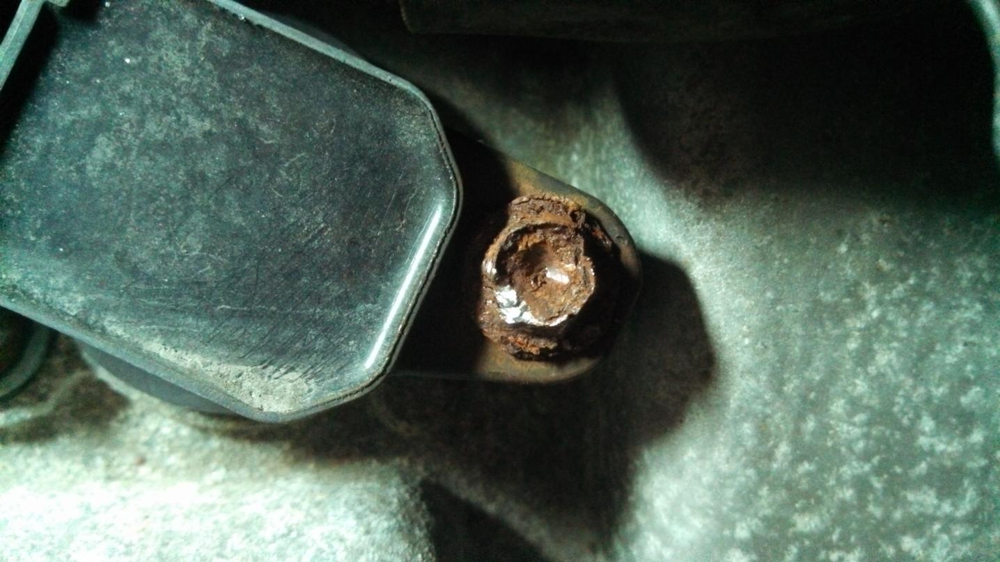

So I decided to change out my spark plugs this weekend. What should have taken an hour or less took most of the day. Thanks to the rusted bolts on the coil packs on the passenger side, I had to take a trip to sears to find a good set of bolt extractors. With those I was able to remove two of the rusted bolts. One still wouldn't come out so I had to drill the bolt head off... slide the coil pack off the bolt stud and then with a pair of vise grips, turn out the stud. Once that was done, the rest was a breeze. Put in some nice Denso Iridium plugs. I also had ordered 6 new bolts for the coil packs before I started.

How long has it been since they were last changed?
That seems like pretty excessive rust. Was it only certain ones that were rusted or were all showing some rust.
Either way, that would totally suck.
Just the passenger side bolts. All 3 were rusted. Funny thing was the drivers side was fine.

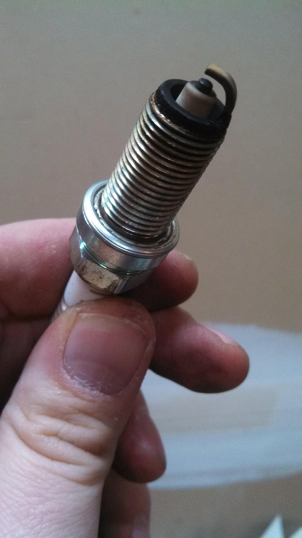

I don't think they ever changed the plugs. Here's a shot of one of the old plugs.

Just to let you know, they should be changed every 30k if you're using factory copper plugs.

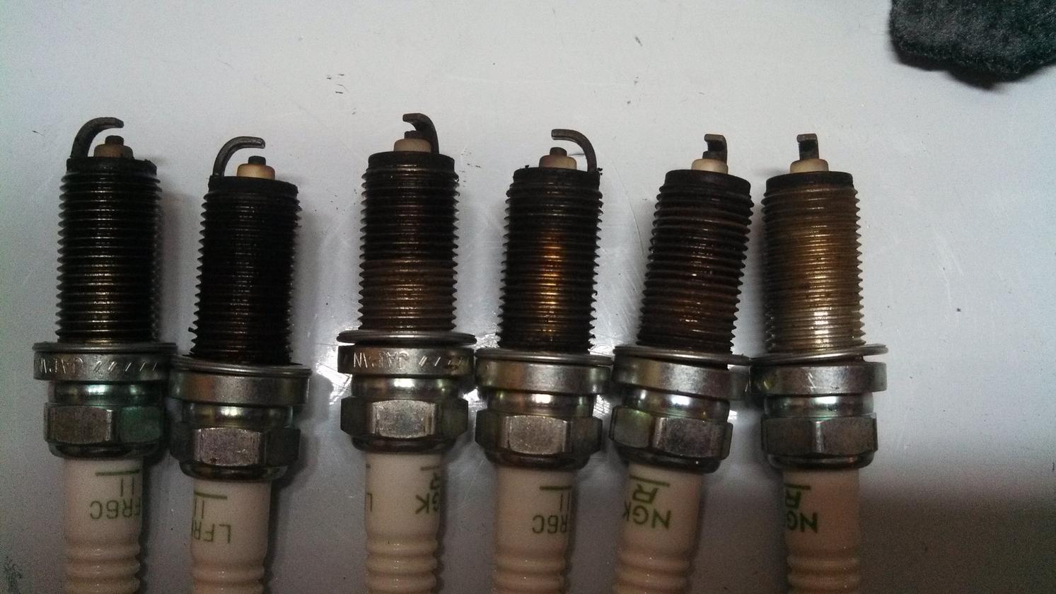

[MENTION=94544]AJColorado[/MENTION] , did this today too on mine.... found my 4runner had the originals still installed as well (no rust problems on mine though thank goodness, that doesn't look like much fun). How'd all your plugs look, especially #6 (driver side closest to the firewall). [MENTION=49807]blackmax[/MENTION] has a theory he's working on....

Here's all the plugs.

If the tip of the plugs have a mark, letter or such on them they are original plugs.
If you ever run into this again, I would spray those 10mm bolts with some SeaFoam or PBBlaster overnight. It will make a huge ass difference.

Wasn't the threads that had rusted... just the heads were toast.
Yes, but you have friction between the bolt head and the coil as well as the threads. If these are "lubed" per say, the less force you will need to put on the head, which means less damage.
