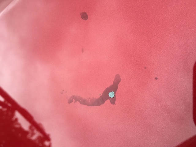

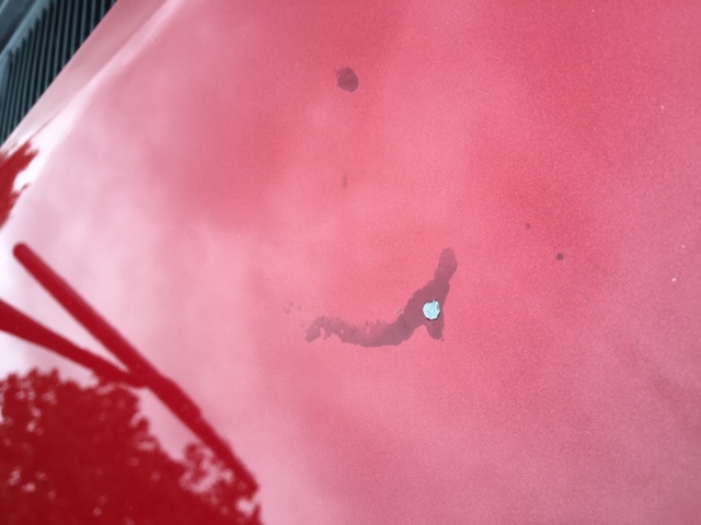

Hi I have attached some pics. Can anyone please let me know what would cause this on the hood? I have a 2014 model sr5 but garage kept.

Battery acid can cause damage that looks like that. I'm sure other types of acid could do the same.
Thanks for the reply. I guess it probably won't be covered under any warranty. Very weird how this happened. Any suggestions on how to fix besides repainting the whole hood? I guess I could get touch up paint. Thoughts?

You’ll never get it to look perfect on your own. But you could clean and prep it then apply primer and touch up paint to protect it from rust until you get a proper professional hood painting. The Dr Colorchip touch up paint works well for small areas.
Another option, depending on where the damage is, may be to prep it so all is smooth then get a vinyl wrap.
Just wondering if some kind of fluid spilled on it while it was being serviced and you didn’t know it ? Or bird poop left on it ?
Nick that is a great question. I had my 4 runner serviced about a 2 months ago for the faulty fuel pump. There is no way of knowing for sure. I am going to take it in for the dealer to look at. I am doubtful they will do anything. I will see what they say and then the other option is to have my insurance look at. I will see what the dealer says...Sucks
Brake fluid can have the same effect. Have you had any brake work done lately? Just having some on a rag and setting on the hood for a few minutes can do that, especially if any residue is left on there long term and not wiped away immediately. Another thing to consider...

I had my front brakes replaced 6-26-2020. How can I convince the dealership that they possible did this?
Is that dark looking stain related to the missing paint? You might check to see if there are any paint recalls. Back in the 80's GM issued recalls for paint related issues on the Grand AM and Corsica models. One was for bad primer that caused the color coat to flake off and the other was for paint that faded quickly.

I am willing to bet a claybar and paint correction will take out the darker spots no problem. Then all you need to do is just have the tiny dot done PROPERLY with touch up paint. If scuffed, touch up painted, then fine sand and buff you would barely ever be able to notice that tiny spot once fixed.
Not worth having the ding on carfax, $500 out of your pocket, and the risk of the entire hood not blending well with fenders. Especially since the paint on these things chips if you look at it wrong.

I agree. The problem is where the metal is showing that whole area is bubbling up and is already ruined. I am in Nashville TN and don't have a direct contact to nor can I touch it up myself. I can take it to a body shop and see what they say.
I took it to a collision shop and they can repaint the area that is messed up vs painting the whole hood and getting into a big project. They would strip the existing clear coat off the hood, put on a new clear coat, sand and repaint the area that is messed up. He did mention fixing it myself. The cost I was quoted was $565.00. I wouldn't put it under insurance. Might be best to get some paint and touch it up myself and see what happens.

Its a nearly impossible long shot, but you could ask if they have surveillance video of their shop dating back that far. You can look to see if some moron wiped brake fluid off his hands with a rag and set it on the hood. Alternatively, see if there is a test that can be performed to identify brake fluid in the paint? Also a terribly long shot.
When it comes right down to it, talk is cheap. Walk in there politely and ask the service manager what he thinks of the damage and explain that it started after the service and you JUST figured out that it might be brake fluid. The worst they can do is tell you to kick sand. Under some miracle, they might say "yeah, ol' Jeff was an idiot and did that to 5 vehicles before we fired him..."
Another alternative? Find a sticker or vinyl wrap that looks good in that spot, clean it well and slap it on there! Cheesy, but effective!

I decided to get touchup paint and just do that for now. The 4 runner is older and I am going to keep until it doesn't drive anymore so I am not really feeling the need to drop 600.00 until necessary. I will see if it gets worse. Thanks for the responses.
