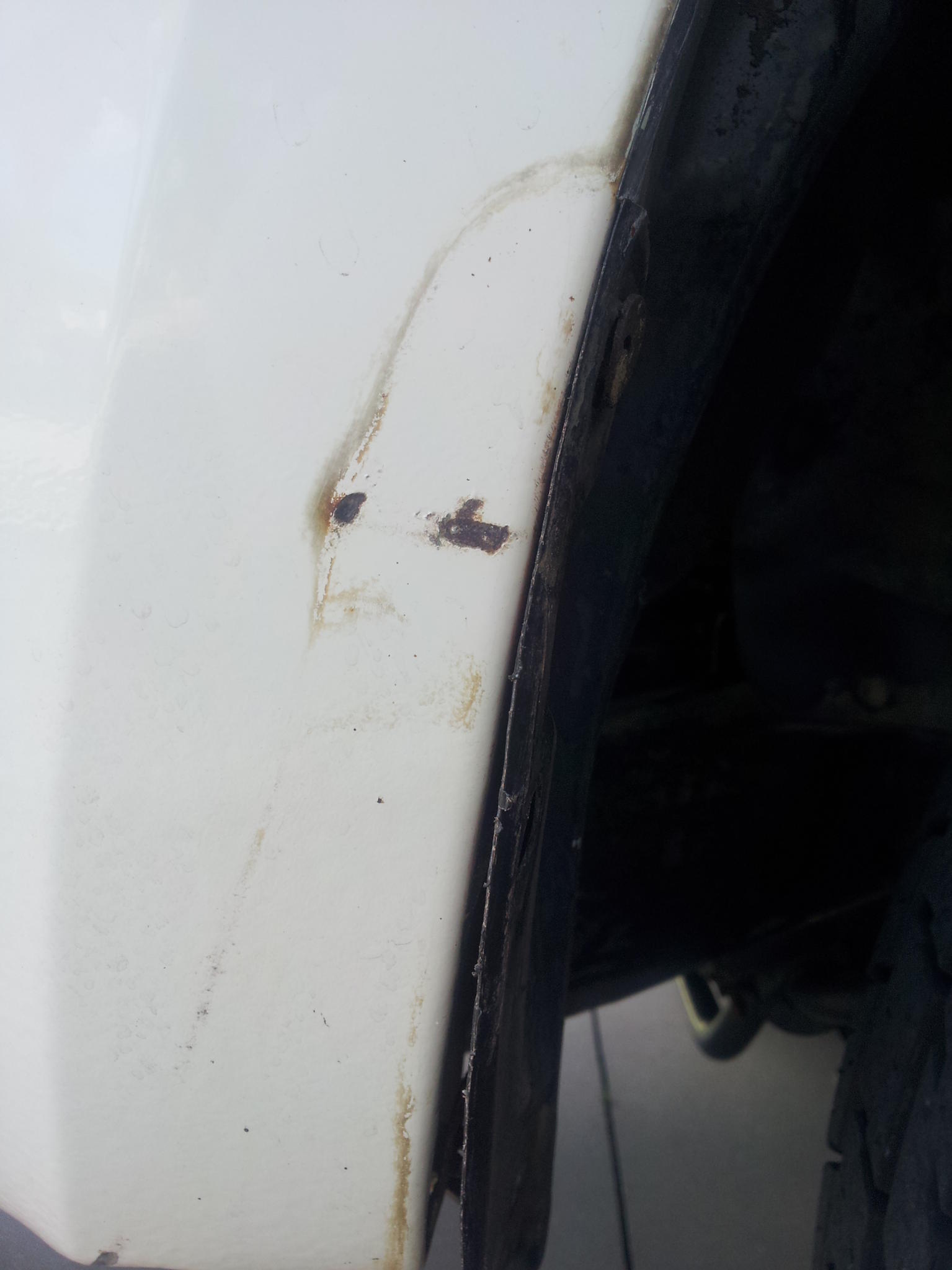

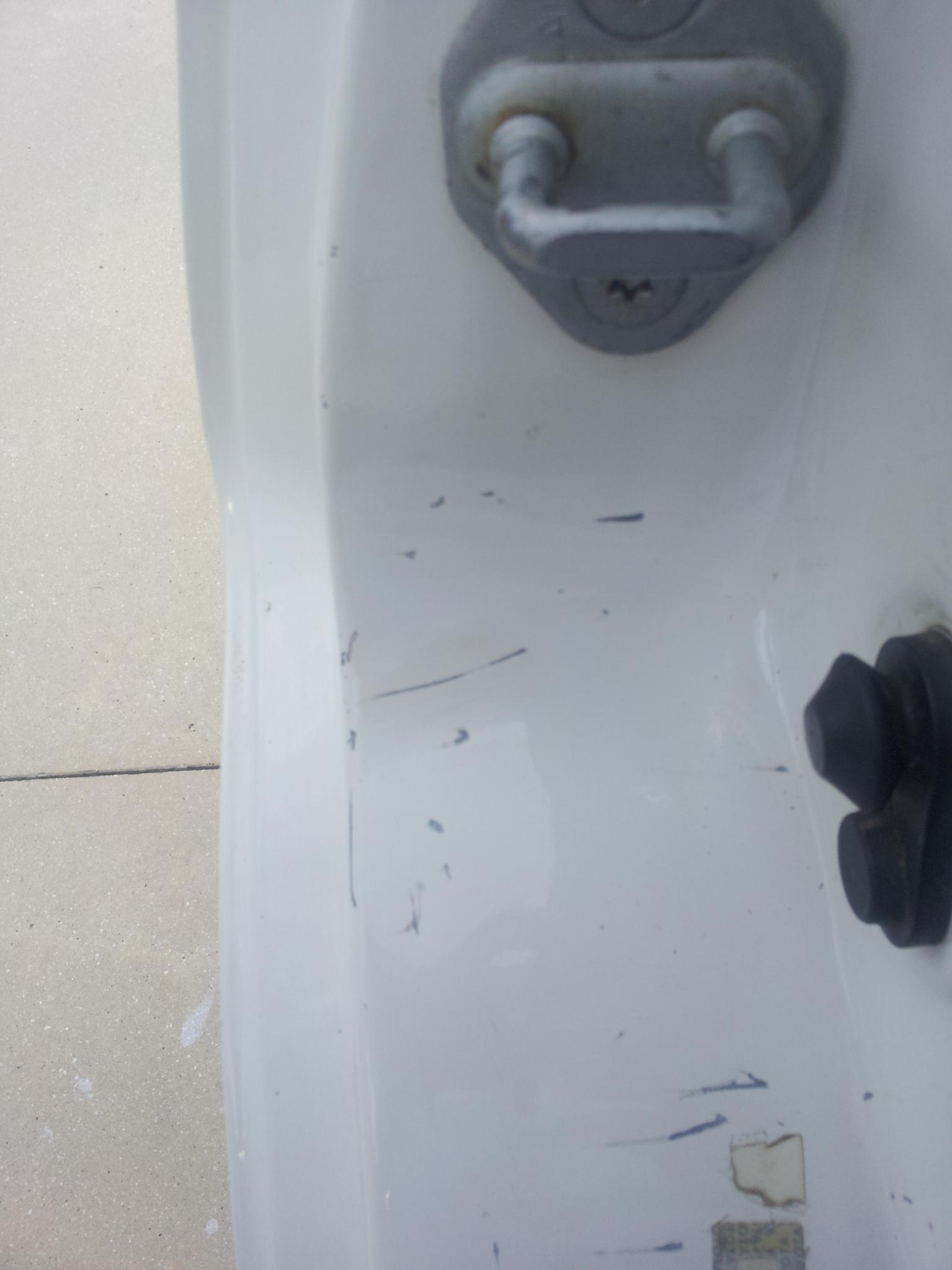

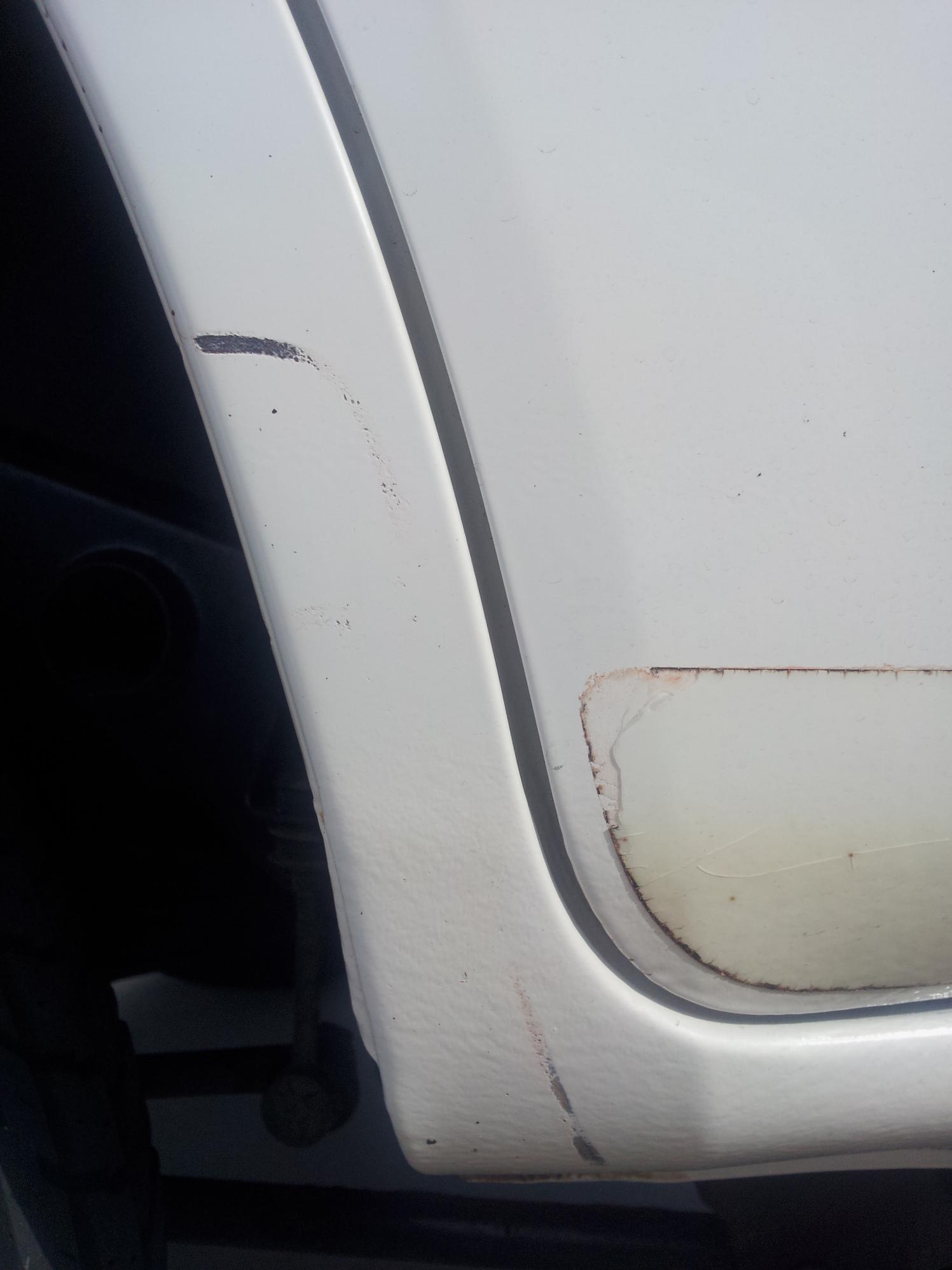

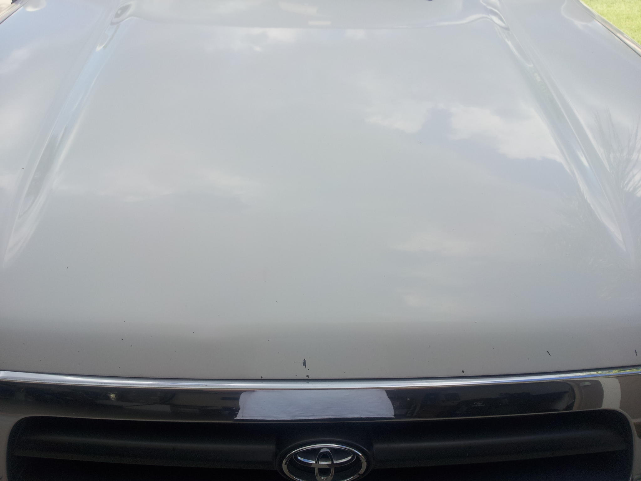

I have several problem areas on my t4r that require new paint. Some are small touch-up spots like the door edges and jams. Others are large spots where it would be easier to completely repaint instead of touching up, like the numerous chips on the front lip of the hood, an area on the d/s fender where I was side-swiped in a parking lot by a mystery driver and damaged areas where p/o had running boards that wore out the paint. All of this damage is down to or near the metal, these are not superficial scratches that can be buffed out.

From the sounds of it, your hood is like mine. I've got 3 or 4 big chips and a few smaller ones. I've thought about just sanding mine down and repainting it. Although if I go that far, I'll buy an aftermarket scoop hood and just paint it.

Anyway, I've got some pics of the problem areas below. I will post updates with my progress.
