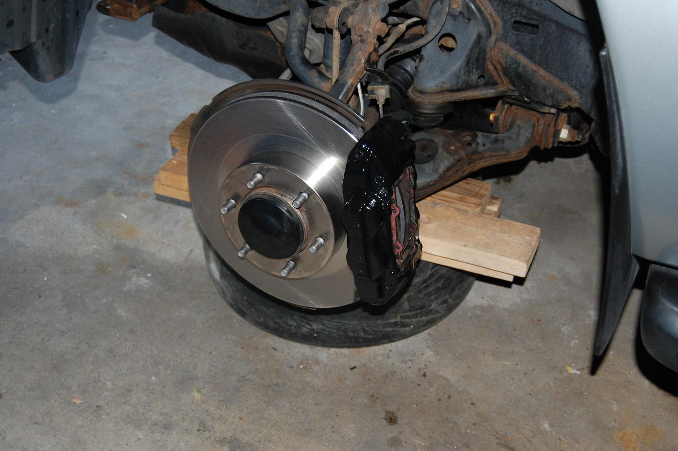

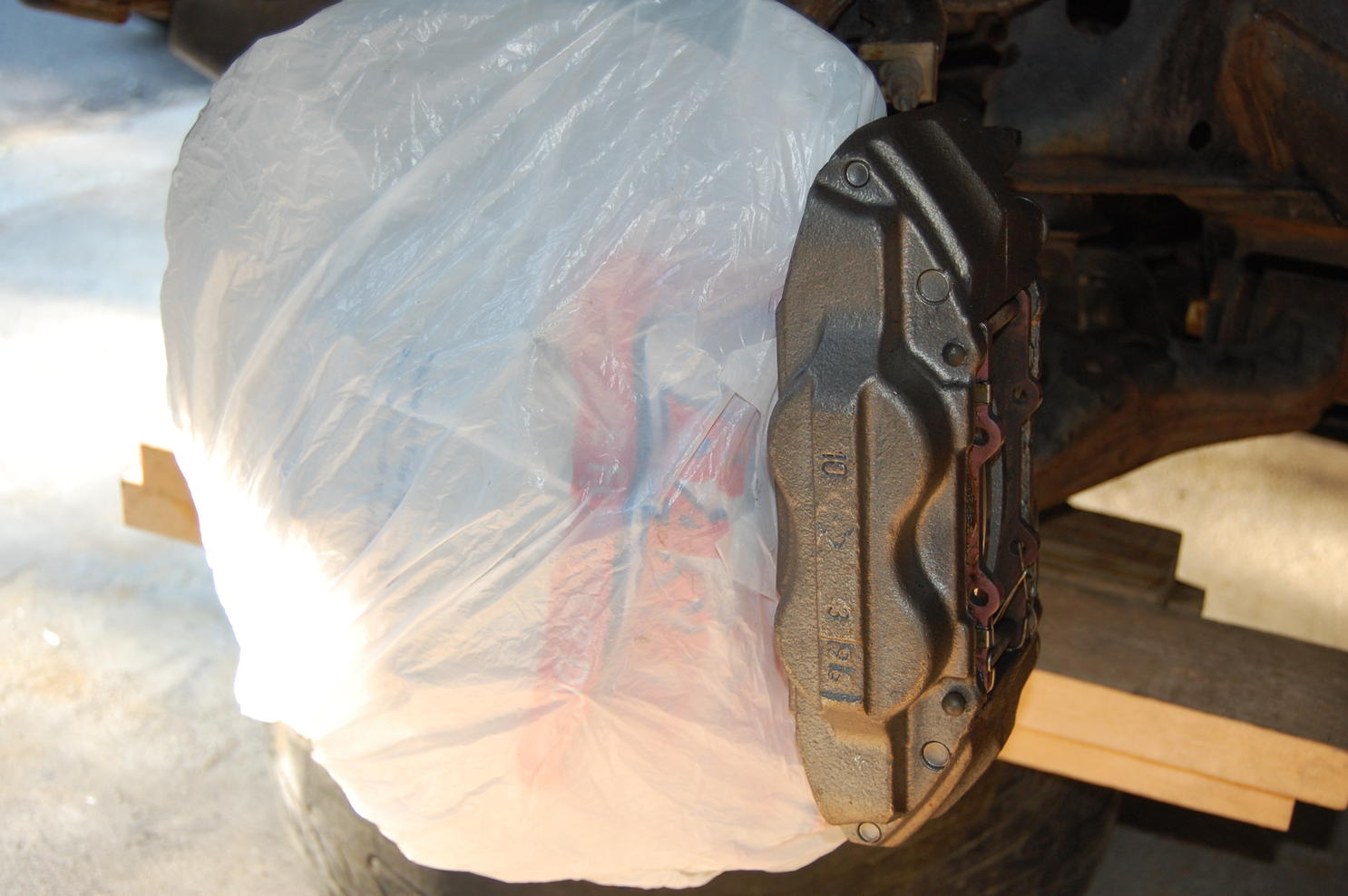

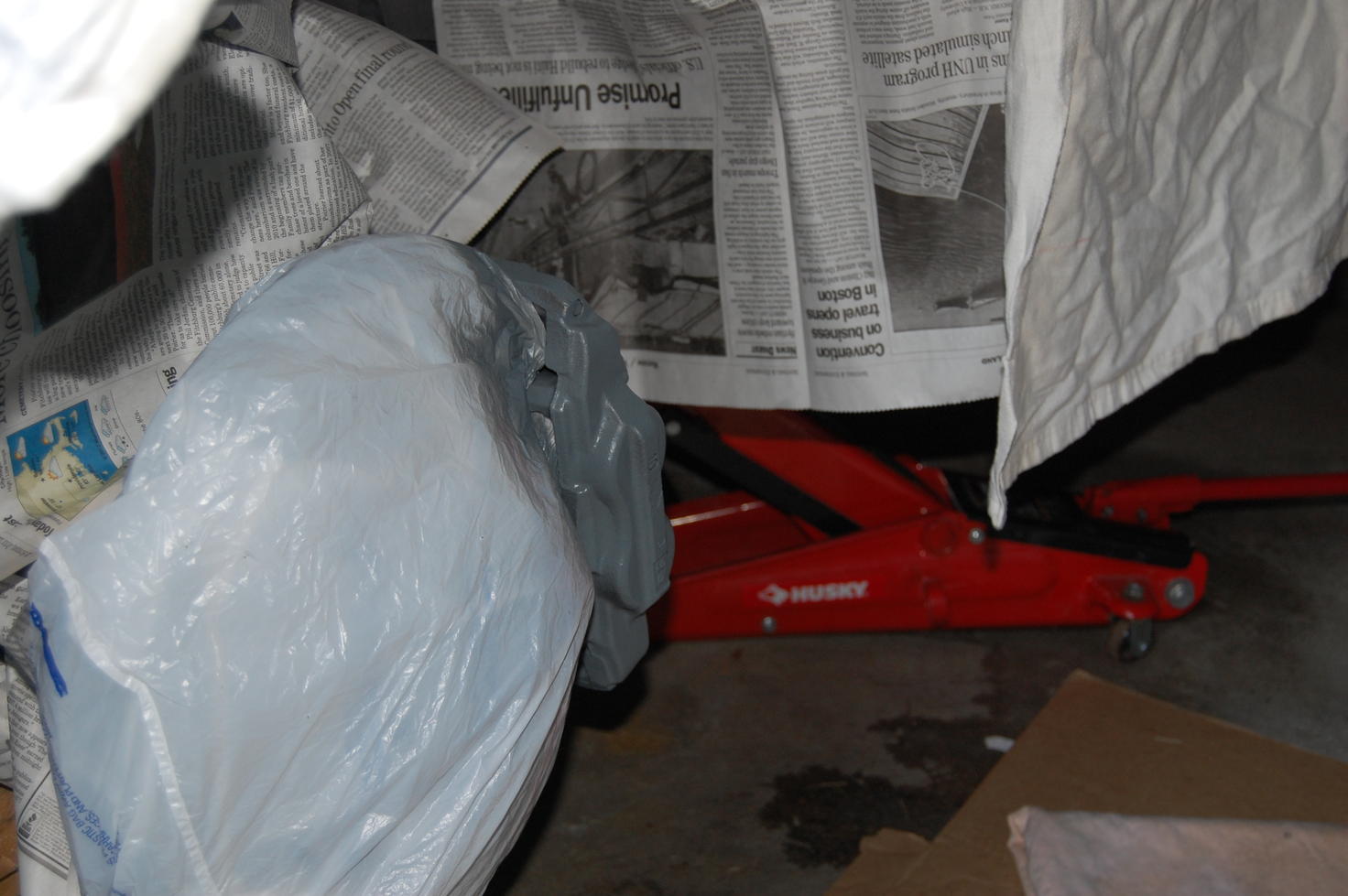

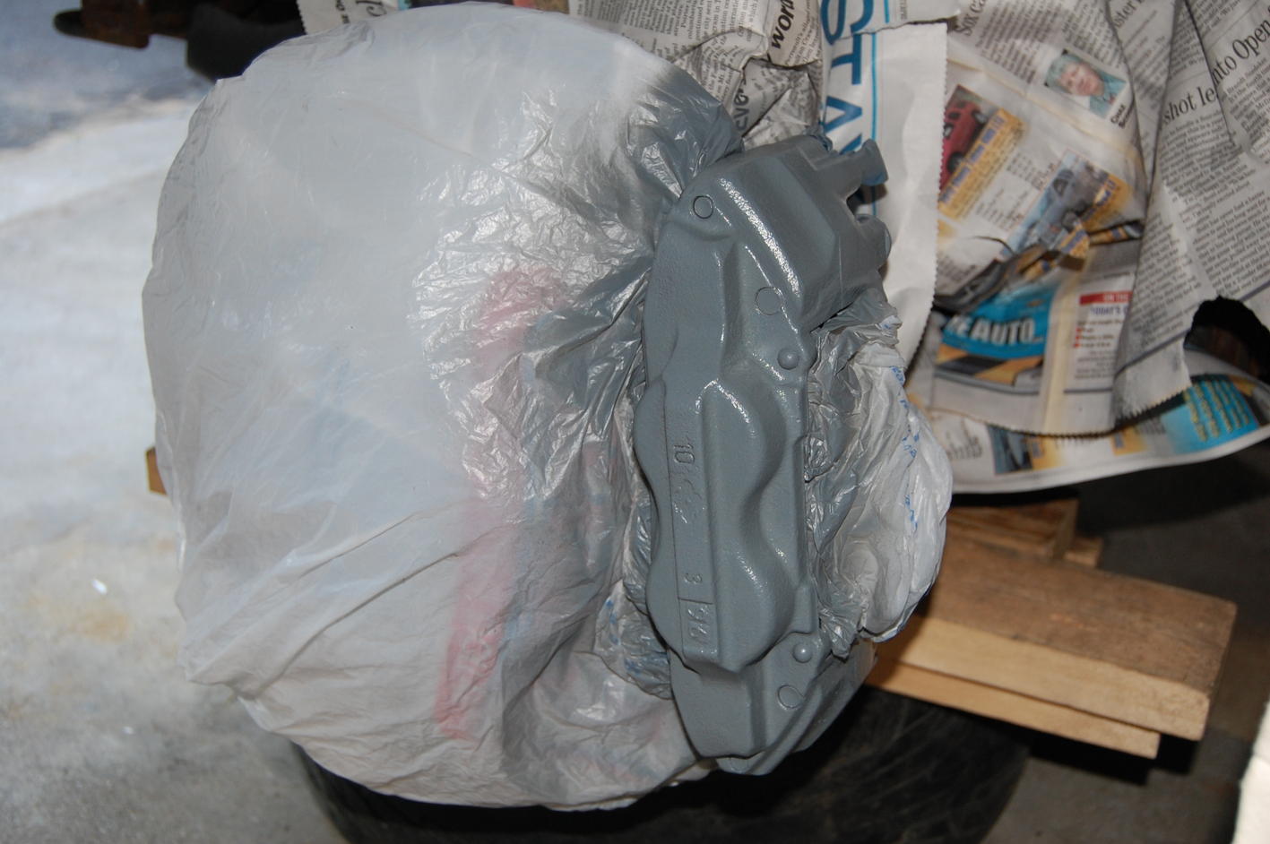

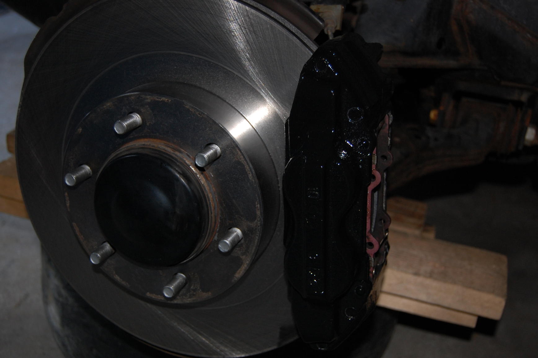

Brakes feel like new again. Humming noise gone and the car is once again quiet. However, on each ocassion when the dealership replaced the calipers, the replacement corroded within a few months and they told me they used the OEM Toyota calipers. When compared with the 4 to 5 year old ones that come off the car, the replacement sure doesn't seem like the same quality steel as the original ones they built the with. Has anyone else experienced this?? Anwyay I decided to paint them the next day and uploaded some pics. Hopefully they will last a while before they need replacement again. No
Note the first picture(original caliper) and compare it to the second one(replacement).
