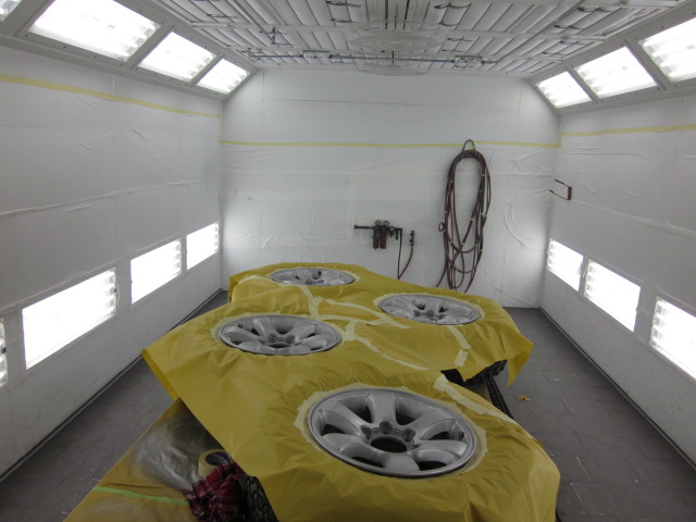

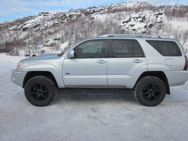

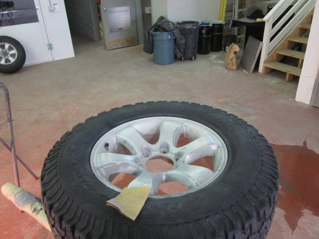

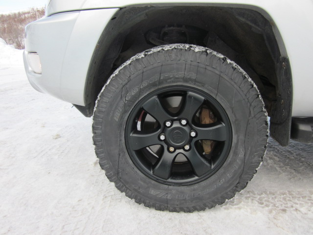

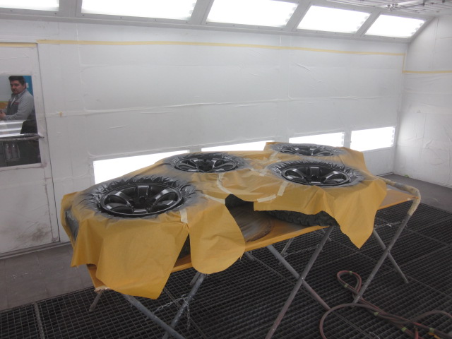

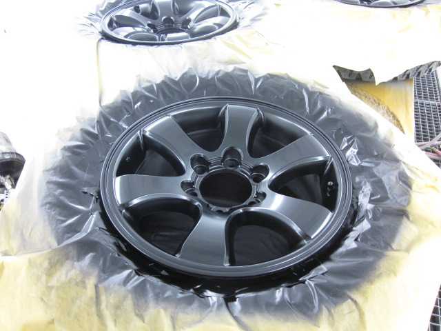

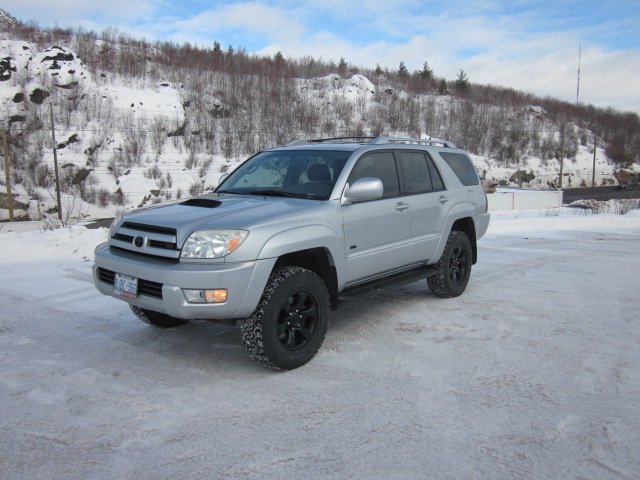

I finally pulled the trigger. I spent all Saturday sand blasting and painting my rims. It took me three hours to sand blast all four rims. Basically one (100lb) bag of sand per rim. Then I sanded each rim with 180 grit sand paper ( with an orbital sander and by hand. After that I cracked the bead on my tires so I could sand the edge and have no peeling issues. Then I blew them off and put them in the paint booth. I used epoxy primer wet on wet, baked the rims for an hour then painted them 202 Toyota black with flat clear.

I like how you did it, they look good. Only complaint is how the center caps are with the toyota symbol painted over.
Perfect,
I have a silver SR5 as well, and I just picked up a set of these rims a little while back. This is my spring project and you gave me the perfect visual of what mine will look like when I am done. Thanks for posting this, and it does look great!
