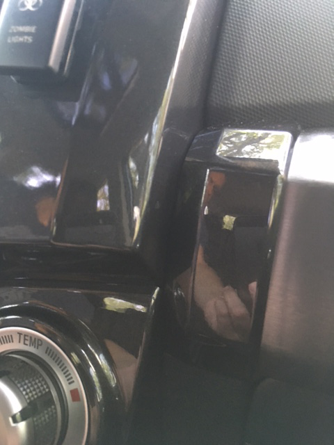

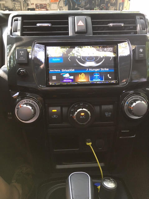

Here are a couple of photos
The first one is the full dash. The 2nd one is a close-up of the Scosche kit + the AC controller trim piece + the little piece next to the glove box.
To get the high gloss, I sprayed 2 light coats and 1 medium coat of Dupli-Color clear. I waited 20 minutes between coats. After 7 days I sprayed 1 medium coat and 1 heavy coat (waiting 20 minutes between coats). After 2 hours, I used a very fine microfiber cloth and some 3M Perfect-It buffing compound.
In the picture you'll notice I made a couple of mods to the Scosche kit. I used a Dremel tool to cut-out 2 places for AOB switches. The Flux Capacitor switch turns on/off some blue LED strips that are under the driver's and passenger's side dash. The knob below the Flux Capacitor switch is a potentiometer that controls the brightness of those LEDs. The Zombie Light switch turns on/off the LED spot lights mounted on the front of the 4R.

How did you remove the dash piece? Was it difficult?
Awesome! Finally a solution that looks like it works....and because of that I want to do it now.....I hate you:redbrick:
