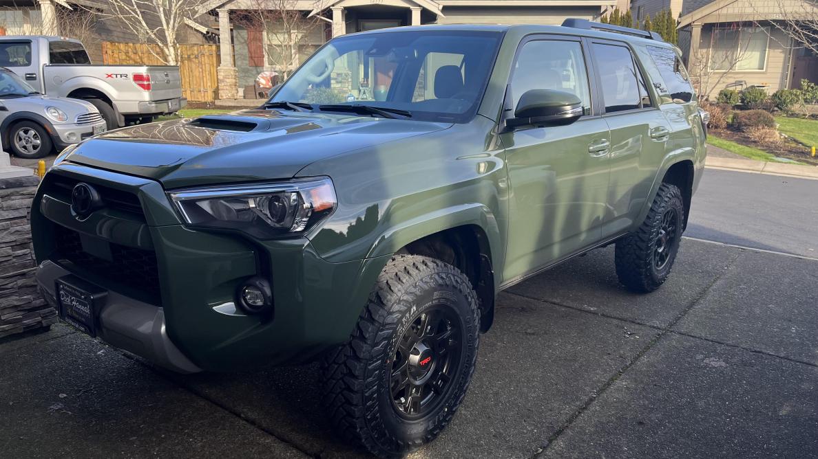

Hey,
I can't find a thread where someone painted the silver bumper on a TRD OFP. I want to the do the same. What process did you use and what product? Plastidip?
Or should I have someone do a wrap on this area?
Sorry on the title I meant to say "Painting the silver area on bumper black"
Lots of threads about his but I’ll save you some time and headache. Krylon spray paint for plastics will work. Plastidip will work. Neither will last. Rocks and stuff will chip the paint. I’ve tried both. I ended up buying the TRD Pro black valance and it’s perfect.
Personally I wouldn't do plastidip. Just get some SEM (SEM-39143). It matches perfectly to the trim OEM sheen. You can get a can off Amazon for ~$10-15.
I think someone had a thread on here awhile back, but I just basically masked off the area using painters tape and a deck of cards to get clean lines. Then used some plastic sheeting to cover any overspray. Couple light coats and it was done. Still looks factory new ~2.5 years later.
edit: here's an example thread, Who has changed the color of Front and Rear Valance
Just search for "paint valance". Lotta folks either do SEM, plastidip, or bedliner.
Use hot rod satin black 2k from spray max
It will last just as long as oem
I was contemplating wrapping mine but was told painting it would be much better.
Ill probably just get a C4 bull bar at some point.
Is it easier to remove them for painting? The silver just looks dumb, but if it's too much of a pain I can live with it I guess.
