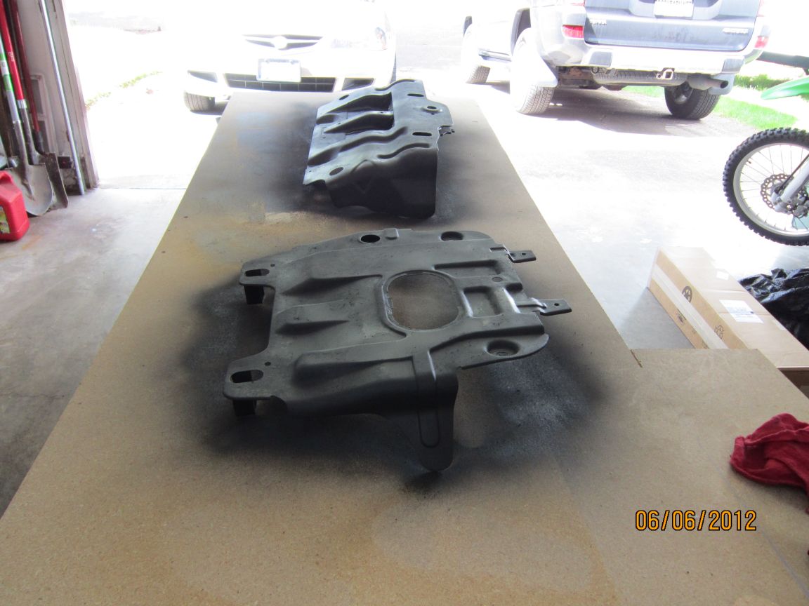

I put a 4 1/2" wire knotted wheel on my angle grinder. It took the rust right down nicely. My first 4runner was owned in NY for 6 years and was nasty. After that I sprayed 2 coats of auto primer in the rattle can. Then I sprayed two coats of under body to it. It looked pretty good. It's under the rig and going to get nasty over time. I considered color, but couldn't see the skids all that easily unless I got down to look under.

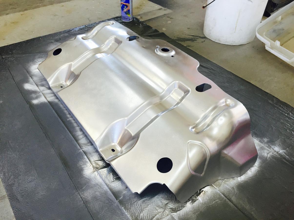

I painted my silver metallic this afternoon. I'll post pics when I get it back on my 4Runner.
