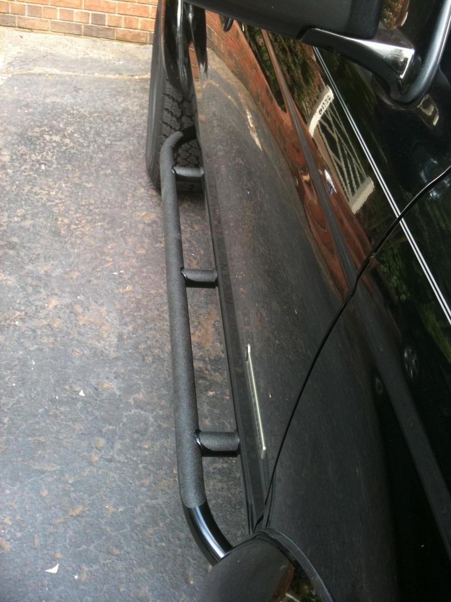

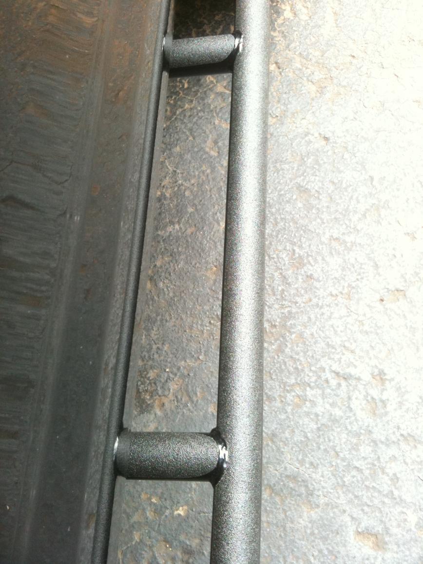

What I did was wipe them down really good with Denatured Alcohol, then take 320 grit sand paper and scruff them up a bit, then wipe down with denatured alcohol again.
I used the Rustoleum Professional paint and primer.
I put on a first very thin coat of primer, wait about 5 minutes then another very thin coat, 5 minutes then a decent coat, wait 10 minutes then another good final coat of primer.
Then do the same with the Black, 2-3 very thin coats then 2 or 3 decent coats.
Then use the non skid tape on the entire top.
Did mine 2 years ago, still looks like I did it a week ago.
Did you paint yours on or off your 4runner?
