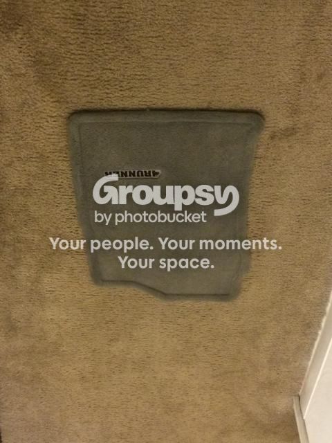

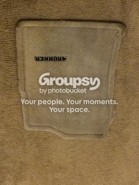

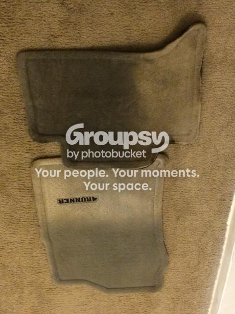

So I decided to test it on the carpet mats first before attempting the carpet and it came out excellent actually. It looks a bit discolored in
photo3-4.jpg~original
the pictures but in person it's an even coat and you can't even tell it's painted. If you do paint, DON'T get the duplicolor paint. Go and get the SEM. It's closer to factory, although I was not able to find "factory" match. SEM coats better, it looks better, and it feels better. I can tell it's a higher quality dye. Here are some pictures.
photo1-5.jpg~original
The bottom image is the finished product. The one with the rear carpet mat, is done with duplicator, you can see that the SEM on the top carpet is much better quality.
