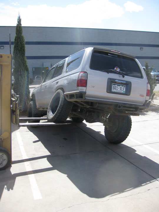

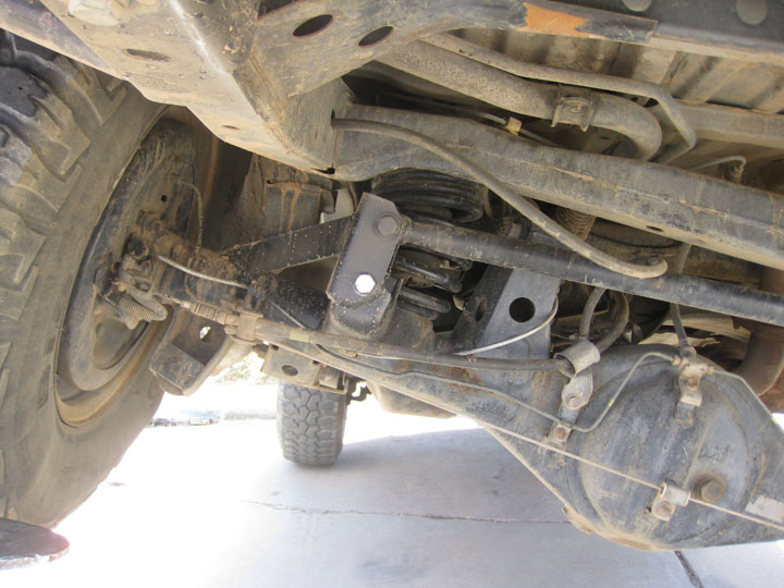

Well i left my SD card in my computer yesterday, I was just so excited to go wheeling after installing my pan-hard lift bracket?! lol
So since I had a camera but no memory card on the trail I decided just to lift it again with the forklift. Here are some pics!
I am running 255/85/16 right now, and I am seriously considering going up to 295/75/16 for my next tire, but as you can see from the pics that the back-spacing on my rims are perfect for 255s, but I would probably have to trim an inch outta the wells just to make sure they clear w/o rubbing since the 295s are about an 1.5inches wider. I know I could go with 285s, but my philosophy is never go smaller...go BIGGER!!!

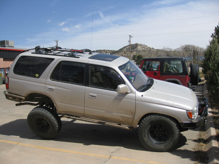

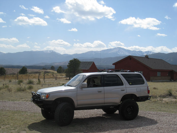

A few pics of her all cleaned up too.

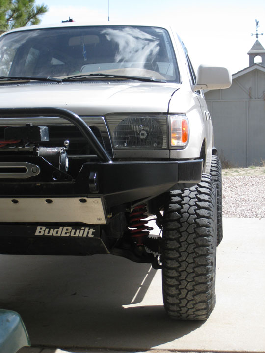

Neither do I, but you've got some nasty camber in your last picture of the front end. It appears to be sitting level but I could be wrong.
No, you're totally right. I jacked up the coilovers after getting an alignment and that is the reason, so yes I do need an alignment.

I know I'm reviving a dead thread here, but I'm curious how your panhard lift bracket has held up over time. Looked like you had that guy pretty well braced.
Hey man,
I just have to say thank you for reviving this thread! I now own [MENTION=59241]builditbreakit[/MENTION] 's 4Runner, I have not changed anything on the rear suspension and the left side pan hard bar relocation ("lift"?) has held up really well, I wheel the heck out of the runner and haven't had a single issue with it. I bent a track bar at one point and thought it may be the pan hard bar but just replaced the track bar and back to smooth riding it went. Having ridden in a normal drop bar setup with a similar runner I will say that mine seems a little more solid in hard corners (I drive the thing like a racecar...)
