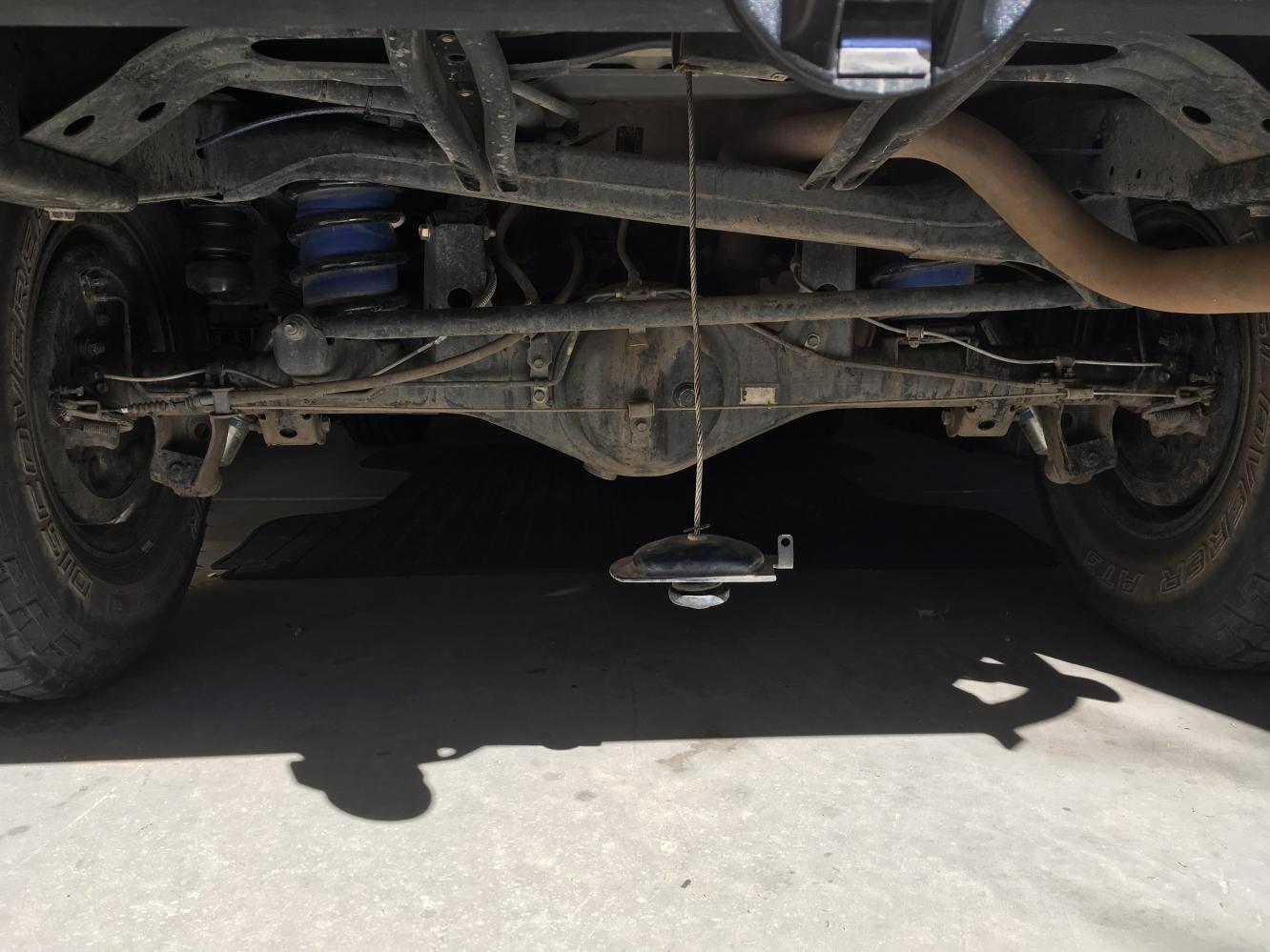

I have a 2 in lift and attached is a pic of my panhard bar. Will it be beneficial to put eimkeith panhard bar correction kit on?

Yes.
(but don't take my word for it) ;)
in all seriousness, I designed the pck for folks like you and I who have 2-2.5" of lift. the core of the kit is the axle-side bracket which lifts the panhard 2" - the frame side bracket is for the rest of the planet that likes 3+
Still a correct one though.
I've said this a lot but I'll say it again.
The PCK should be a must have for any lifted rig. It greatly improves the handling of the rear of the vehicle and also returns you to stock geometry.
Do it.
100% correct. I bought 2 kits for my 01 and 99
Since I have a 2-2.5 lift can I just order the axle side bracket or does it come as a kit?
It comes as a kit. The frame side allows the use of the stock hole, though - so you can run that side at zero lift but still have the additional height selectability down the road when/if you need it.
If it were my rig then I wouldn't worry about it on such a minor lift but I would loosen and retorque the trackbar bolts to get the slight twist out of the rubber bushings.

Highly recommend [MENTION=28464]eimkeith[/MENTION] panhard correction. Had integrated metalworks install this over the weekend. Tremendous difference in handling. No more VSD warning in relatively simple right turn corners. Highly recommended for any lifted Toyota.
My bar was at a slight angle at stock, i now have a small lift and it's almost at the same angle, rear axle is centered, seems to me I can send back my SRQ panhard correction kit and buy something more necessary. When I put the bar back into place, there was no heavy-duty strong arming, it nearly went back in with no issues. I have a Bilstein 5100 with OME springs, like 1-1.5" lift, doesn't seem to be an issue at all.
My bar was at a slight angle at stock, I now have a small lift and it's almost at the same angle, rear axle is centered, seems to me I can send back my SRQ panhard correction kit and buy something more necessary. When I put the bar back into place, there was no heavy-duty strong arming, it nearly went back in with no issues. I have a Bilstein 5100 with OME springs, like 1-1.5" lift, doesn't seem to be an issue at all. For reference, this is my 1999 4Runner SR5, not the 2024.
It is mathematically impossible for the panhard & axle to be in the same
angle/location after a ride height adjustment.
Personally, I don't feel there is a better solution than Eimkeith's
for keeping roll center under control and the axle where it belongs
using factory link/spring locations.
