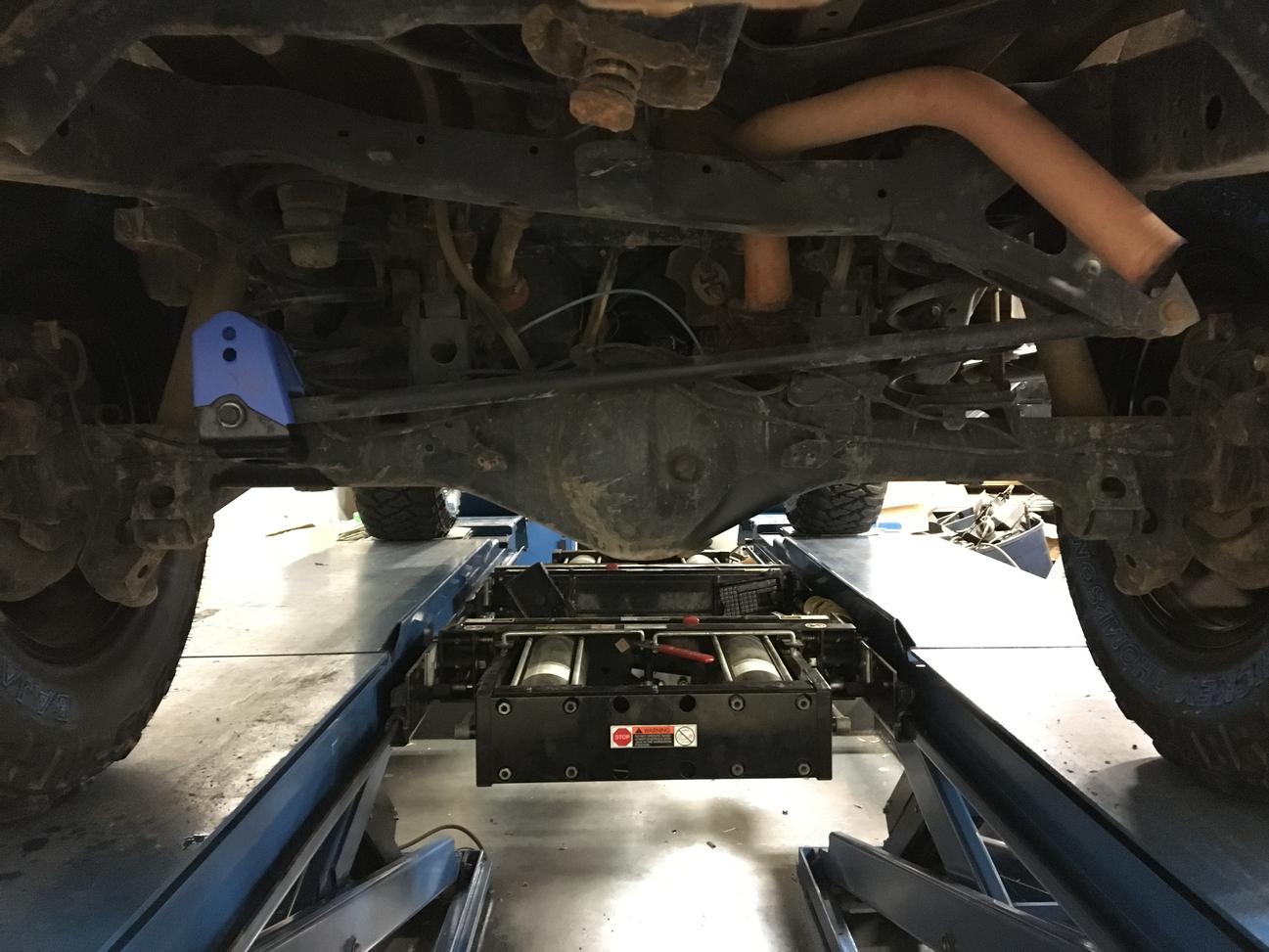

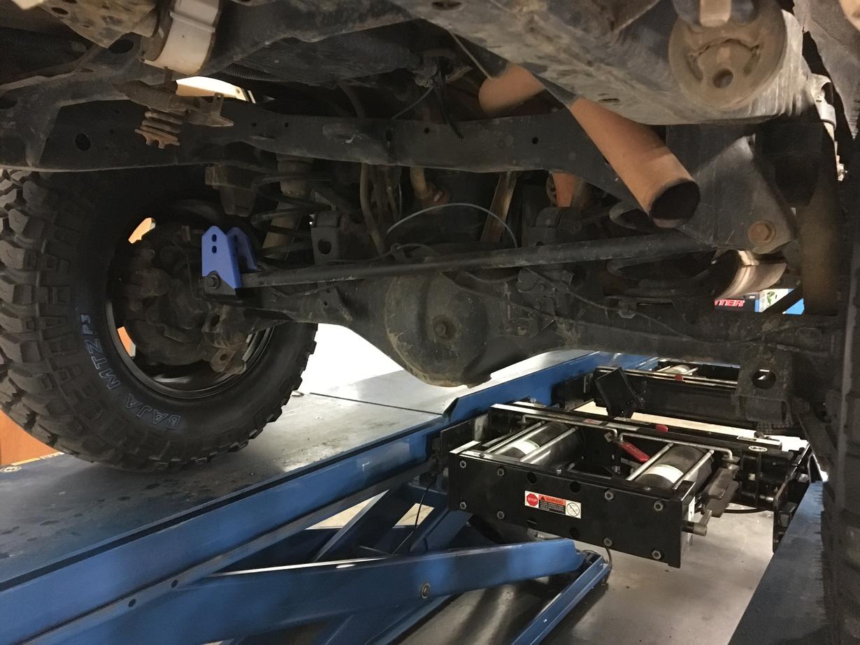

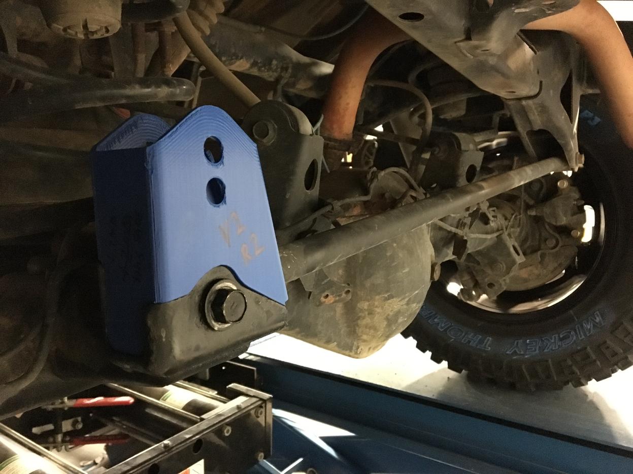

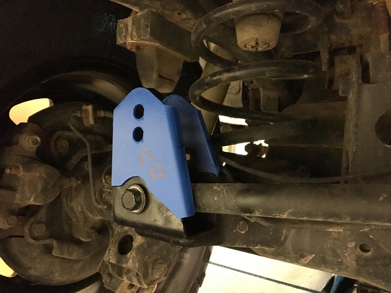

so I borrowed Austin's 4th gen and my 5th gen PCK just plopped right down in position (it's blue because it's the 3D printed model - the actual PCKs are being cut and bent right now)
You can see how extreme the panhard angle gets on these lifted trucks - and how the upper hole is going to resolve this on Austin's truck:

Great illustration of what a big difference it makes. Definitely definitely on the shopping list.

How much rear lift does Austin's truck have?
Austin will have to answer as to how much it is supposed to be, but it measures out to 105 unladen (basically 4")
