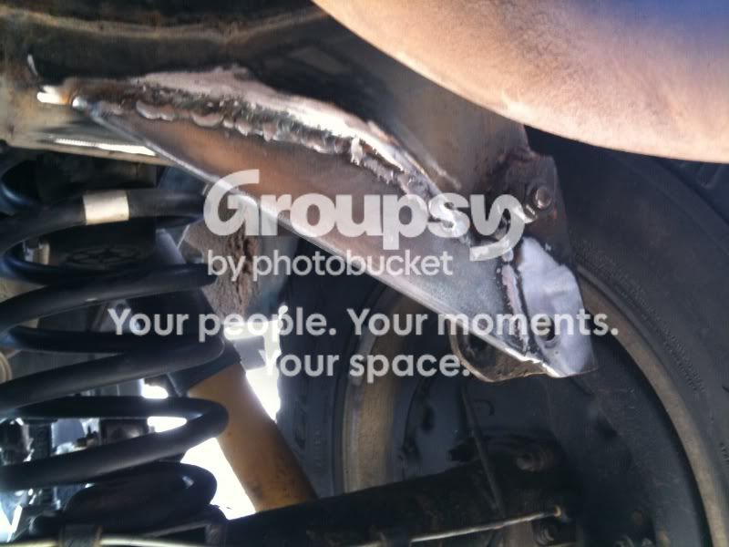

Definitely weld the bracket on. Some of us have cut a brace and welded that on to brace the drop.

Brace3.jpg~original
