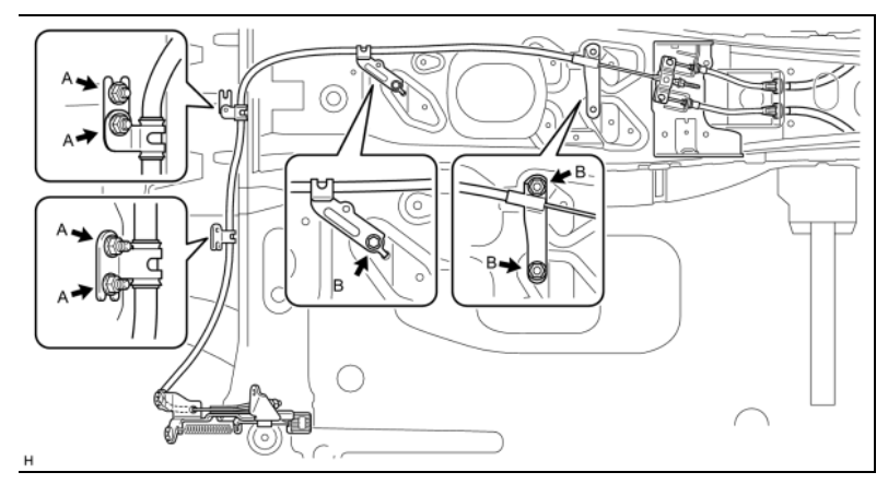

I used my parking brake for the first time in awhile last weekend and my milage suddenly dropped from a normal ~15-16 mpg around town to ~13mpg, and the rear rotors are hotter than the front - so I'm thinking the parking brake is dragging. I'd like to try a quick fix until I have more time / better weather to address it.
Before I go crawling around outside in the rain does anyone know if the transition point from the single cable in front to the two separate cables in the rear (one to each rear wheel) is on the inside of the vehicle or the outside of the vehicle? Manual sort of makes it sound like its deep under the center console and hard to get to.
Thanks
Under the center console and easy to get to (removal of the center console trim is easy.)
