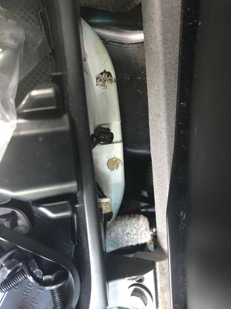

Cup Holder Lamp and Location
Figured I'd throw a picture up of where that cup-holder bulb is located for anyone looking for it. Turns counter-clockwise about 1/4 turn. Bulb is apparently a #37 lamp (same as glove box light bulb) and there is an amber (orange) "rubber" on the bulb that would need to be transferred to the replacement bulb. I ended up going with an amber (#74) LED bulb from VLEDs.com
