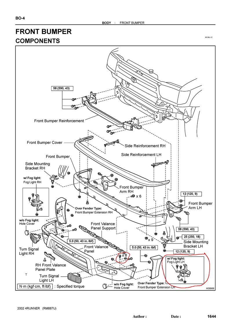

Hello guys,
Does anyone know part numbers for the bolt and the clip-nut that hold the fog light assembly to the front bumper? Thanks.
Thanks Leon.
Don't see them on that diagram. They might belong to front bumper assembly.
The bolts are part of the bumper. The part number for the nut in the diagram is 90080-18071. I’m not sure what the part number is for the plastic clip. The oem clip on my fog lights are red. Pretty sure you can use a generic plastic clip from any parts store that will fit the diameter of the hole if you don’t have any luck finding it at your local Toyota parts dept.

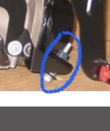

Instead of starting a new thread I thought this would be the best spot to try to get help. Looking for the fog light adjuster screw, spring, and nut. Anyone have any part numbers or sizing info? The nut is the biggest thing I need.
