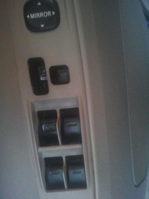

My problem is that the part of the door panel that holds the electric window buttons and door lock, is broken. The panel of buttons for the windows and door lock is falling into the door.

Do the windows all work from that panel? Could be a bunch of things...
zopperman. yes all the controls are working perfectly, no electrical problems.
It is just that the whole cluster of controls is disconnected from the plastic door panel piece that holds them up.
I can actually still use the window buttons and such, it is just that it is slowly slipping into the door panel.

pics?
i think three screws hold it in place, one could just be loose or stripped out f the plastic hole
Here is one.

I took off the complete door panel and, of course, the plastic is broken off of the part of the panel that holds the window controls up....
Does anyone know where I can buy the part or at least get the part number for the driver's door panel part that the window control cluster is screwed into?

how about some super glue?
or if you have a soldering iron you can melt the plastic back together. thats what i did
if i remember right that panel isnt separate. You'll have to either melt the plastic or find a screw that works or even super glue.

Thank you for the suggestions...I have gorilla glue here and I may reinforce it with wrapped metal twine and glue.

Post a pic of the broken piece.
I'd try to melt it together
The resolution of this issue!
I gorilla glued it, the whole window button mechanism to the door panel. I found screws that were abut 16" longer and forced them into the old screw holes (with gorilla glue in the holes). Its still holding!!!
