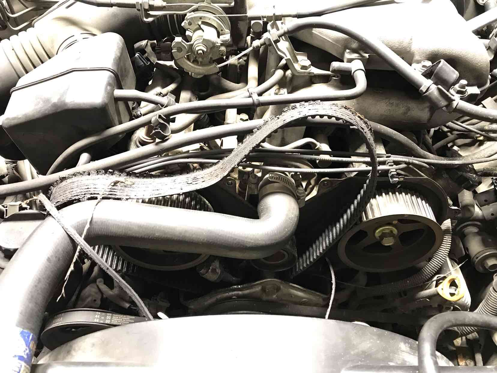

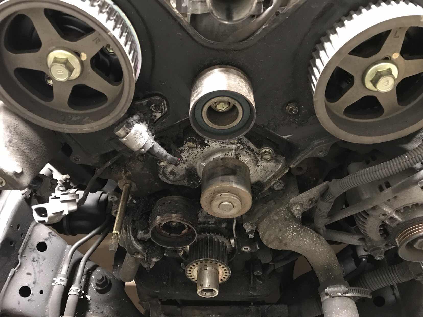

Geez !! Simple answer do your seals, tensioners while your there. Why pay double down the line for 50.00 worth of seals? Seen a couple of people regret this pic on one attached

View attachment 279831View attachment 279832
Are those pics a result of a seized water pump or idler?
