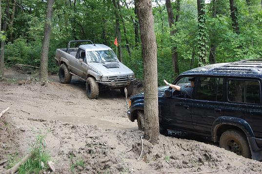

Do you still have the 1st Gen? If so, it would be cool to see some pics.
This is one of the last pics I have. Thought I wanted to go a different direction and I traded it back in 2010 for 94 fzj80 with dual lockers. Wasnt feeling the 80 and I switched jobs and company car was gone so I sold it and picked up my 3rd gen instead for a DD and hitting the trails once in a blue moon.
Looking back I probably should have kept one or the other. But now Im thinking of picking up a new DD, keeping the 3rd gen and throwing a radius arm SAS under it or getting a uzj100 and do a radius arm SAS under that.
