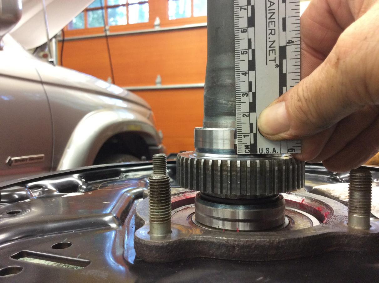

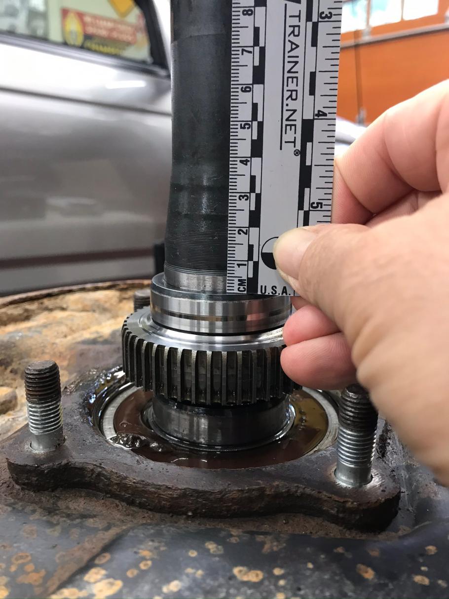

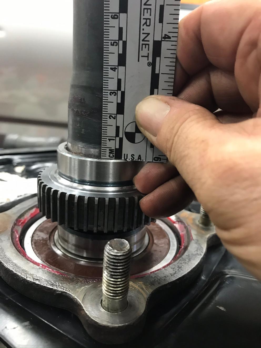

Did you flip your retainer? My machine-ing around where the polished started was so uneven, the machine shop didn't know where to measure the 5mm. I ended up with 622mm from the spline end (they normally measure from the there 24.5" which is about 622.3mm)with about 3.5-3.9mm showing with the seal smack on the middle on one side and the other side they initially only pressed to 621mm and it rubbed against the axle housing protrusions that protected the seal. It did ride on the center of the retainer though. So its that close. I had to have them press it a little bit more and its not riding smack in the middle but good enough.
I flipped the inner retainer when i replaced the seals, etc.
Below are a couple pictures with measurements showing before & after as well as results of “sharpie” test to confirm proper placement of flipped inner retainer.
