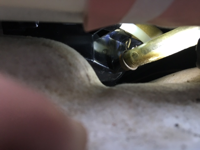

What I found was that the drain hose came off of the sunroof drain nipple. You will need to remove the sun visor and grab handle to allow you to pull head liner away far enough to get to the drain hose. It is held on with a small clamp. see attached.
