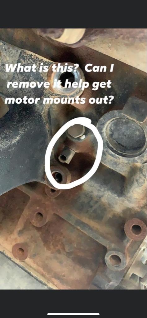

What is this and can I take it off to help get some room to remove motor mount? I assume the bolt above it holds it in place?
Edit: that is a block coolant drain petcock type thing the bolt above it open the port.
Why are you removing the motor mount bracket off the block? You can remove just the motor mounts with the right tools. For that 17mm nut that bolts the motor mount to the motor mount bracket, a 120 click point 3/8" ratchet is super helpful and basically makes it possible to get out.

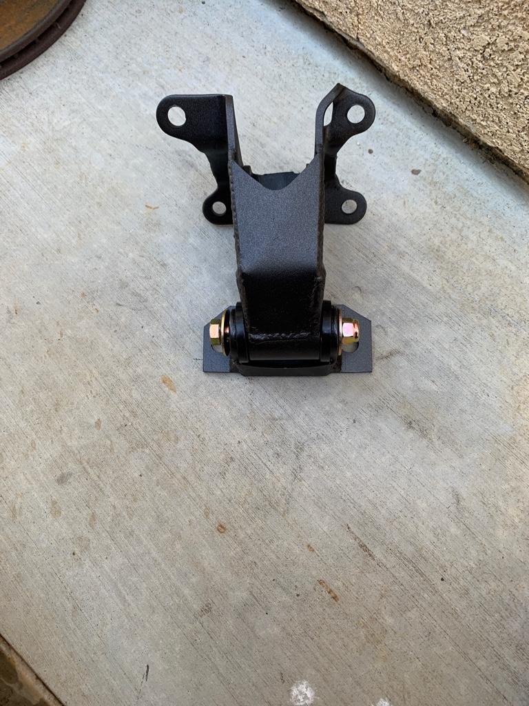

Cause I’m replacing them with these from solid-Offroad.com
Ah, I see. If those are poly bushings in those mounts, you're going to get crazy vibrations and noise into your cab. I have Trail Gear poly mounts for the the 22RE engine in my 85 4runner and it's louder than shit and sends engine vibrations into the frame rails. You might quickly learn this was a big mistake unless you plan on cranking your stereo everywhere you go.

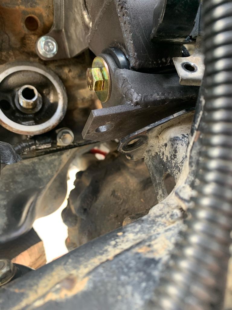

I can get it in the hole and on the nut but my motor mount flexes to much to ratchet. I need to get my dad or another hand next weekend to help me.

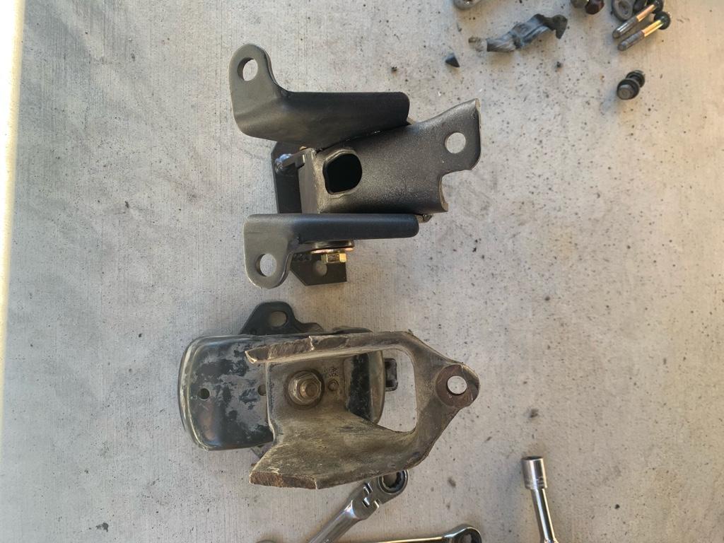

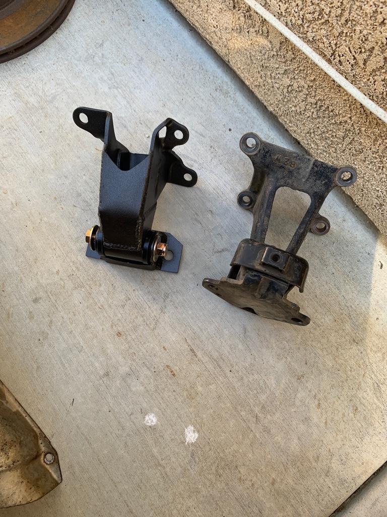

I dunno how to post a video but the reason everything flexes so much is my actual motor mount was broke at the block. Fun stuff
Bottom ears on the stock motor side of the mount were broken off, wonder when that happened...? Or wonder how long it’s been broken haha.

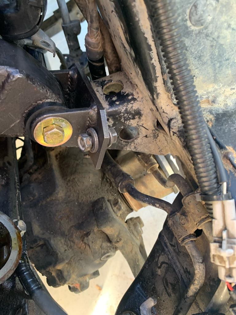

Well something isn’t right... driver side doesn’t line up even close at the perch. Not sure what’s bent or tweaked but next thing to try to do is loosen passenger side and put the driver side on first
Finally got it all in place and buttoned back up. I took the trans mount and passenger side punt off and was able to wiggle, pry and use a floor jack to get the motor mounts in place.
Solid 10-12 hours on this. Not fun but I’ll put it back to tether tomorrow after putting some other new parts on and doing an oil change and see if it feels any different in a drive.
