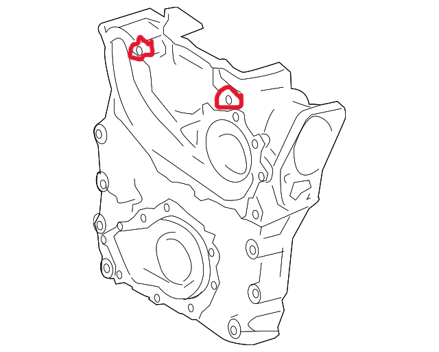

I'm doing the waterpump on my 3rz and I removed 2 or 3 bolts that I thought I needed to but didn't. I completely removed the bolt near the base of the dipstick tube.
I also loosened the nuts above the water pump (if we're going by shape, the one above the head and balls). I circled them in this diagram.
I didn't remove something holding a part in place inside the engine did I?

I don't have a 3rz, but you should be fine as I suspect they are just the timing chain cover bolts. I know someone else will chime in but I'm guessing they will be 14-15 ft-lbs for torque.
