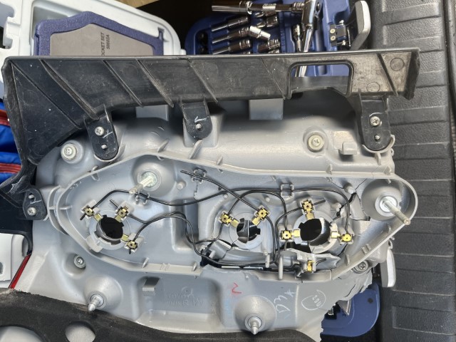

For anyone that cares, here is the backside of a taillight.
All power comes from one socket, so if it fails as in the pic, there is nothing.
