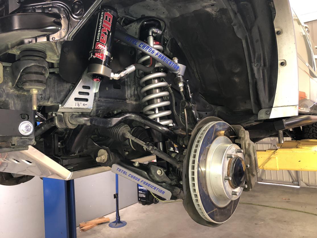

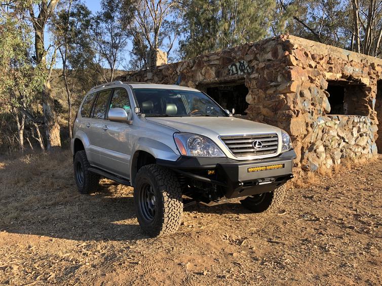

Front Suspension:
TOTAL CHAOS Fabrication UCA's
Elka Extended Travel 2.5" Remote Reservoir Coilovers with High and Low Speed Compression Adjusters
TOTAL CHAOS Fabrication LCA Skids

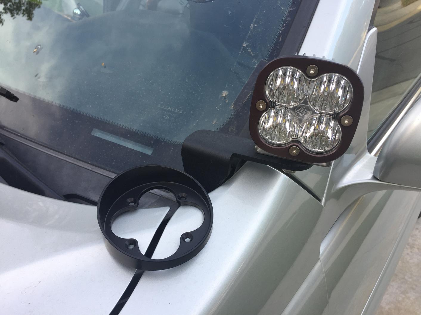

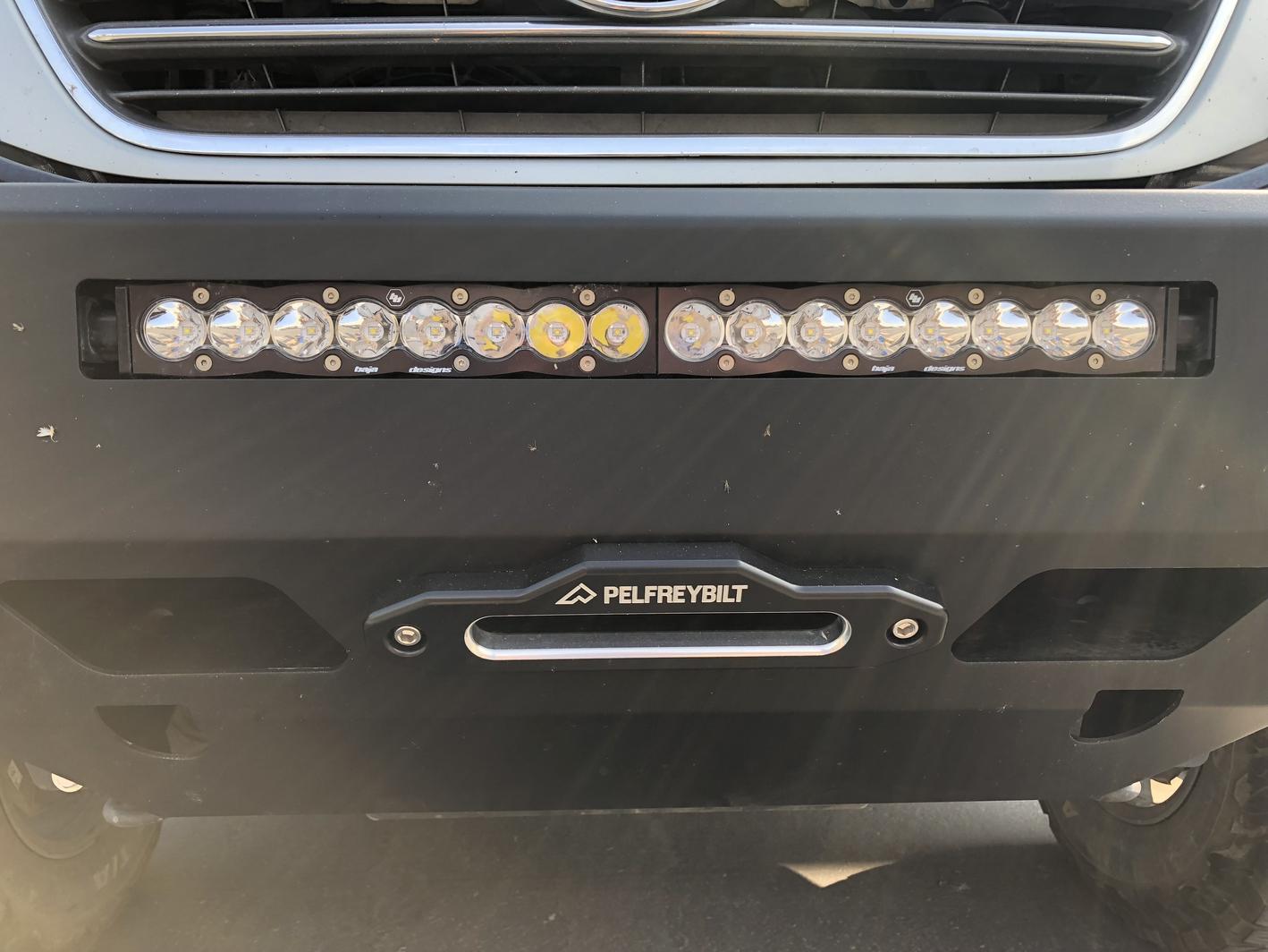

Lighting from Baja Designs:
20" S8 Bar in the Bumper
S2 Sport Fog Lights
Squadron Pros with Fog Pocket Kit Bezels as Ditch Lights on CBI Mounts
Rocklights wired into the stock running board courtesy light wiring and attached to the sliders

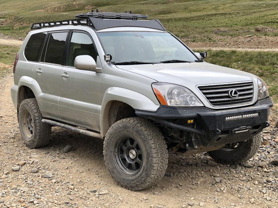

2,250 miles post-install shakedown run to Montana and back:
