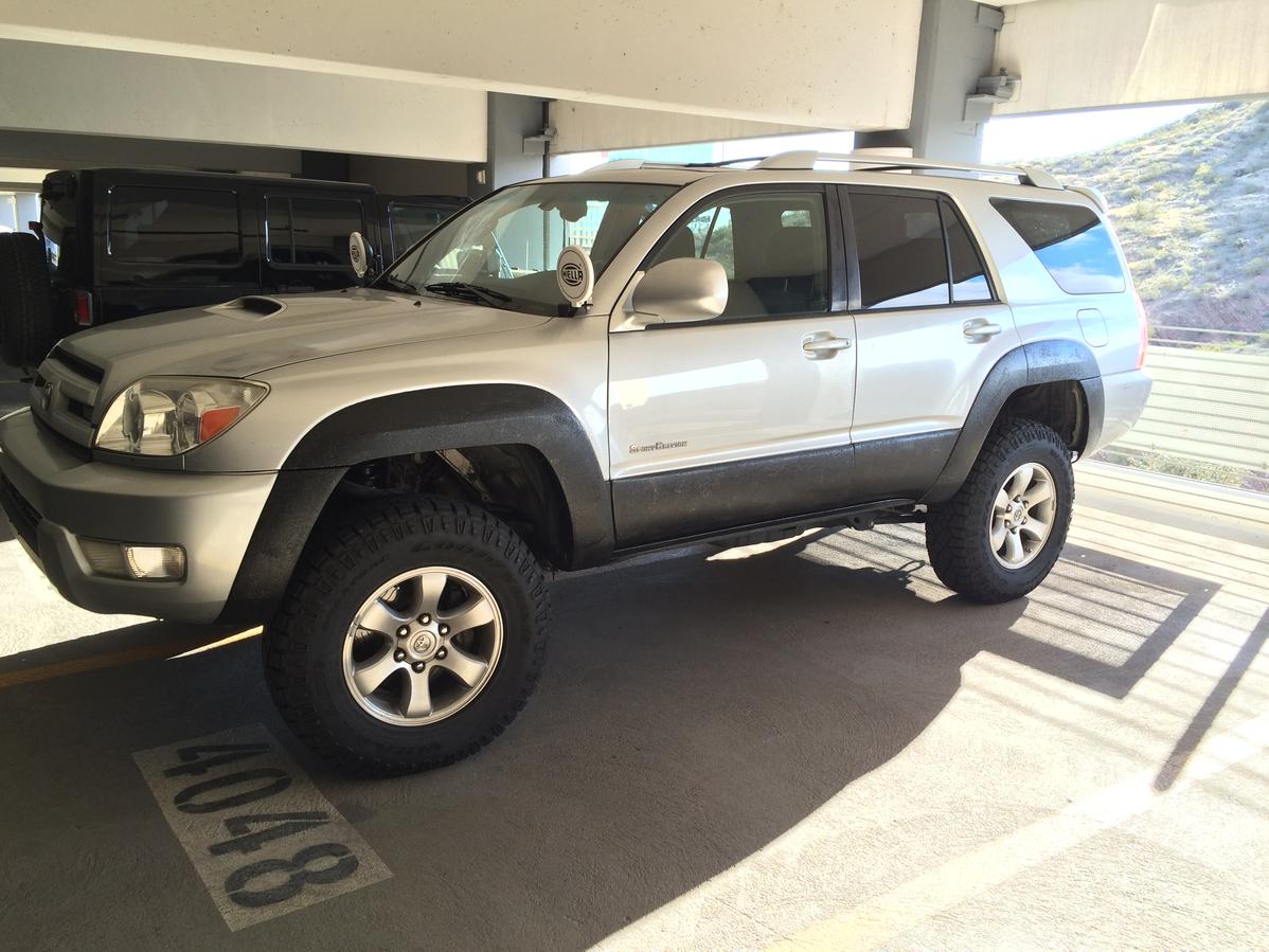

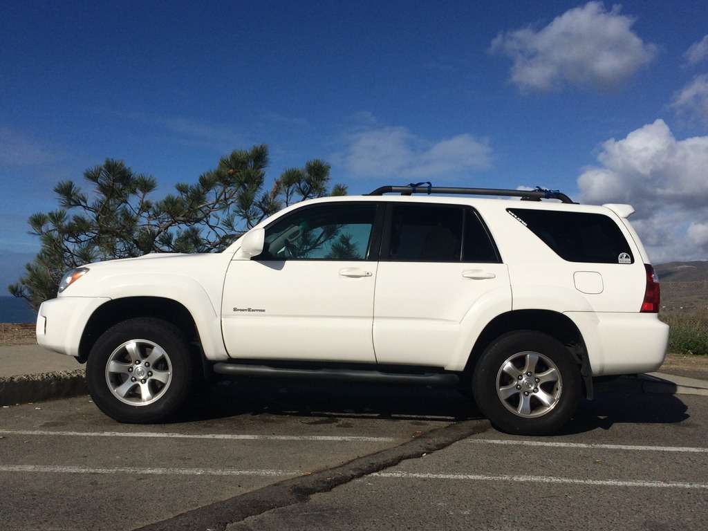

Did you get any before and after measurements? Looks like you're running ever so slightly high in the front, but that may be camera/parallax tricks...
4" of lift compared to old, worn out springs with a V8 @ 128k miles.
And yes, all numbers were in green
Well that's good news to me. I'm about to put the same spring combo ( w/ 5100s ) on an 07 V6 4x4 with 138k miles. I was concerned about alignment issues.
I think if you're under 3" you're usually fine... my 885's are usually good for 2-2.5" over stock (again, not sagging) so if you keep yours at the stock or first notch you'll probably be OK. That is a pretty heavy spring for a V6, do you run a big front bumper?
No. This was suggested to me by several members here. I think the major difference between you and I is the shocks. Hopefully the adjustability will allow me to run these springs safely.
Sort of. I took before measurements. And then lost the piece of paper. :ybrick: As close as I can tell by measurements, my rig is dead-nuts level. Must be the camera.
That stinks and is exactly a reason I have a corkboard in my garage :)
I straightened the pic of your truck and you do look at 100% level too. Looking sharp, how do the Bilsteins ride? 52e2d1c3edda602c06d8b05163a8456c.jpg

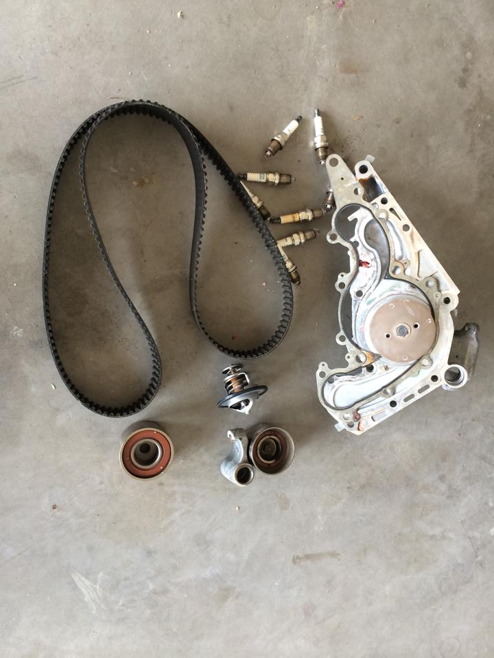

Timing belt + components, w/p, t-stat, drivebelt, idler, and spark plugs last weekend (7/5/14):
Thanks to [MENTION=99491]Bumper2Bumper Auto[/MENTION] (and $540!)

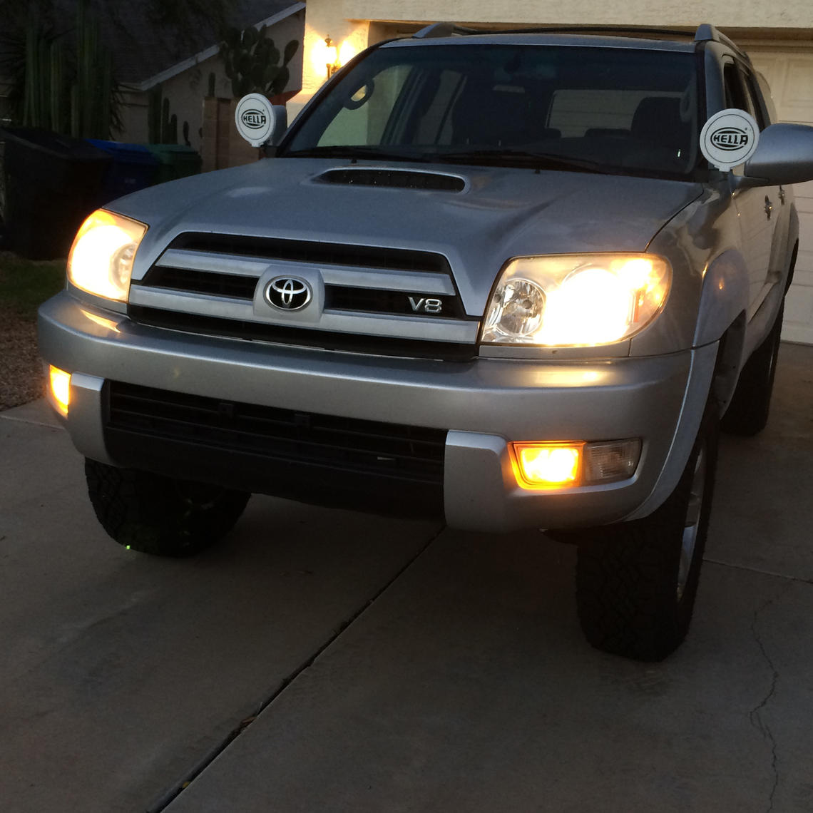

Optilux XY Yellow Fog Lights
I'm really liking these Optilux Yellow XY fog lights, especially considering I got a complete set for the same price as an Sylvania replacement bulb (one burned out recently)... obviously in the desert we don't have much fog but I do like the color and Gran Turismo styling :jk:
http://www.amazon.com/gp/product/B002E2UK8O/ref=oh_aui_detailpage_o07_s00?ie=UTF8&psc=1
I think when I mod the fog-light operation, these will become my new driving lights. Bright enough for the AM hours without being too bright.
Did I mention they look pretty cool?

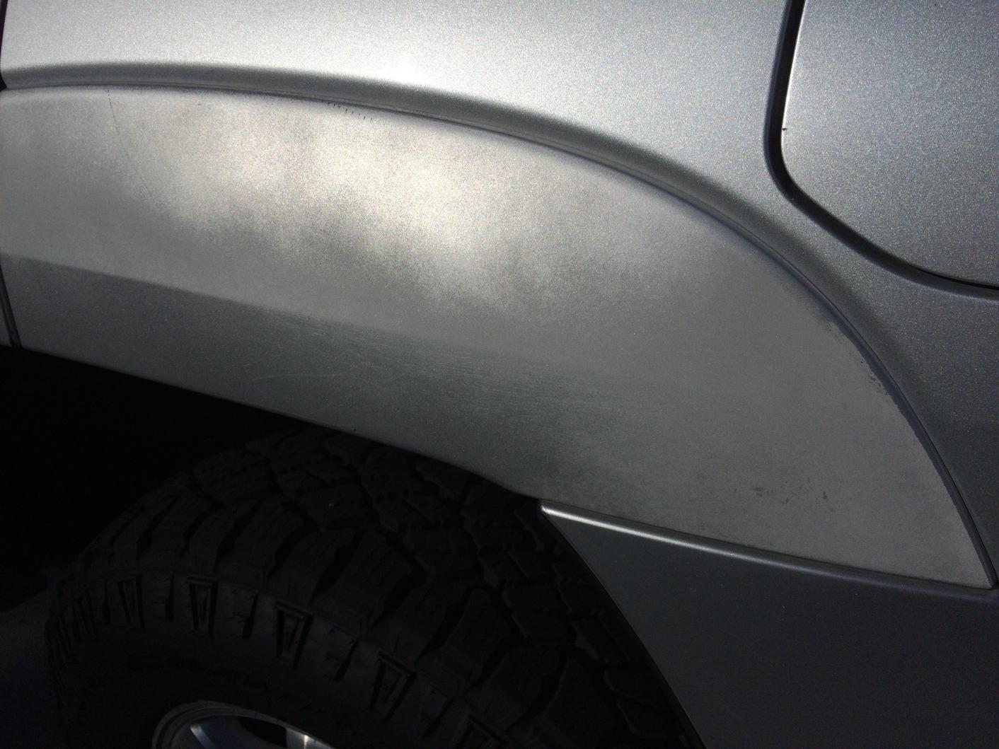

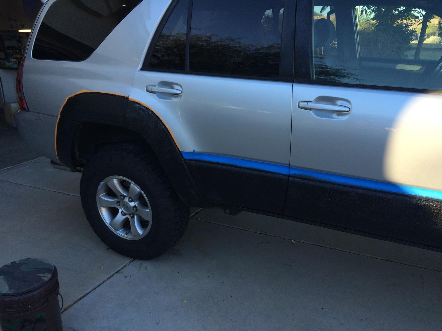

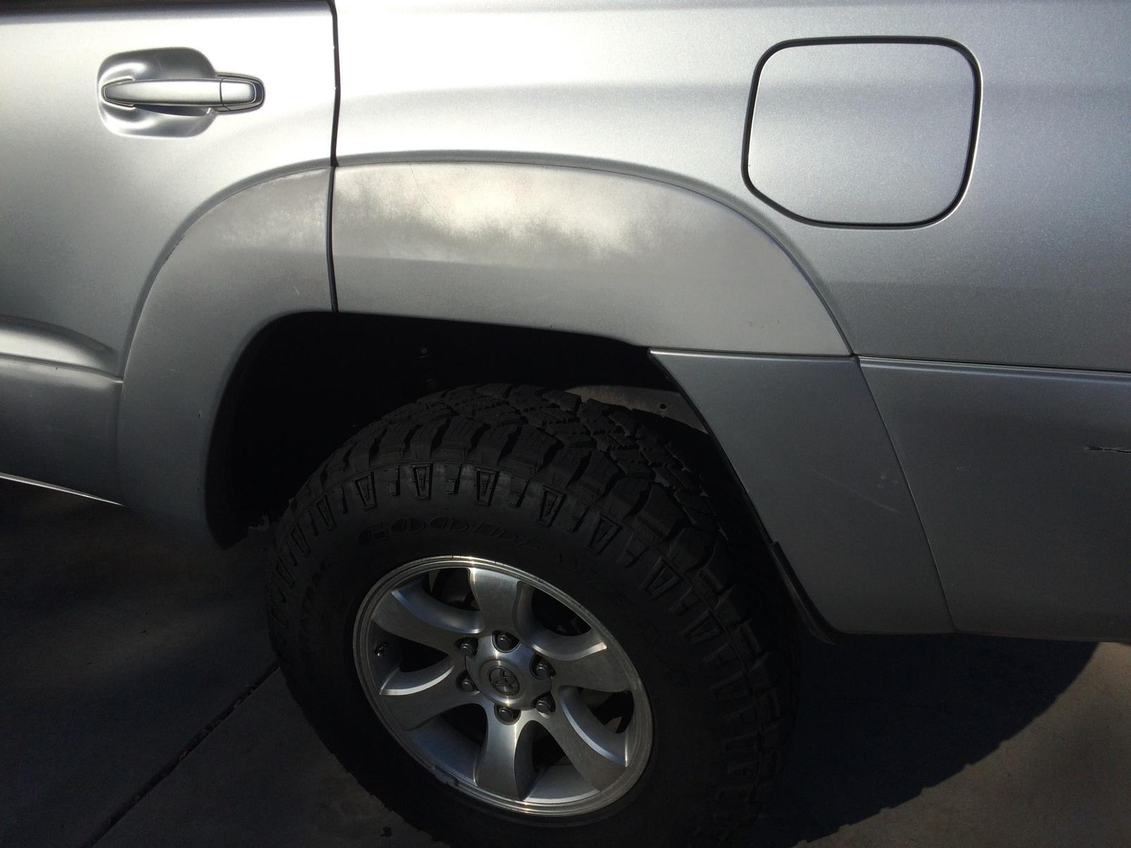

So, like 95% of the silver/light colored Toyota's in the desert SW, my flares and cladding were terribly faded. I wasn't going to pay $$ to have it touched up, so I did the next best thing - Herculiner :)
Overall it took about 4 hours to do, including sanding, cleaning and application. I still need to put another coat on (I ran out of time!) but I did manage to put a second coat around the edges already so I won't need to retape (should only take about another hour now).
Overall I'm pretty happy with it, though I still make end up getting some grey plasti-dip to make it look better. I don't mind the contrast and perhaps it would look better with some black/charcoal rims.
As a note to those in dry climates, this stuff cures with moisture and thus will remain tacky for some time. Mine is going on 15 hours and is still a bit "sticky".
