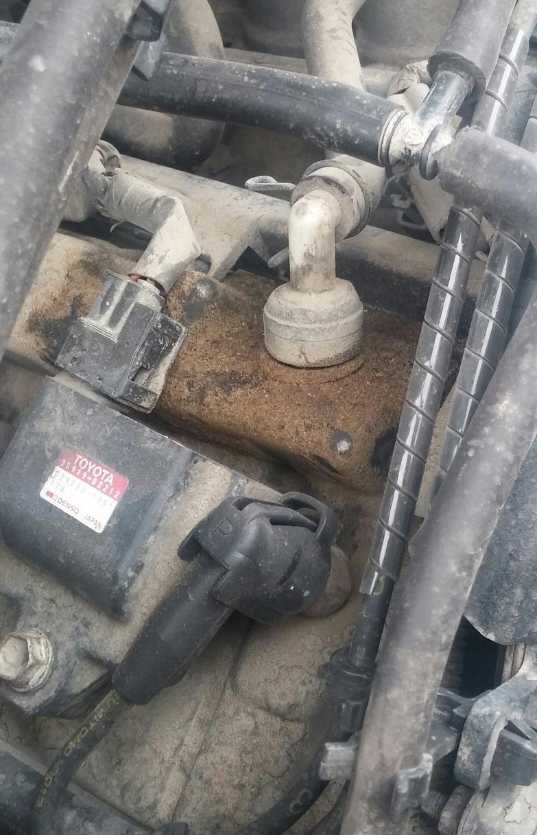

Time to replace? (Pictured)
As far as I know its original. I really hadn't heard of this until lately. I guess I will replace this week.
Does the oil around it mean anything in particular or just normal after awhile?

Looks like you need to power wash the engine first. The grommet will need to be replaced to stop the oil leakage. use needlenose pliers to pull it out. The easiest/safest way is to use an exacto razor to put a vertical cut in the grommet and then with the pliers, pull one end out and rest will follow. It may break apart when you pull out the PCV valve.
I wouldn't worry about the mud.
My rule of thumb is an OEM/OEM maker PCV every 100,000 miles. If it were a $60 part, I'd have second thoughts. But for $6 and change, why not. Given my little amount of blowby, I have the PCV running into a catch can, then it works its way to the intake manifold.
If you decide to remove the grommet, be careful. Or pull the valve cover and remove it like such.
You said What? I would rather drop a chunk of rubber grommet in the valve cover than any of that sandy muddy crud. The rubber will sit harmlessly in the baffle, whereas the "mud" with disolve and flow all over the engine. Bad advice. If someone started a post with that statement, I would completely disregard everything he Ever said past present and future!
But thats just me.
LOL
Thanks guys . so basically wipe the oiled mud before doing anything to the valve. That's easy.

I assume the T-connection is for the K&N as well. I installed it over 7 years ago and haven't messed with it except to swap and clean the filter.
