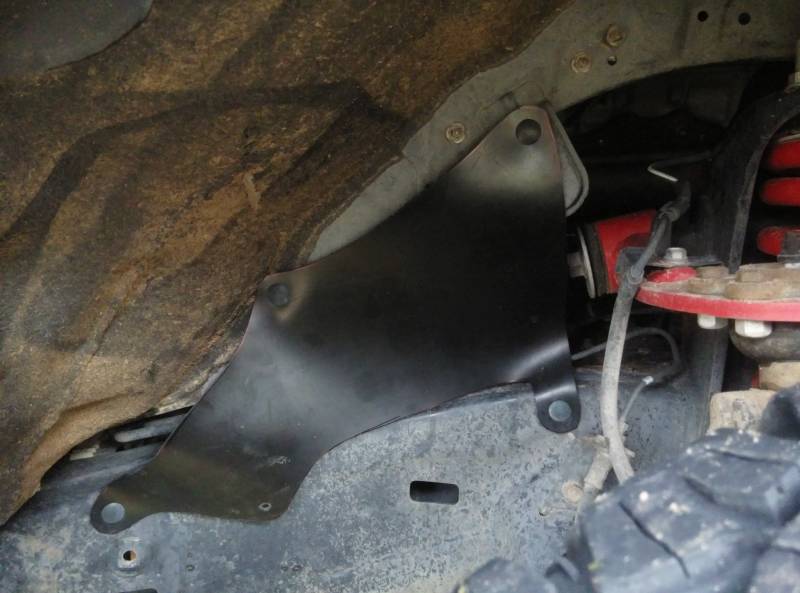

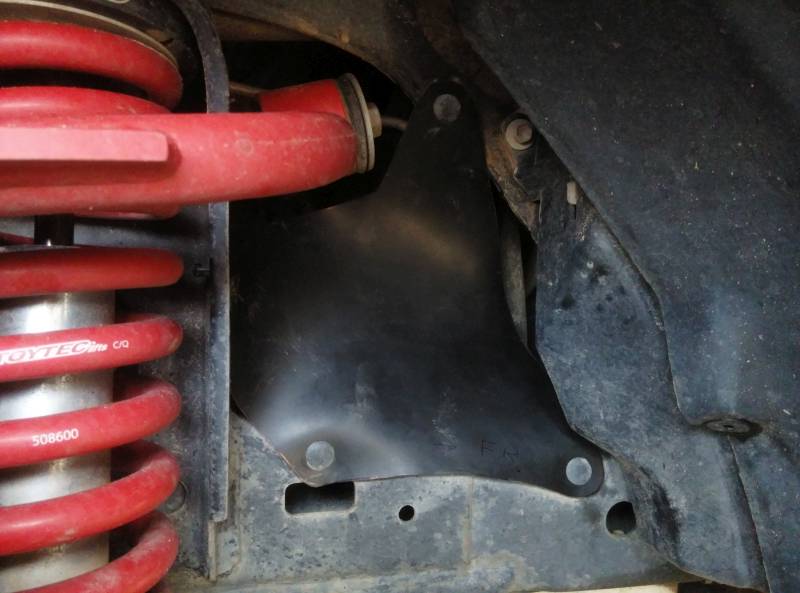

Hi,
New here..
any chance that the templates are similar to Prado KDJ120 (03-09)??
if not - any ideas where would I find matching templates? I looked everywhere :(
TNX a lot anyway.. great site!

[MENTION=145671]BagiMT[/MENTION], thanks for the Amazon link. Looks pretty stout for 1/16" thick, is that what you used? I see it also comes in 1/8".
Yes, I got the 1/16", is plenty strong and works with stock fasteners. The pictures looks thicker than it is, but 1/16" is thicker than the stock rubber.
