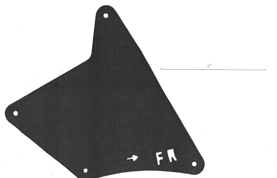

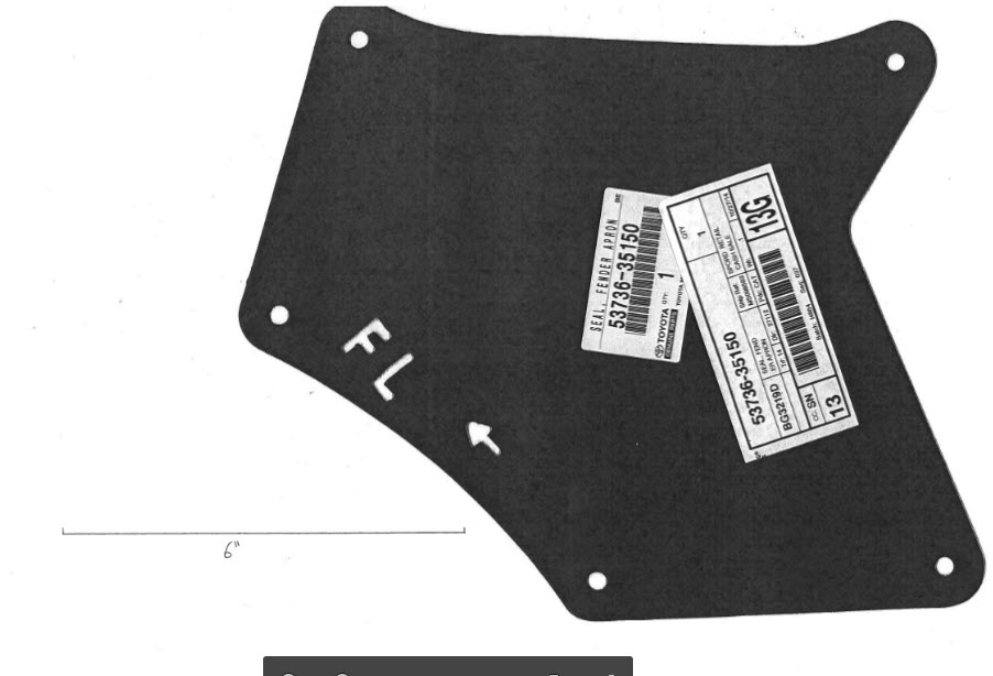

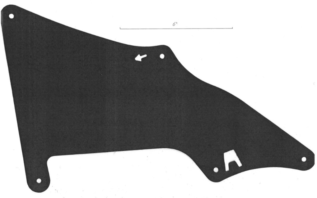

I found a nice PDF on here for the front wheel well liners. I'd like to cut my own from some neoprene rubber material. I've scaled the PDF and sent it to my plotter. Very handy resource!
The PDF I found was for the 4th gen, but looks very similar. Does anyone know if the 5th gen pieces are identical to the 4th gen?

not the wheel well liners, but the flat rubber aprons that separate the engine compartment from the wheel well...
