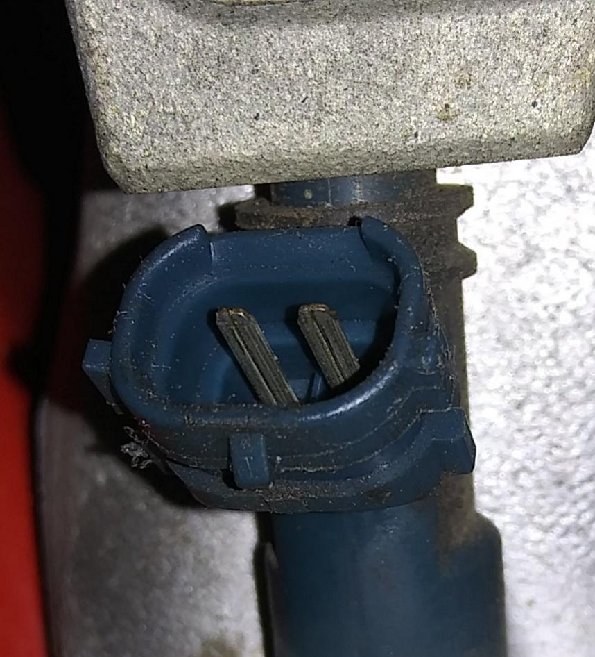

Here is a pic of the connector on my old injectors if it might help you ID the right one compared to yours.

Good to know and i'll definitely give Keith a call and see what he says. :D as for the MAF calibrator, it had to be spliced into the harness.

I ordered the 270s by mistake and he suggested that it might be running lean with the headers anyway, so I decided to get the adapters. Glad I did.

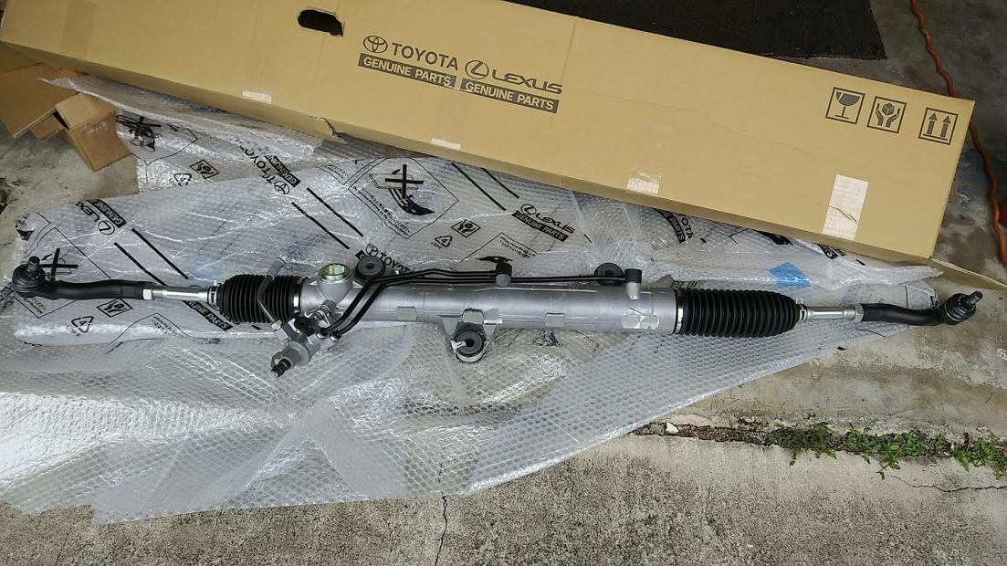

I'm officially a fan of McGeorge Toyota. Ordered a LC 200 rack on Saturday Morning, received this Morning-5 days. Pretty good discount and a free shipping coupon also. Now to figure out how to fit this thing and make it work with my DK LT. I will be asking a lot of questions of some more knowledgeable people for sure.

Awesome to see these LC rack getting more traction (and hopefully documentation ;) ) on these rigs! Can't wait to see how yours goes.
Between you and Inv4drZm taking this on I think it will pave the way for the rest of us to gain confidence in doing this swap.
Definitely on my 'to do' list as well. Interested in seeing what documentation you guys come up with on your install. I need more BEEF!

These racks are just massive compared to the factory one. It's hard to believe this swap is just now catching on, its not even that much more expensive than a factory rack. Then again, 37's are new to our ifs trucks as well.
With these and tie rod upgrades we may not have an issue with steering failure on a trail ever again.

Well I am officially over my head on this one (DK +3.5 - 4:56 rear end swap w 14" bypass - front gear swap - Man T-case swap - 200 rack), but I'll try to get as much documented as I can. There's a 4th gen guy (Wishbone Runner) on Taco World that is looking to do the 200 rack also. Not sure if he is going RCLT, but between him and [MENTION=130999]Inv4drZm[/MENTION], I'm sure they will be way ahead of my build in their timeline, unless Mike's wait time on his kit causes them problems. But, both of these guys are way better at the documentation and welding than I am.

This 200 is a beast. It feels like it came out of one of those Toyota buses you see in the islands. I may be one of the first to match this up to a DK LT kit, but it should be close to the TC kit that Sherpa put their 200 on.
You're right they aren't that expensive at least currently. Got mine for $487 w free shipping. Toyota parts might just be good hedge against this damn inflation we're seeing.

[MENTION=130999]Inv4drZm[/MENTION] Now for the next question Mason, will our oem pumps be able to handle the volume?
According to James' measurements, the LC stroke is a hair shorter, but the larger rack has got to hold a pint or two more fluid.
It should be fine, I haven't heard Marlin or anyone mention that.
Would be nice to upgrade the fluid capacity though to be on the safe side. James on the FJC forums did with an aftermarket reservoir.
Or if you had a ton of money burning a hole in your pocket just buy the JD Fab steering pump upgrade kit.

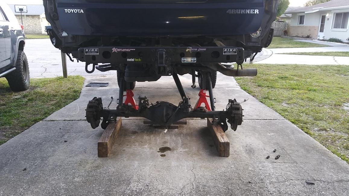

Rear end swap/FJ tank/14" bypasses
Well I just dove in the deep end.
Rear end swap: new/used one has 4:56 Nitro gears/Nitro axles-ARB locker. It also has legitimate bumps stop pads, tabs welded on for an Anti-Rock and the lower shock mounts will accommodate the welded rod ends for the bypasses.

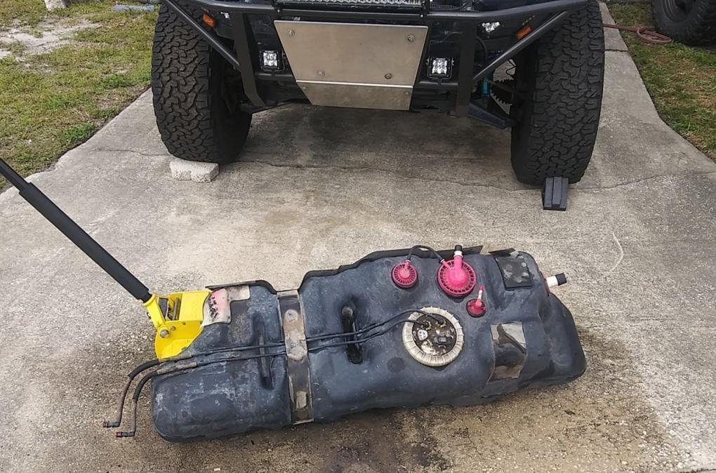

FJ tank is 19 gallons and shorter to accommodate more down travel.
Out with the old:
