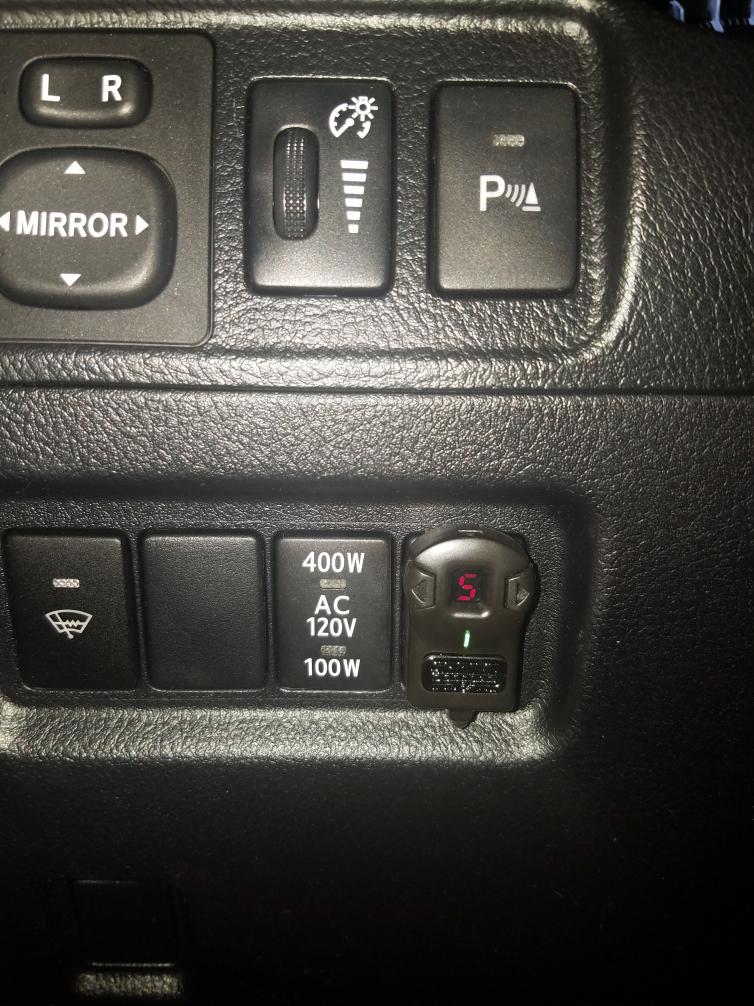

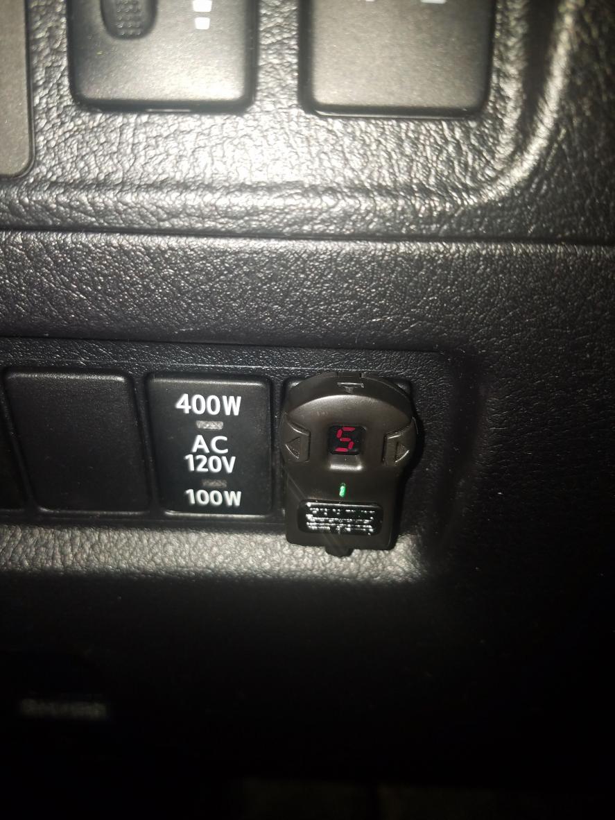

I went with the Sprint Booster due to the smaller sized control switch. It fits perfectly on just one of the empty switch tabs. Pics below...

I had to take the gas pedal off in order to depress the top wire harness clip. It's just two 10mm bolts and took maybe 90 seconds, but most people don't have to remove the pedal. Then I was able to remove the stock wire harness, plug in the Sprint Booster, then plug the stock harness back into the SB. Drilled one small hole matching the wire size just below the empty tab, fed the control switch up through the back of the tab, replaced the tab and secured the switch to the tab face with the included double sided tape. Zip-tie or tape up any extra control wire underneath, and done. The whole thing took maybe 15 minutes, and that was with removing the gas pedal. It's so easy, even I could do it...
